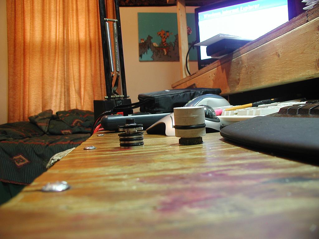

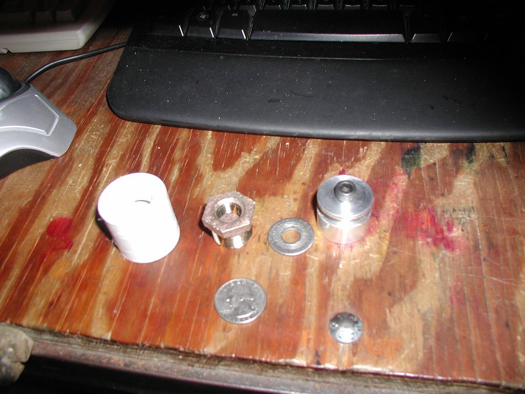

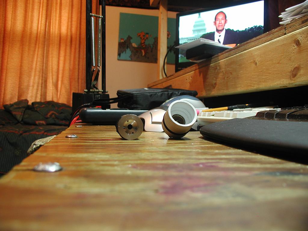

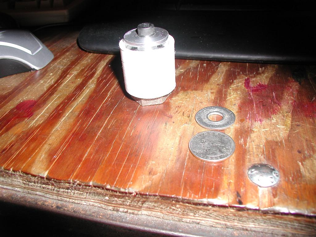

It ain't named yet, but here is the plug/cylinder combo, piston and brass reducer for piloting. :D

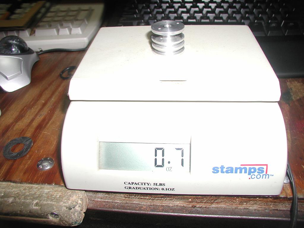

Good to see you're actually putting something together :) that piston is begging to be made slightly lighter... "groooove mee..." I can hear it!

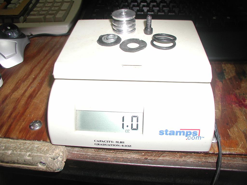

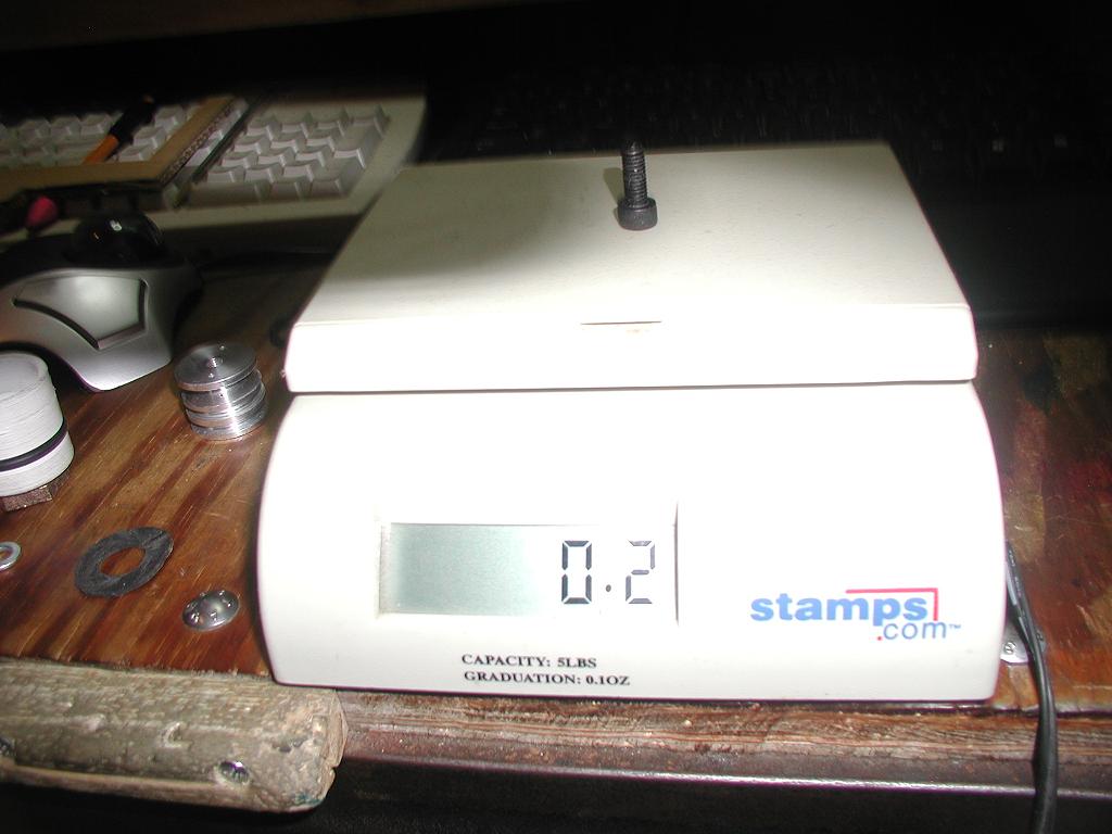

Ok, here is some weights...and 2 more pics. Check out the little EQ holes. :D

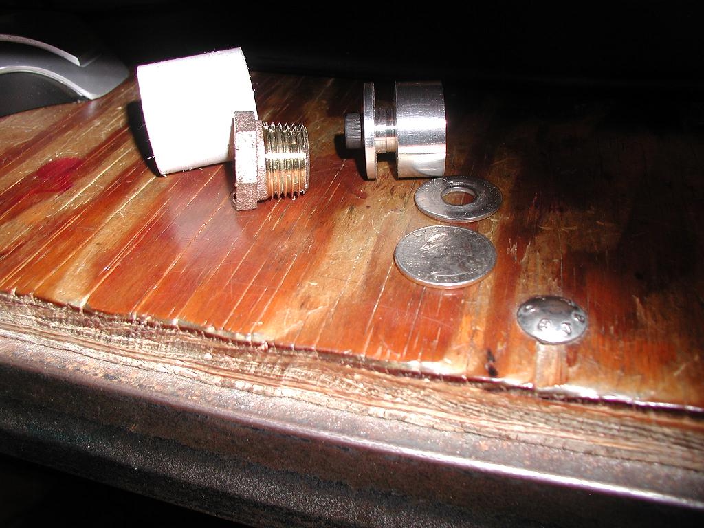

Trying not to spend extra money (if there is such a thing :roll: ) so I just used a piece of aluminum I had in the draw. So far I got about 10 dollars wrapped up into parts, most of that is PVC.

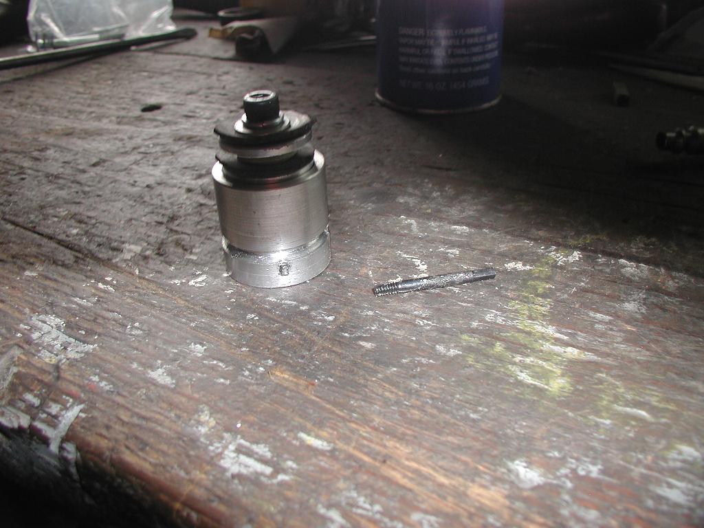

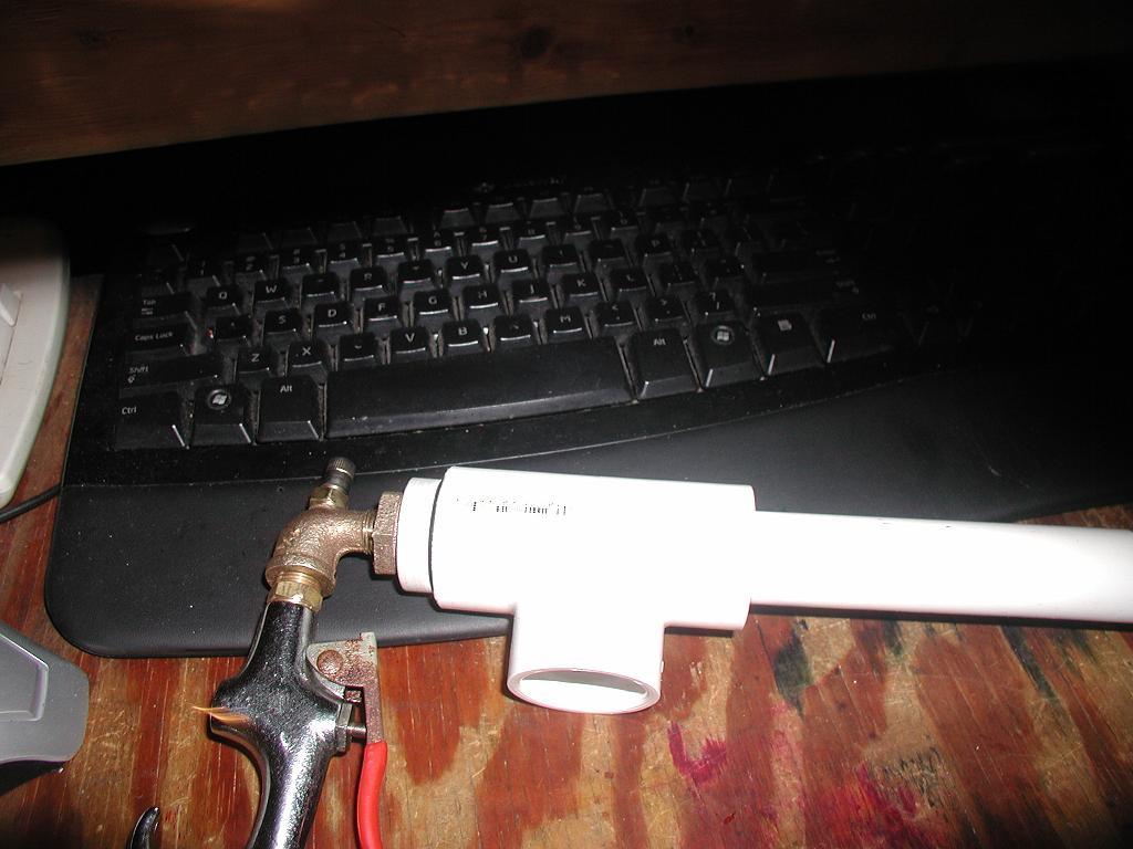

I found some time to drill and tap the brass elbow for the metal shrader valve. Just got to drill holes for the plug hold in screws then test fire...
Here's a pic of the fill and pilot assembly.

Well I'll give today's test a 50% success. Chamber held pressure, piston sealed until I pulled the tire inflator off the schrader valve. I could not for the life of me remove the air source fast enough to keep the schrader from piloting the cannon!
I just ordered a check valve from McMaster-Carr I'm hoping that will solve the issue. Another thing I want to change is the plug/cylinder. It works, but not reliable. Approximately every 5th 'fill and pop' the piston would not reseal because of tilting. So I'll make a plug/cylinder combo from aluminum.
