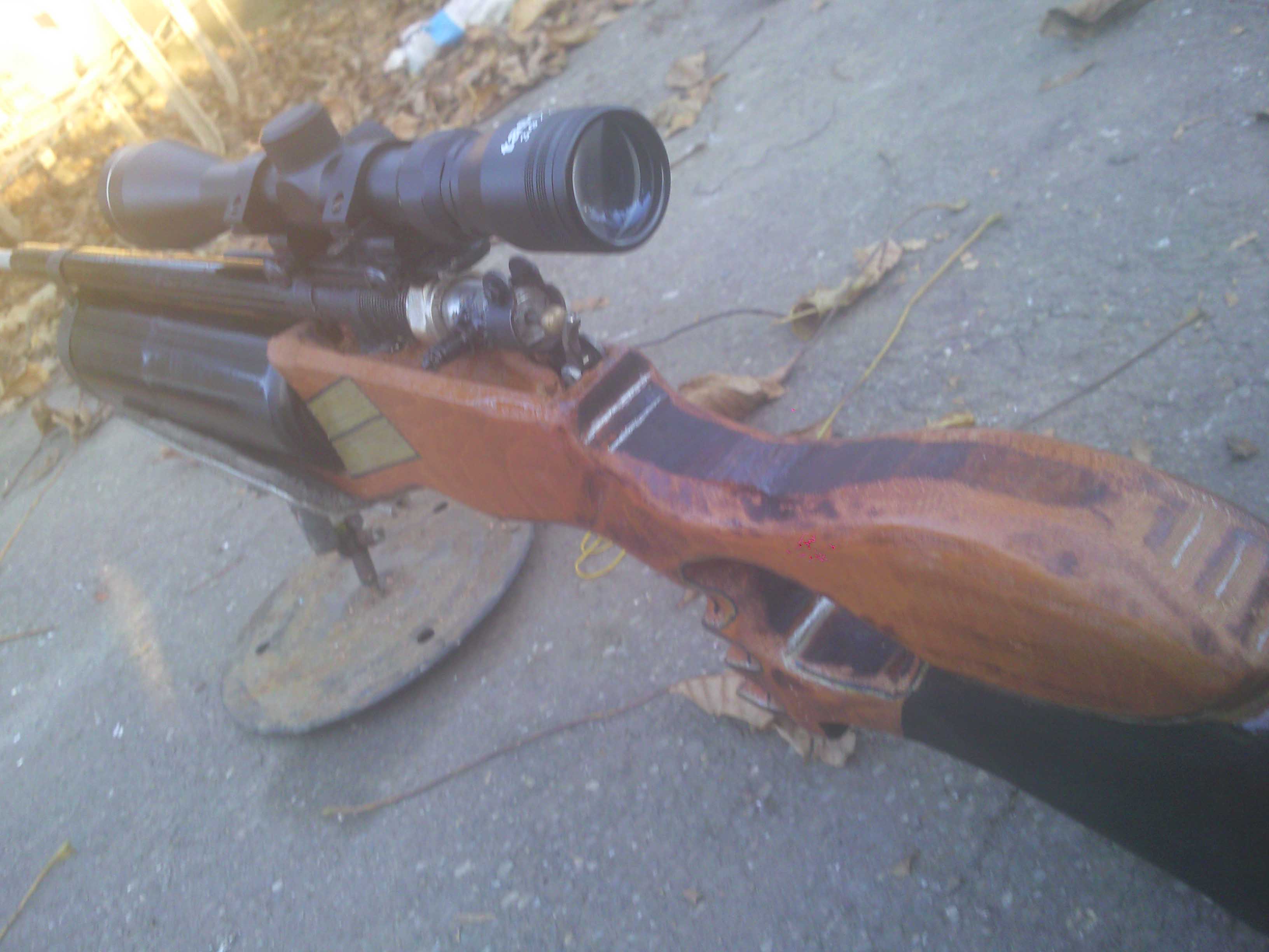

this is a picture with a new 6mm multi shoot QEV, bolt action that shoots bb's.
The problem is that when i shoot (over 15 bar) the boom sound comes with a vuvuzela sound- like inflated a ballon relised.
at about 20 25 bar the sound is only like a vuvuzela. If i set the 3rd valve to high power the gun works fine but i got too much power. i had replaced all the valves few times includig the piston( the piston works/slims correct). i had done everything right but i still have this sound...
the problem comes due the fact that the piston doesnt compres or decompres like it has to. it just stay there where it should close the air for period of time..... i could use my gun on a football game as a vuvuzela with no prob. :)
the problem was from the piston that( i dont know why) when moves backwards or fwd it blocks itself in the walls ( i suspect its from the spring that i put in the center) So i added another very hard spring( that has same diammeter as the piston in order to keep the piston straight when is in use, it seems now to work fine. anyway the new spring is too hard and i think it consumes some pressure to be compressed, but till i find one better i use this one.

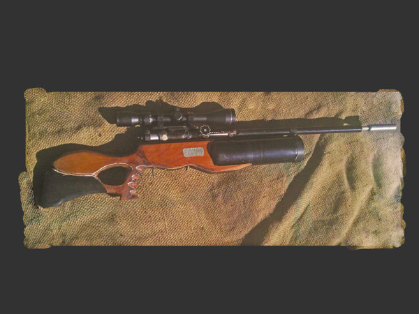

I saw your gun on youtube , very nice. That's perhaps the last picture wich is too much "clear".
bravootome
Romania
Posts: 334
s0ka wrote:I saw your gun on youtube , very nice. That's perhaps the last picture wich is too much "clear".
no, that one on youtube is another gun, this one i just finished and i didnt post it on youtube, but i will....

bravootome wrote:this is a picture with a new 6mm multi shoot QEV, bolt action that shoots bb's.
problem solved- i had put a grose rubber washer to the air tank. i changed to thinner one and now the gun works as it should. i almost finished 2000 bb's bag ......
atualy- not solved, it still does like that and drives me crazy. i
