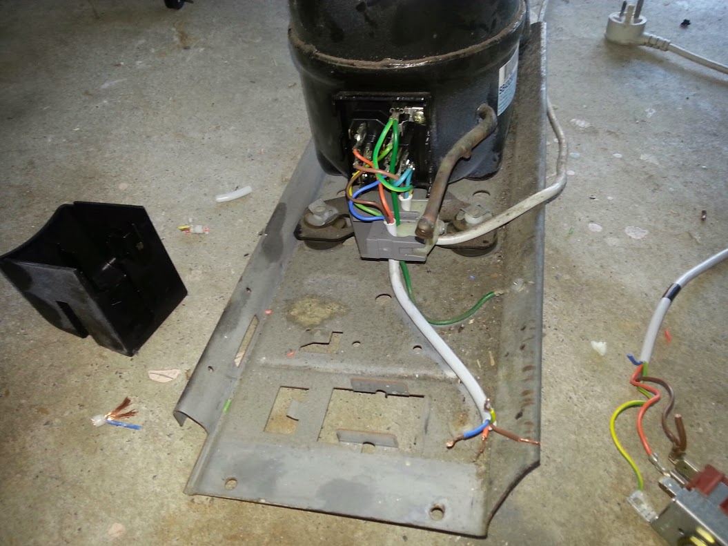

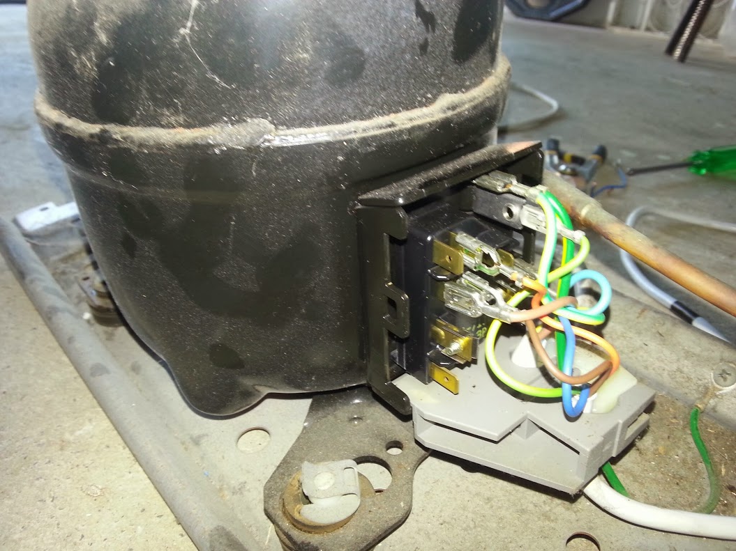

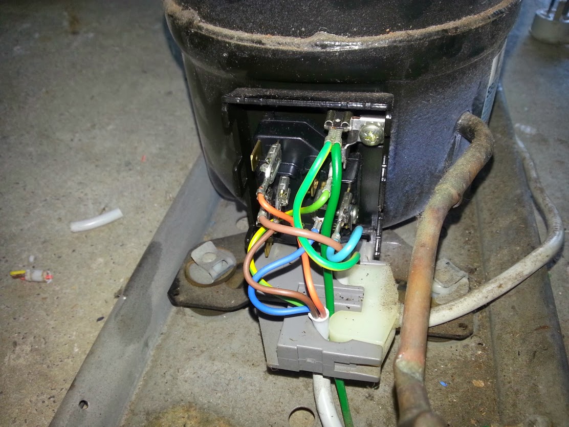

I just took apart an old fridge to use the compressor for an air compressor. The fridge does not have a capacitor, so i cannot follow similar threads on wiring. I was able to run the compressor in the fridge however cannot get it to run now its been taken out. I cut the power cord leading from the wiring harness to the thermostat and now have 4 wires however I do not know which ones to connect in order for the fridge compressor to run. I have tried wiring in the old thermostat however it still does not work, I think it may be because the temperature sensor has also been cut. I have attached photos so if anyone could shed some light as to what wires to connect it would be greatly appreciated. Thanks.

Everything is almost ready. The cable that was connected to the thermostat has 4 wires:
blue - neutral
brown - line (the two are for the light)
orange - this one activates the fridge - when you connect it with line it should start the compressor. You need an ON/OFF switch between orange and brown
green - ground
