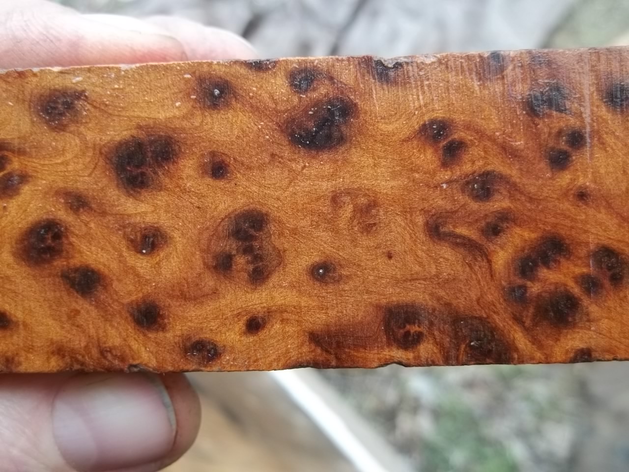

I have some stabilized burl (resin stabilized, I assume that's a 2 part resin). If you are using highly figured wood (often full of stress) like burl it's the way to go, but burl is not easy to carve with a blade and adding hard polymers throughout does not help. I just sand it to shape

Ok, by the way Anatine Duo, can you post an image of your stabilized burl piece?

first photo... I hope

That's pretty neat, though I like more colored stabilized wood, even though your does apparently have a brownish color, I really like a green, blue, red or a black too
