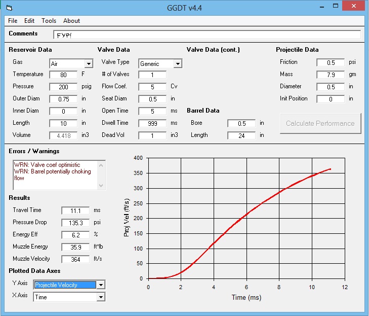

Here's a simulation at 200 psi with a 12mm bearing, 24 inch barrel and 10 inch long 0.75 inch diameter firing chamber:
There you're doing 36 ft lbs. If I up the pressure to 300 psi, GGDT predicts 52 ft lbs. Moar pressue = moar power, no two ways about it.
