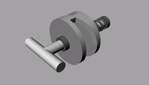

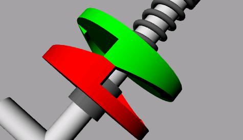

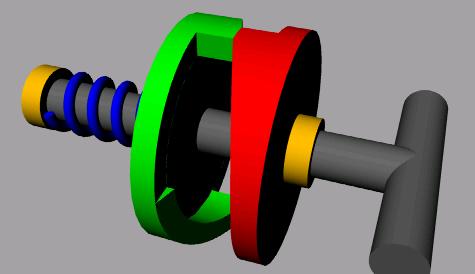

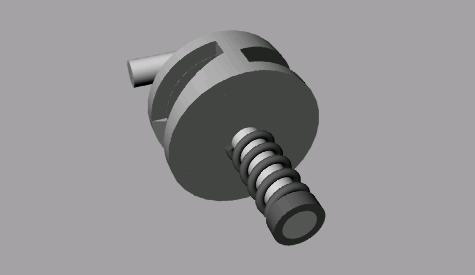

Ill try to keep all the explinations to the picture area, but a few things before I do. This concept could be used in both a 2-4 or whatever amount of barrels you want. The "teeth" on the mechanism will no doubt need to be higher since that wont load your projectile at there current short height. The bar running threw the center would connect to the one you have drawn, then the green "gear" would be connected to the chambers.
I like your posts and the time you spend on them, so I thought in return for your respect I would draw these up for you. Enough babbiling, here they are...
<img src="http://www.spudfiles.com/uploader/uploa ... veN-01.JPG">
Green= Gear connected to guns chambers
Red= Gear connected to shaft
Gold= shaft collars
Blue= Compression spring
Grey= Handle of that is rotated
<img src="http://www.spudfiles.com/uploader/uploa ... veN-02.JPG">

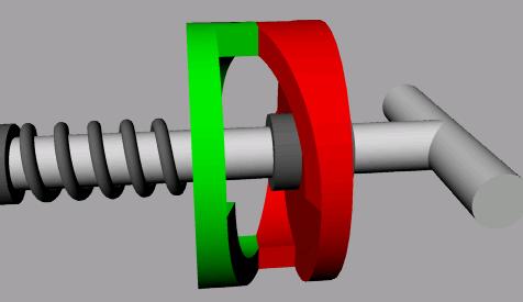

Since the gun shouldnt experience very much recoil occuring "side-to-side" the two faces sitting on each other should do.
<img src="http://www.spudfiles.com/uploader/uploa ... veN-06.JPG">
<img src="http://www.spudfiles.com/uploader/uploa ... veN-07.JPG">

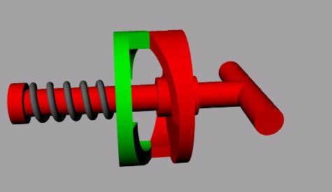

This is really only to show that everything is in a fixed postion except the green gear which is connected to the chambers
Basically, you guys get the idear'. I think I fed on the coloring, but O well anyone creative enough should be able to figure it out. Such a gun with chambers would be awesome.
