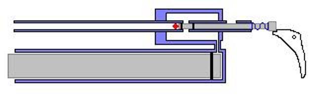

So i had an idea today for a coax pistol that has a single balanced spool valve that also acts as the loading bolt.
I attempted to design it as simple as possible, the bolt should snap all the way back to a stopper in the stock, allowing you to reload and push the bolt forward again.
Let me know what you think

That should work just fine, your pump needs a check valve though.

The intended build will most likely be a single stroke, cause single stroke is the bomb, obviously the scale is quite off.
I also just wanted to mention that the gap in the barrel (at the point the spool valve seals) is 4 small holes in the tube, not just a gap.

It can be a gap just make sure the projectile won't fall through it

In larger sizes the gap can allow the front o-ring to expand and go over the end resulting in launching the projectile and ring. Been there and done that. If it is above 1 inch and over 60 PSI, you will want a ported design to keep the o-ring in place. Looks like a breech loading QDV to me.
Please be aware when fired, the pressur in the front of the valve pushes the projectile with the same force it pushes the valve. You will want something robust to prevent shooting the valve into spectators behind you.
I had a failure on my ABS cannon and launched the valve into my foot once.
If you want a faster valve, search the forums for QDV valves. Making the spool small, light and free to slide on the trigger rod will make them open with air pressure much faster than it could be opened by hand. Check the links in my SIG for more info.

Not if you're expecting much in the way of power... what are your performance goals for this project?The intended build will most likely be a single stroke, cause single stroke is the bomb

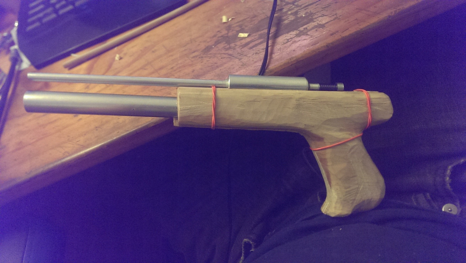

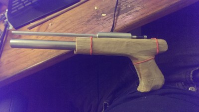

Hi all
A quick picture of what I've got so far.
Please ignore; The poor lighting, the rubber-bands, the messy desk, and my crotch.
Ps. i completely forgot to allow extra room at the back for the breech.. so this model will either be a muzzle loader, or i just might make the extra effort to sleeve and extend the back, and make a new longer spool valve
Pss. it might not appear so in this photo, but their is adequate wood behind the spool to act as a backstop.
Psss. i also should note that the chamber volume is much smaller then it appears, i have 2 double o-ringed aluminium plugs, sealing each end of the chamber, their quite long and take up the majority of chamber that you can see.

That's looking pretty nifty! Will you be finishing the wood?
Indeed i will be finishing the wood, perhaps even replacing it with something a bit nicer then pine. although i definitely want to keep the weight as low as possible, its probably under 250g currently.
Im having issues with sealing so far, i mostly attribute this to incorrectly sized o-rings on the valve, the smallest ones i have are too big, so i sanded them down on the lathe... i figured i should have floating o-rings, so i tried them on but it leaked like a cholera patients butt hole. no idea why... ill try and get some better photos this evening.
That was a mental image I could have done withoutTeflon wrote:i figured i should have floating o-rings, so i tried them on but it leaked like a cholera patients butt hole.

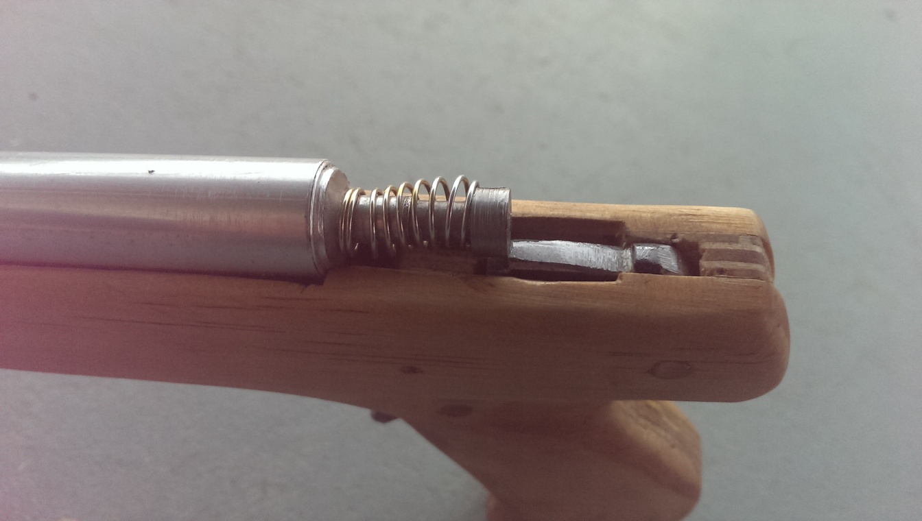

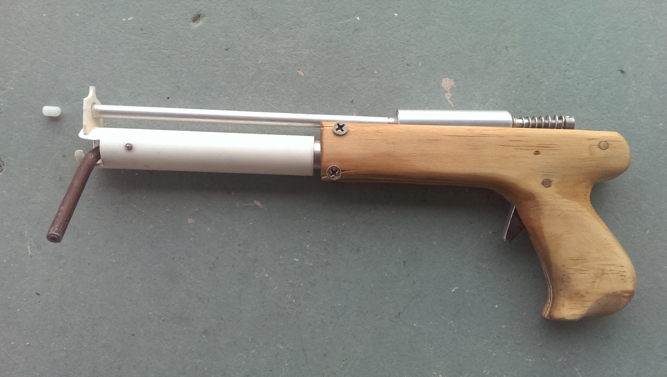

OK
So i managed to get it all sealing properly, found some suitable o-rings.
got it all cleaned up and shes shooting very nicely indeed, quite a bit more power then i had anticipated.
i sure as hell wouldn't want to be hit with this thing.
