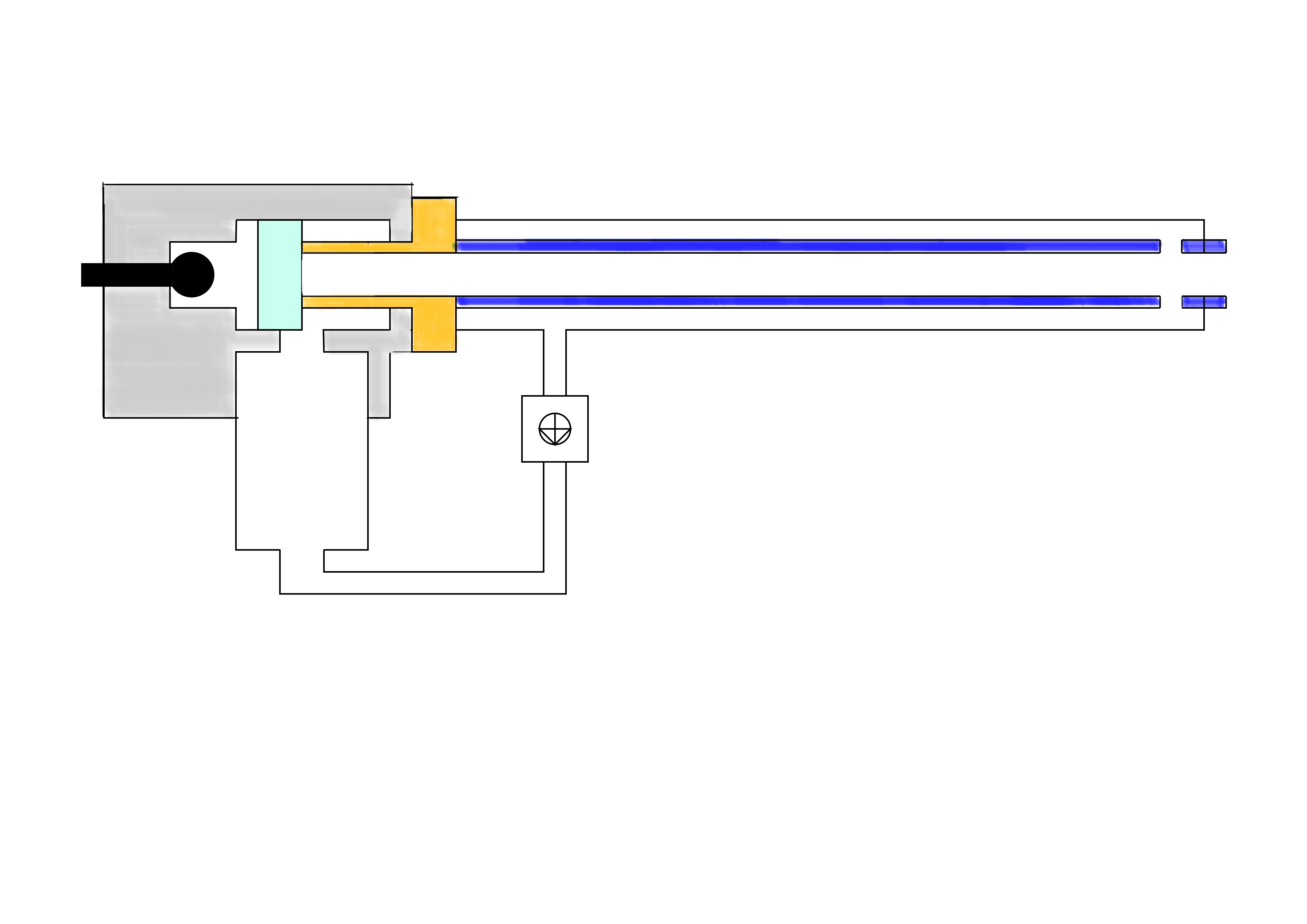

I had a random idea the other day while fiddling around with the shroud / silencer on my gun.
Basically what I am thinking is:
The air to charge the qev gets drawn from the inside of the perfectly sealed barrel shroud while the end of the [ported] barrel is blocked with a piece of tape (don't worry pictures below).
If you had a pump that was capable of drawing a close to a proper vacuum you could set up a situation where the QEV acted as the rear burst disk like on one of those burst disk vacuum cannons except it also added bucket loads of pressure behind the projectile.
In my imagination this would allow super fast acceleration of the ammunition as there would be minimal resistance to acceleration and because the shroud would act as a vacuum reservoir there would be minimal deceleration towards the end of the barrel and very minimal noise...
I've attached a diagram detailing what I'm talking about
This would have the advantage of being:
Easier to operate than a normal two burst disk vacuum set up - no need for disassembly or anything between shots.
More acceleration than the normal two burst disk set up - as pressure is added (above atmosphere) behind projectile as well as vacuum in front.
Quieter overall as air that pushes round is drawn into the low pressure environment of the shroud.
Could be used as just a standard qev driven air gun without the tape over the barrel burst disk.
BUT....
This all seems too simple and I'm sure that there must be some great gaping gap in my logic somewhere otherwise I feel like this would have been done already.
I need you guys to have a look at the diagram and point out the what I have missed before I attempt this one but if it looks viable I will have a bash at putting together a test rig (will probably take me 100 years to make it work knowing my style.
Factors to consider:
QEV barrel seating face vs uncovered face area - I imagine due to the low pressure in the barrel before firing more surface area will need to be exposed on the piston face. i.e. a 3/4 inch qev running .177 sealing face... probably overkill but I don't know.
Add more ideas here...
Thanks guys!

I was watching a show on tv about a month ago and some collage students built just about what you described in the 1st part of your post. They were shooting ping pong balls through the paddles at about 6"s away. It was awesome!
I guess the difference is that they are using two burst disks (requires pulling the whole thing apart between shots, and high volumes of air. The thing I outlined above uses only one (on the barrel end) and the QEV takes the place of the other one.
But I'm not sure that it would actually work because the force on the QEV piston may be a factor that prevents opening?

There's nothing new about pulling a vacuum on the barrel of an air gun....even a QEV powered air gun. It works for pretty much any gun wherein the mass of the air in the barrel is a significant compared to the mass of the projectile. That is to say that if Mair/Mproj > 0.1ish, you're going to see significant improvements. The bigger that number, the bigger the improvements, obviously.
Note for supersonic guns its pretty simple to get a very close estimate of what the vacuum-assisted velocity is. Just treat muzzle energy as a constant and do the math with and without additional mass in the barrel.
With all that said... Never heard of a vacuum pulled on a supressor before. That's a decidedly interesting idea!

Right I see!! thats why I don't get huge improvements in power using a 2g projectile in such a short barrel, the mass of air in the barrel would only be about 2.4 - 3mg I think.
I guess greater improvements could be seen with a longer barrel and a lighter projectile like a 0.2g plastic airsoft pellet.
The whole idea with pulling the vacuum into the ported barrel shroud was to make sure that any air that leaked past the projectile while in the barrel wasn't slowing it down towards the end of the barrel towards the burst disk and I had hoped it would also make the shot way quieter but the second part wasn't really noticeable. I'll report back after the larger rig with increased shroud volume is made though.
(It was also super easy to manufacture by just mounting a barrel in a galvanised tube with a "T fitting" on it, one part of the T was the vacuum hose attachment and the other housed the barrel sealing part).

Having a bit more time to elaborate at the moment. OK, suppose....
Projectile Mass (Mp) = 1 kg.
Air Mass in barrel (Ma) = 0.1kg.
Muzzle velocity measured (Va) = 100 m/s.
Muzzle Energy is often stated to be 1/2 * Mp * Va^2. This is, however, inaccurate. While it's the energy you're interested in if you're worried about how far your projectile goes or how hard it hits, it is NOT the energy delivered by the gun. After all, the gun had to push all the air in the barrel out of the barrel too. That air was moving (more or less) at the same speed of the projectile. As such, your ACTUAL muzzle energy is...
0.5 * (Mp + Ma) * Va^2 = Energy
OK, great. So what if we pulled a vacuum on the barrel but kept everything else constant? What would the muzzle velocity in a "vacuum shot" (Vv) be? Well, the energy available to your gun really hasn't changed. As a result, your actual muzzle energy is going to stay pretty constant. So....
0.5 * (Mp + Ma) * Va^2 = Energy = 0.5 * Mp * Vv^2
Simplifying and rearranging we get....
Vv = sqrt(((Mp + Ma)/Mp) * Va^2)
Using our example numbers.... sqrt(1.1*100^2) = 105 m/s.
Not a huge difference, but significant (5% increase). However, as stated previously, the bigger the ratio of Ma/Mp, the large the difference it will make.
Note: I'm assuming no issues with choked flow or the like. Still for a lot of system I play with as part of my day job, this quick and dirty does a remarkable job.

Wow that's a great explanation - thank you!
Running the calculations for my theoretical 0.2g at 100m/sec in a 1000mm x 16mm barrel gives me
or
0.5 x (0.0002 + 0.00003) x 10000 = 2.5
and with vacuum in barrel
Vv = sqrt(((0.0002 + 0.0003)/0.0002) * 10000) = 158m/sec (minus any diminishing returns encountered)
thus: 0.5x(0.0002+0.0003)x 158^2 = 6.24 249% energy increase
Verses the 2g steel ball where
0.5 x (0.002 + 0.0003) x 10000 = 11.5
Vv = sqrt(((0.002 + 0.0003)/0.002) * 10000) = 107.23m/sec
thus:
0.5 x (0.002 + 0.0003) x 11498 = 13.2 114% energy
I know this makes some broad assumptions but it gives a ball park for better visualisation of the possibilities.
Edit: Bad maths x 10000000000000 times but the principal stands.
