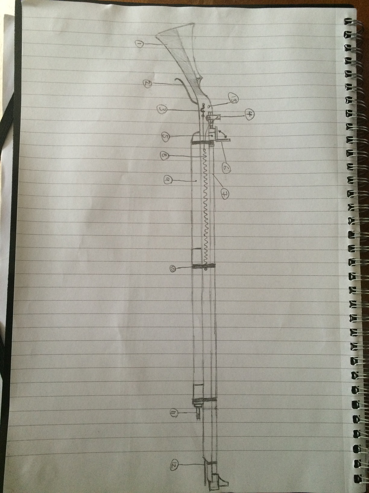

So this is my first serious project. Basically, I plan on making an all steel/brass spring-loaded ball valve actuated QEV gun this summer. My goal is to be able to reach 200+ ft-lbs with .495 lead roundballs and/or fully penetrate a pine 2X4 at 600 psi, although I worry about needing an obscene barrel length.
I've attached a quick sketch of my plans below, as well as a GDDT file for anyone who's curious. The numbered labels indicate the following:
1 - Stock
2 - Crossbow style trigger
3 - Hook
4 - 1/2" ball valve
5 – 3/4” QEV (I’m thinking one from Alpha Technologies)
6 – Door latch (used as a crude ladder sight)
7 – 1/2” type K or L copper barrel (approx. 50” long)
8 – Strong spring
9 – 3/4” galvanised steel air chamber (approx. 40” long)
10 – Hose clamps (my readily available “barrel bands”
11 – Fill valve, Schrader (will add a smaller BV in front to allow topping up with my 600 psi shock pump after I reach 350 psi with my bicycle pump)
12 – Ramrod housing
13 – Exhaust port
I’m still sourcing all of my parts, although I have most already and know what I need to get to achieve the desired result (except for maybe a decent QEV that I know will handle 600 psi and offer a good flow coefficient).
What I would like is some feedback on my design from some the experts. I would love to know how it can be improved. Also, I was wondering if there were some tips and tricks for working the metal of the ball valve handle with limited tools/resources. At the very least, I would like to add a nice backward curve, to make it more aesthetically pleasing and aid in opening times. I know my stock is ambitious, but I’ve found some good tutorials on that on this site, so I’m fairly confident about that.

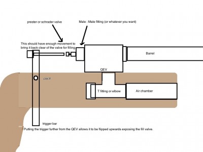

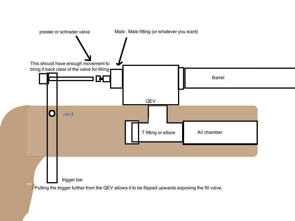

Edit: Here is a really crap diagram drawn in a shoddy mac version of paint.
I should probably point out that this is not even vaguely to scale... you would need to workout your chamber size etc in GGDT or just wing it or whatever.
