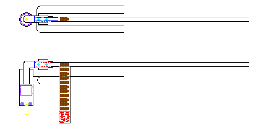

alright. So i went to handy dandy paint and drew something up.
This would b using copper pipe of various sizes. It has a split chamber, which could be used to hold the clip steady. The main thing to this is the blue bolt. To allow air through, it must be pushed forward to the wider area, air then can flow through the holes in it (light blue). The bolt sliding forward makes sure only one projectile is engaged, and then is returned wen the air escapes by a spring (red) of some sort (i haven't worked out the math yet to know how strong of spring).
The clip is quite simple, just a hollow rectangle, a weak spring (red again) and a little platform (green) for the ammo.
The ammo is just kina a picture to take up space, as of right now im leaning towards a blowgun type dart. Not the ones at stores that are a stick and a plastic thing, but something heavier with yarn/string on the end
The piston will most likely be cast out of resin or epoxy, as i do not have access to a lathe until school starts again. O rings and some sort of rubber on the front will keep it sealed (both grey). The chamber is filled with co2 through the yellow/gold fitting (either a male quick disconnect, a hose barb, or a steel braided line threaded in)
As you can see, the co2 setup is not pictured, just because I'm too lazy.
Im open to any comments/questions/criticism/suggestions
- top and side view of gun.
- semi auto 2.GIF (5.3 KiB) Viewed 3946 times

round spherical ammo is going to be easier to make a feed mechanism for.
go with 1/2 inch copper, 14mm marbles, and a peice of craft foam superglued into the breech end of your barrel, about 2 inches long to act as a hop-up.
and sharpshooter, there are easier ways to make a blow-foward bolt.
Ill get around to posting one eventually.
