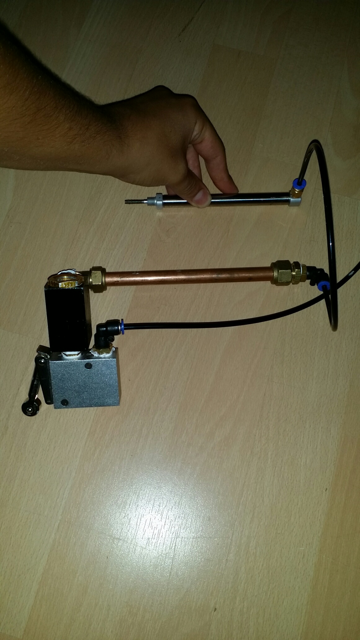

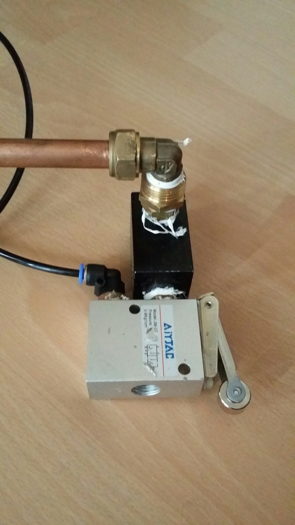

So i didn't really have time to make any progress. I did work a little bit at it though. I used a 12 mm copper pipe and drilled two holes in it. one for the ammo and one for the air(the last one being a bit smaller ofcourse). over that i slided 2x 15 mm T-fittings(with some modified other fittings to make it a smooth fit) to attach the magazine and QEv.
but now when i try to shoot with it it doesn't work. luckily i know why but i just dont really know how to fix it. when i recharge the air chamber and at the same time the air cylinder, the air cylinder creates such a high velocity that the ball drops out in front of the barrel. :? :?
So i need something to make either the action of the air cylinder go slower or i need something to stop/slow the ball just before the air releases, to stop it from shooting out of the barrel.
i hope someone has encountered the same problem and knows a genius solution. :idea: :D :D
I was thinking about maybe adding a speed control valve to make the action of the cylinder go slower. Could that be a idea that would work?

BramR wrote:i need something to stop/slow the ball just before the air releases, to stop it from shooting out of the barrel.
Have you thought of a detent? Spring loaded ball detent are available as pre-made parts that you can just screw in:
That could work indeed. i'll check it out. Thanks!! :D
