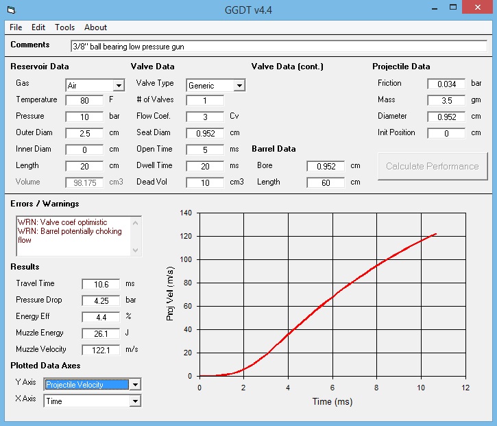

Here is a simulation of what performance you would get at 10 bar with a 60cm long barrel, you'd get just over 25 joules of energy and decent velocity, good enough for 150 feet.

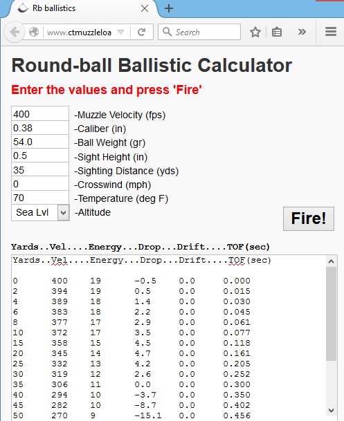

Here's a ballistic calculation, look at those numbers and decide whether that is enough performance:
At 50 yards, bullet drop from 35 yards is about 15 inches, and energy drops from 19 ft lbs at the muzzle to 9 ft lbs - still significant but less than half than at point blank range.

thank you for the software workout ! i believe i might pump a little more pressure and move up to 15 ore 18 Bar. i think tis wil effect the curve a bit ..
I wil download the software and try to understand what i am doing .

I used this online calculator for external ballistics.

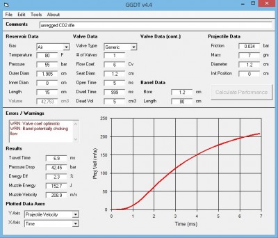

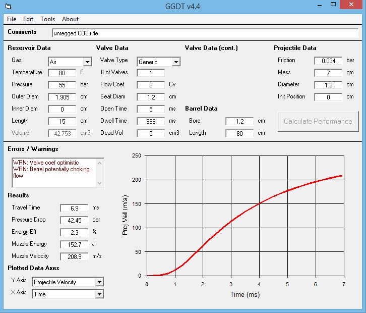

A very efficient valve type that would be able to take the pressure of unregulated CO2 cheaply and would give you tons of performance at low pressure. Here's a simulation with a 12mm bearing, you'd have the muzzle energy of a .22LR rimfire rifle...

thank you again for your compete answer.. most of what you say makes sense to me ,, some of it i must dive in and do my homework .. 10 ore 12 mm is not an issue for me .. hey lets go for 12 mm ..
I can work with that ! I have no idea how to reach 55 bar though .. ! i am hoping to pump 11 with my high quality bike pump . and i have a fork pump that will go until 30 bar .. but thats it ..

Ah, I assumed when you said 12oz that you were going to run it on CO2! If you're pumping yourself then 11 bar is just fine and you don't need a regulator, through you will be pumping it for every shot.I can work with that ! I have no idea how to reach 55 bar though .. ! i am hoping to pump 11 with my high quality bike pump . and i have a fork pump that will go until 30 bar .. but thats it ..
