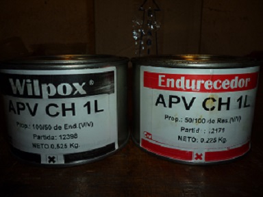

I'm not sure I understand well by the language.farcticox1 wrote:now you got me thinking
Any specific type of resin, I guess it must be pretty free flowing
I imagine you want to know what resin I use for this.
I have built this with this epoxy resin, the one in the photo. I have also built them with polyester resin, and I have had no problems. Logically they are of smooth soul.

hectmarr wrote:I'm not sure I understand well by the language.farcticox1 wrote:now you got me thinking

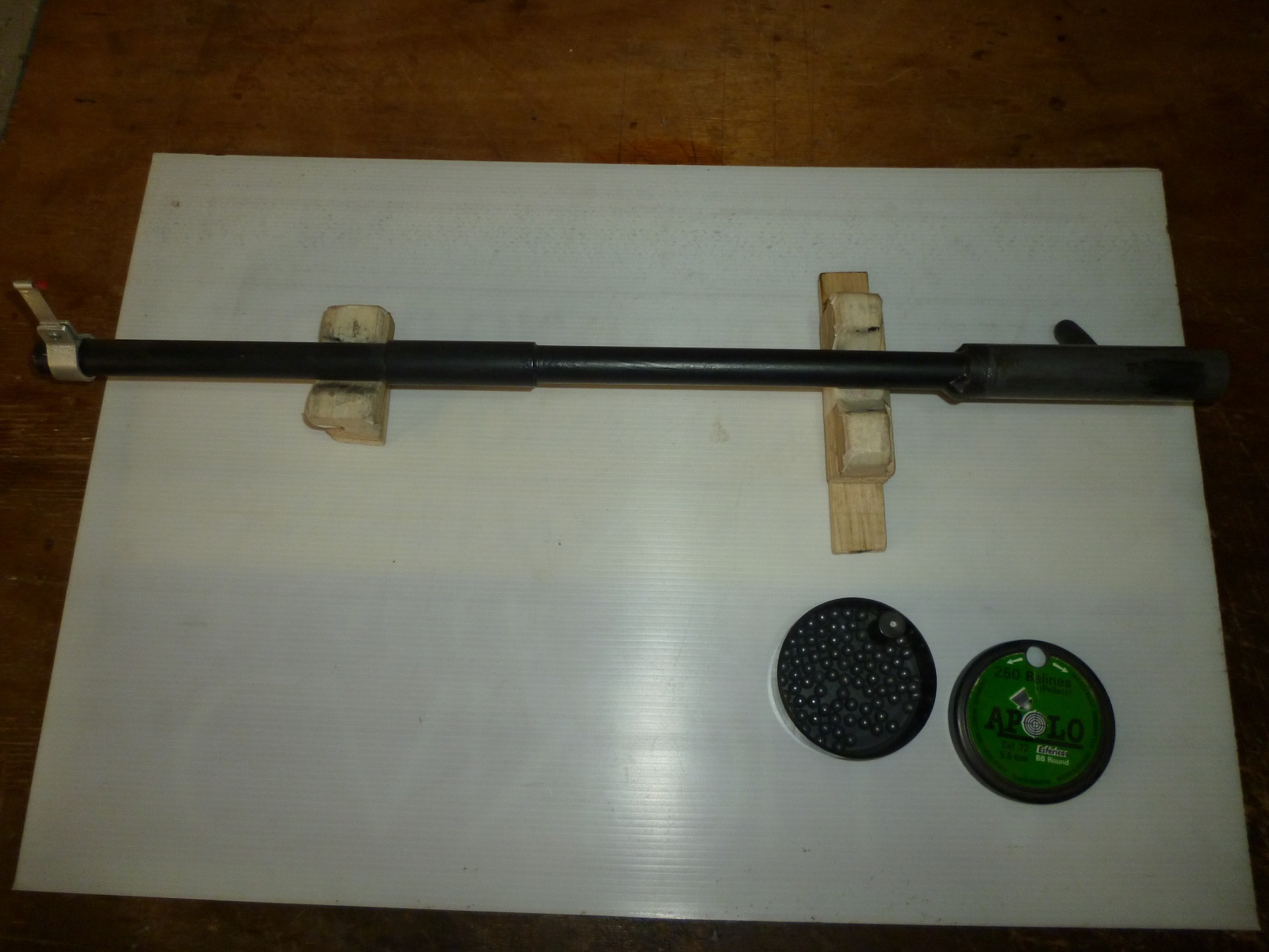

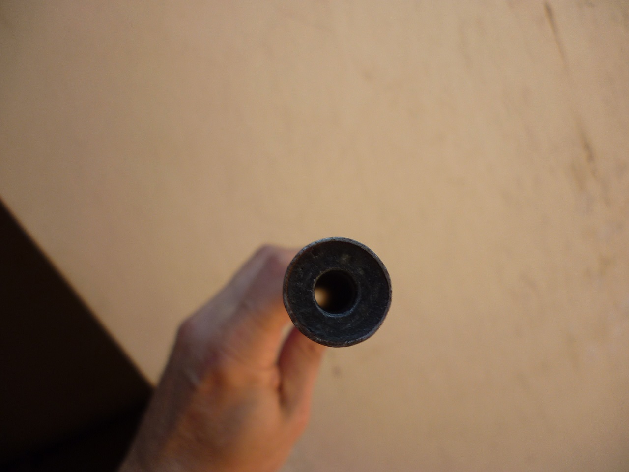

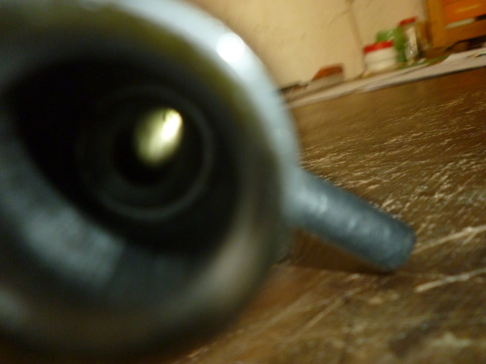

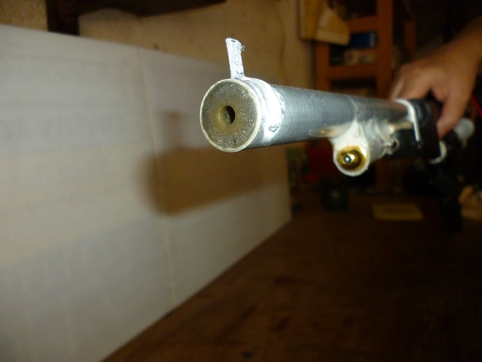

My procedure is to paint with a soft pencil the rod that gives the size of the caliber of the barrel. When the rod comes out, that was when introducing it of bright black color, by the graphite, it leaves without anything of this. Everything has stuck to the resin on the inside surface where the ammunition passes. The adjustment is intermediate, neither very olgado nor very fair. Ammunition does not fall by itself due to gravity. The rod that I use are plastic and hollow, Inside I install a carbon rod to leave it completely. The outer tube, which contains the resin, is 5/8 "structural pipe, sanded inside and degreased so that the resin sticks perfectly.
This photo is from the small hybrid prototype 1 cannon that has already shot more than a thousand times, about 4 boxes of .22 spherical lead ammunition and it is perfect. This cannon is united because it was short.
In prototype 2, the one with the loading system, of the last video that I published, has already shot 6X 682 times, and it is perfectly fine. I have not uploaded photos of this canyon because it is armed and I am using it at this time.
Well, I wanted to explain to you how I did it.
