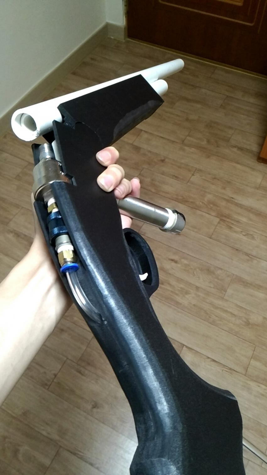

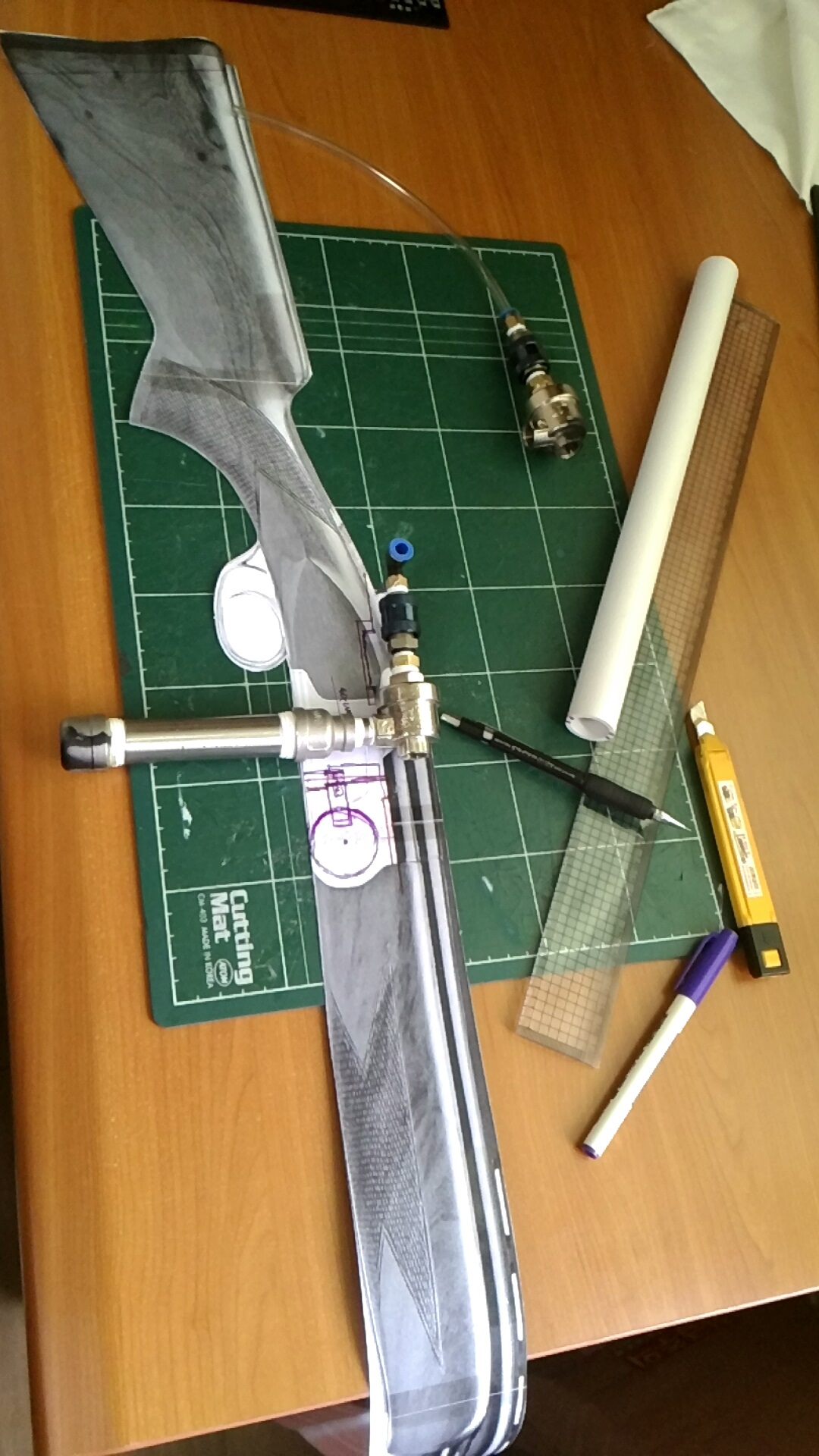

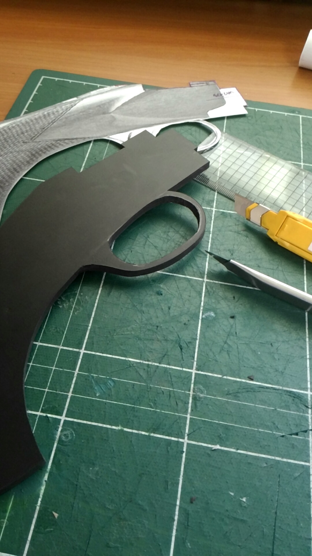

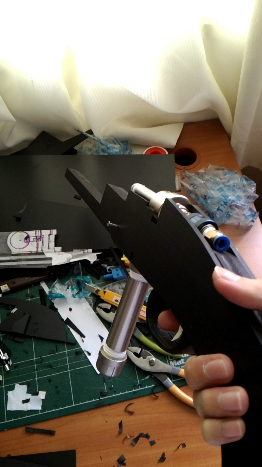

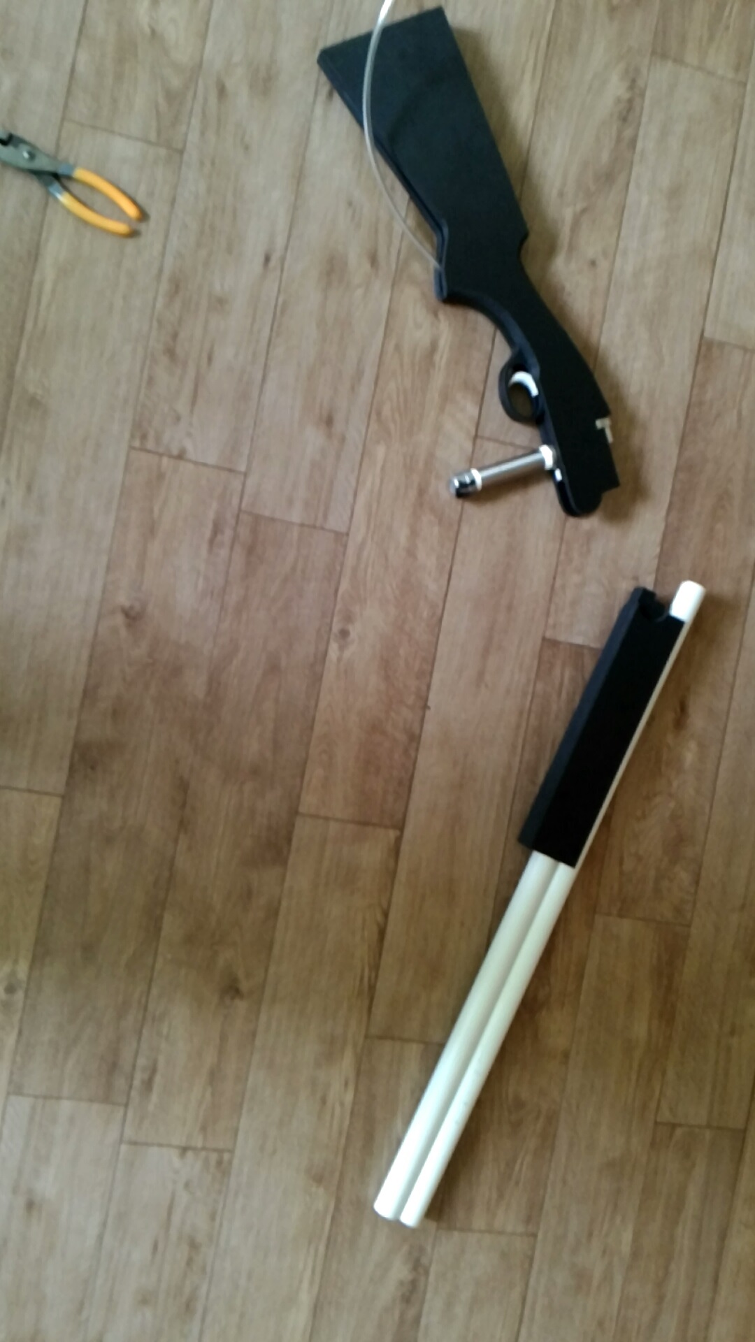

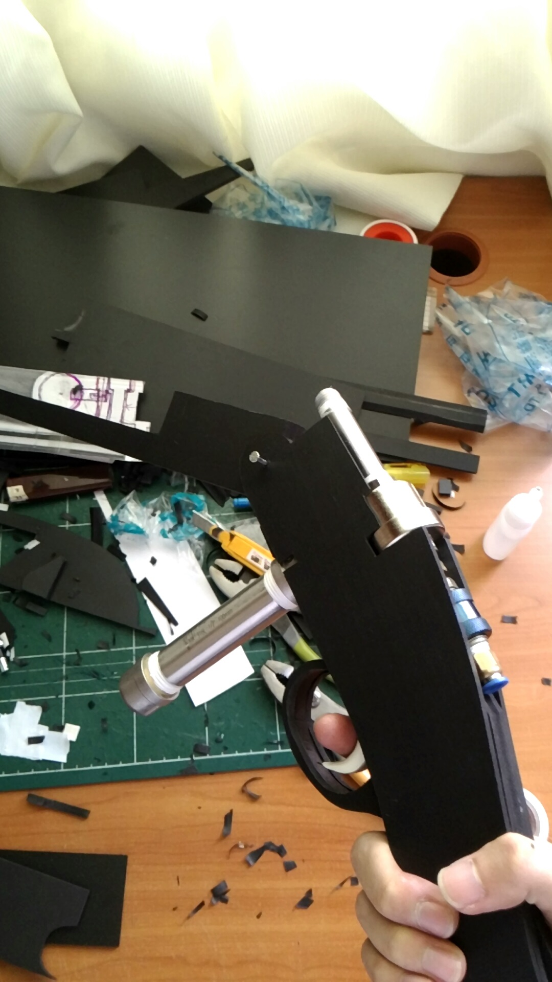

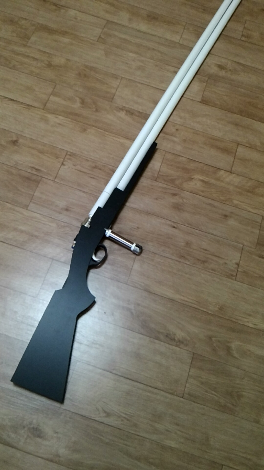

Hi guys
New project is progress, When I think about what I made so far,
I think that the method of loading one shot and reloading is common, and this time,
I made a break action shotgun which is the best way to load those shot.
Hope you enjoy this project ;)

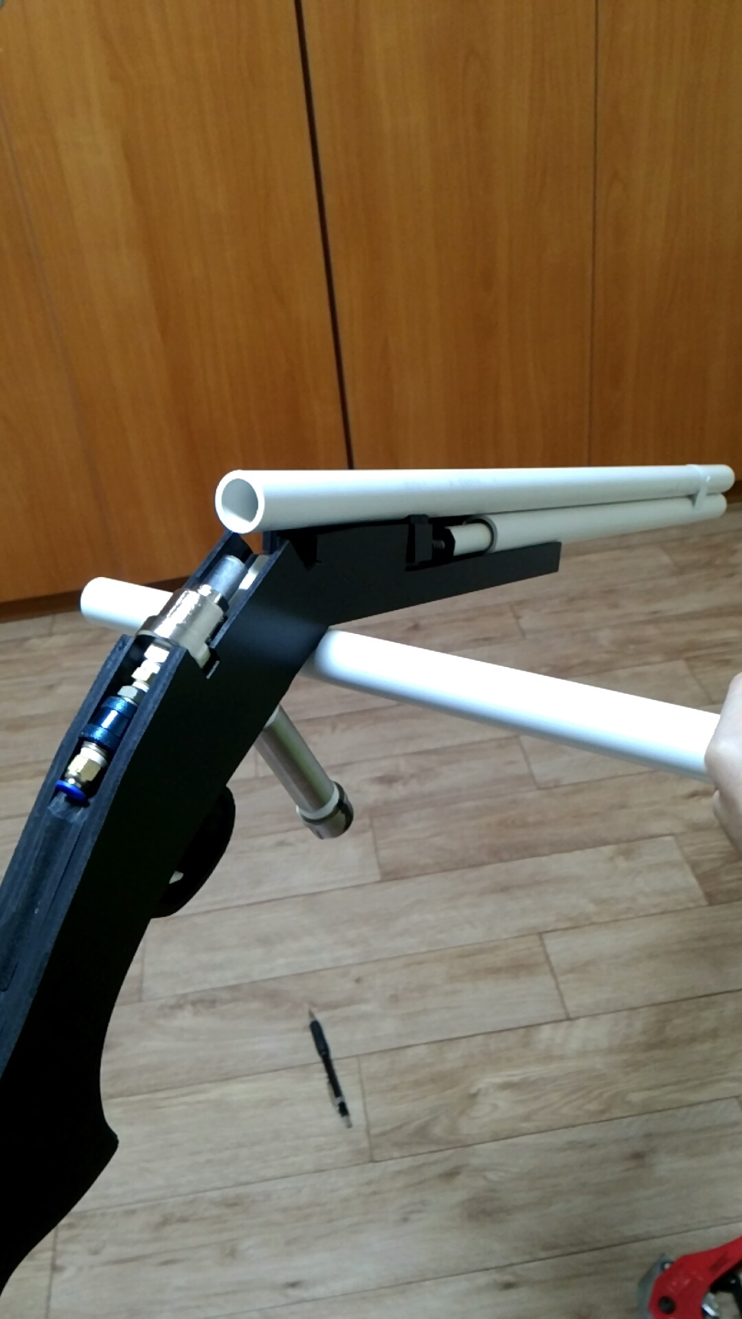

What you need
8A QEV
6A slide valve

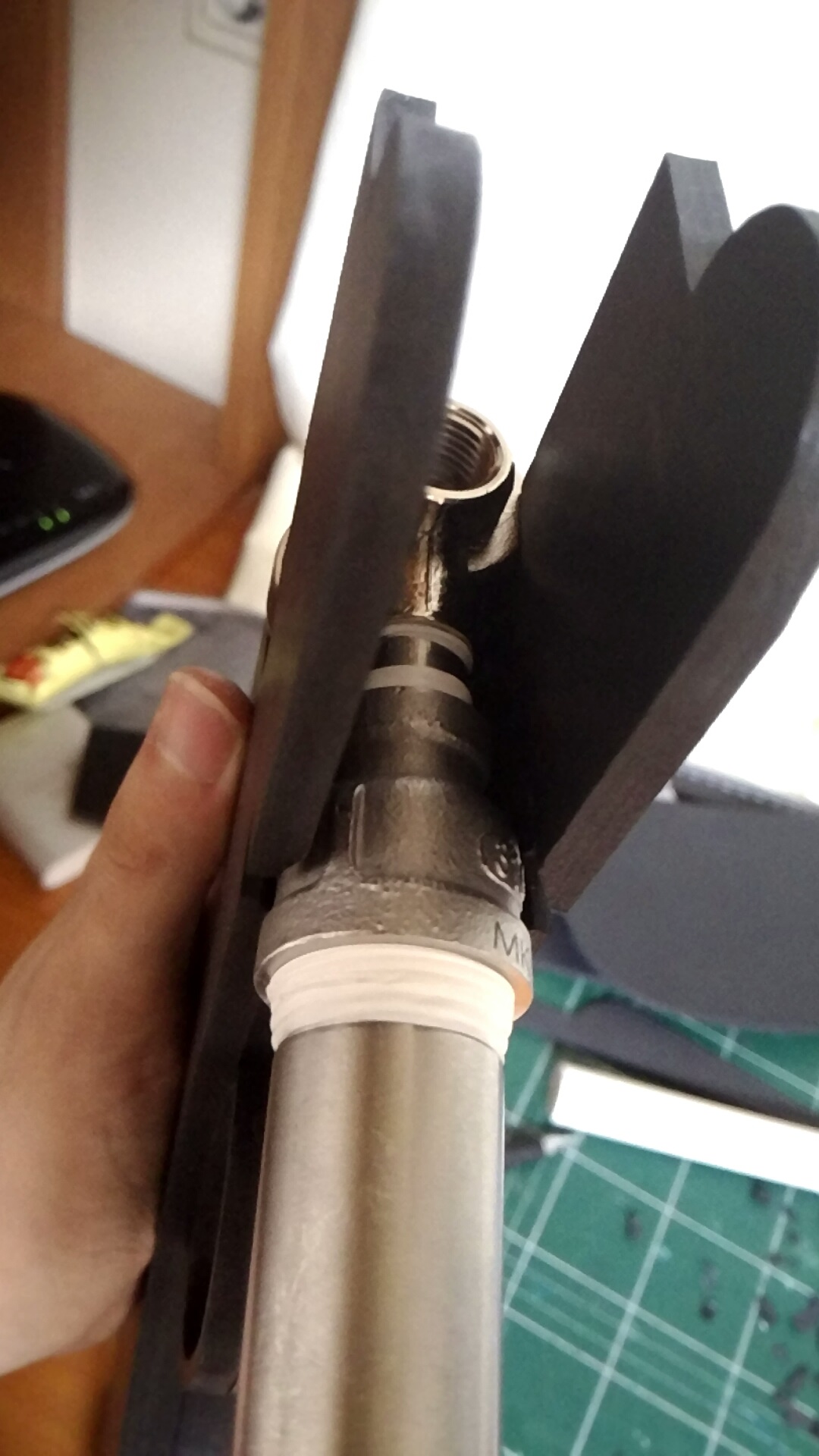

6mm tube, some one-touch valve,
I connect pipe-QEV with 8A short-threaded pipe(I don't know what actually its called. sorry :( )
use 20A and 13A PVC pipe for barrel
stock are made by fomex(포맥스 in Korean)
power source is CO2, But it is not regulated and it is directly connected, so I have to shoot, lock, shoot and lock...
but its power is enough to me. almost 120psi/shot
It is not finished, Work is still in progress.

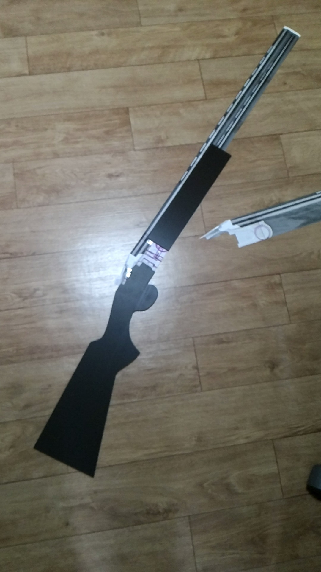

videos here!
https://youtu.be/718GgTcqYb0
https://youtu.be/d5e05Bvl9zE

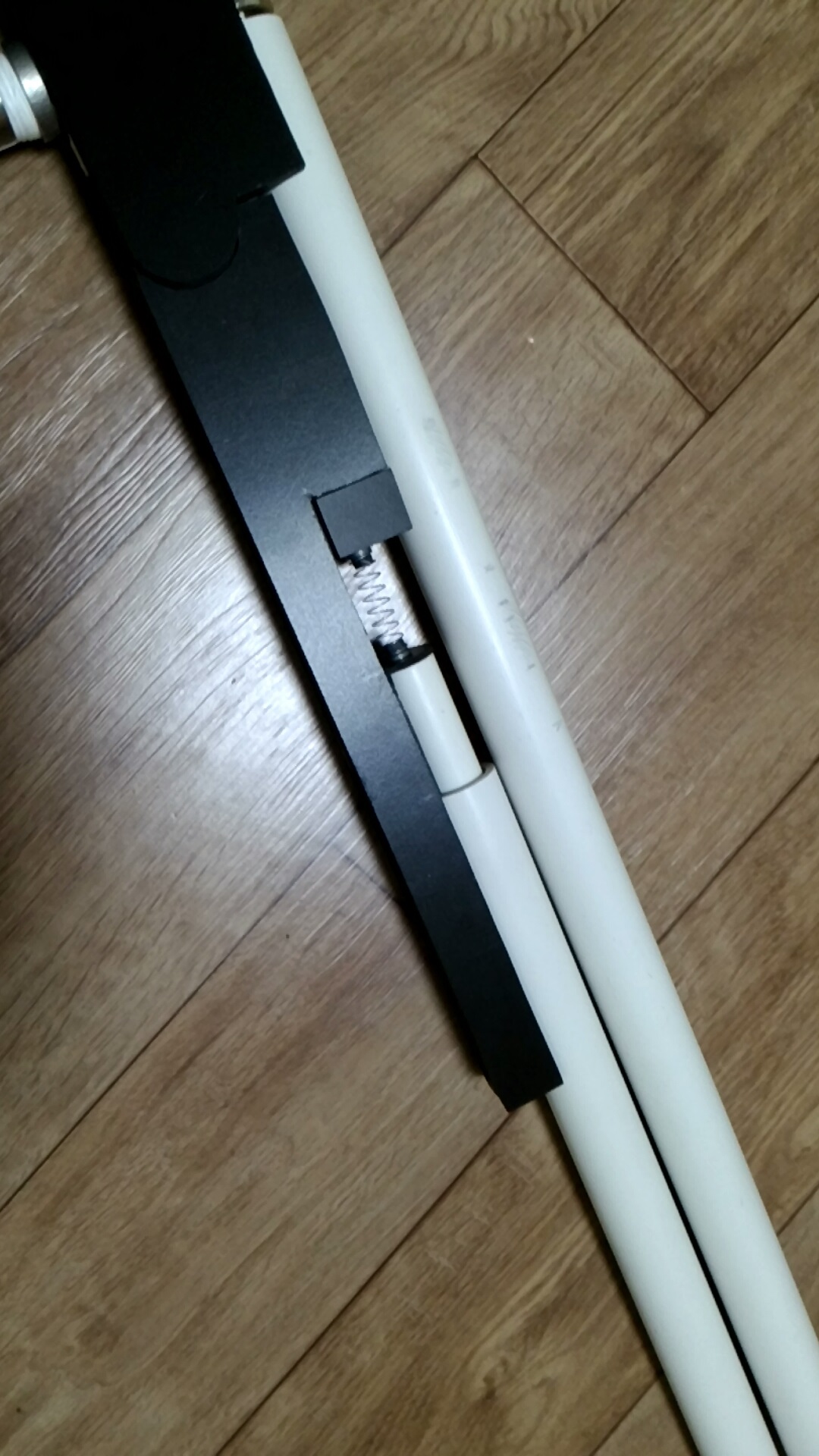

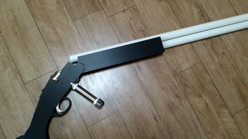

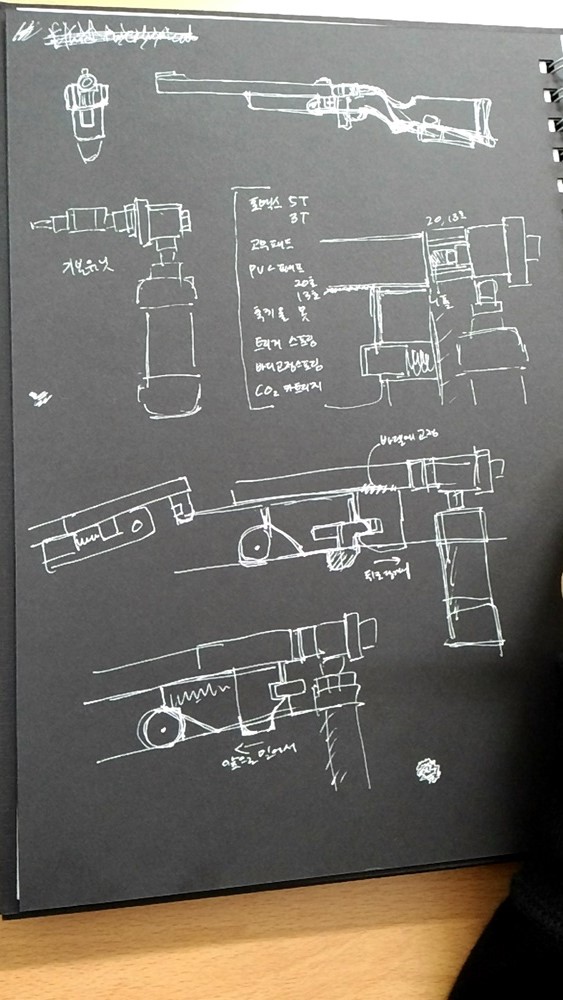

This mechanism is designed for break action.
Since the QEV unit could not fit the structure of the "REAL" shotgun, so I made it to fit the barrel.
I am sure that this mechanism is successful.

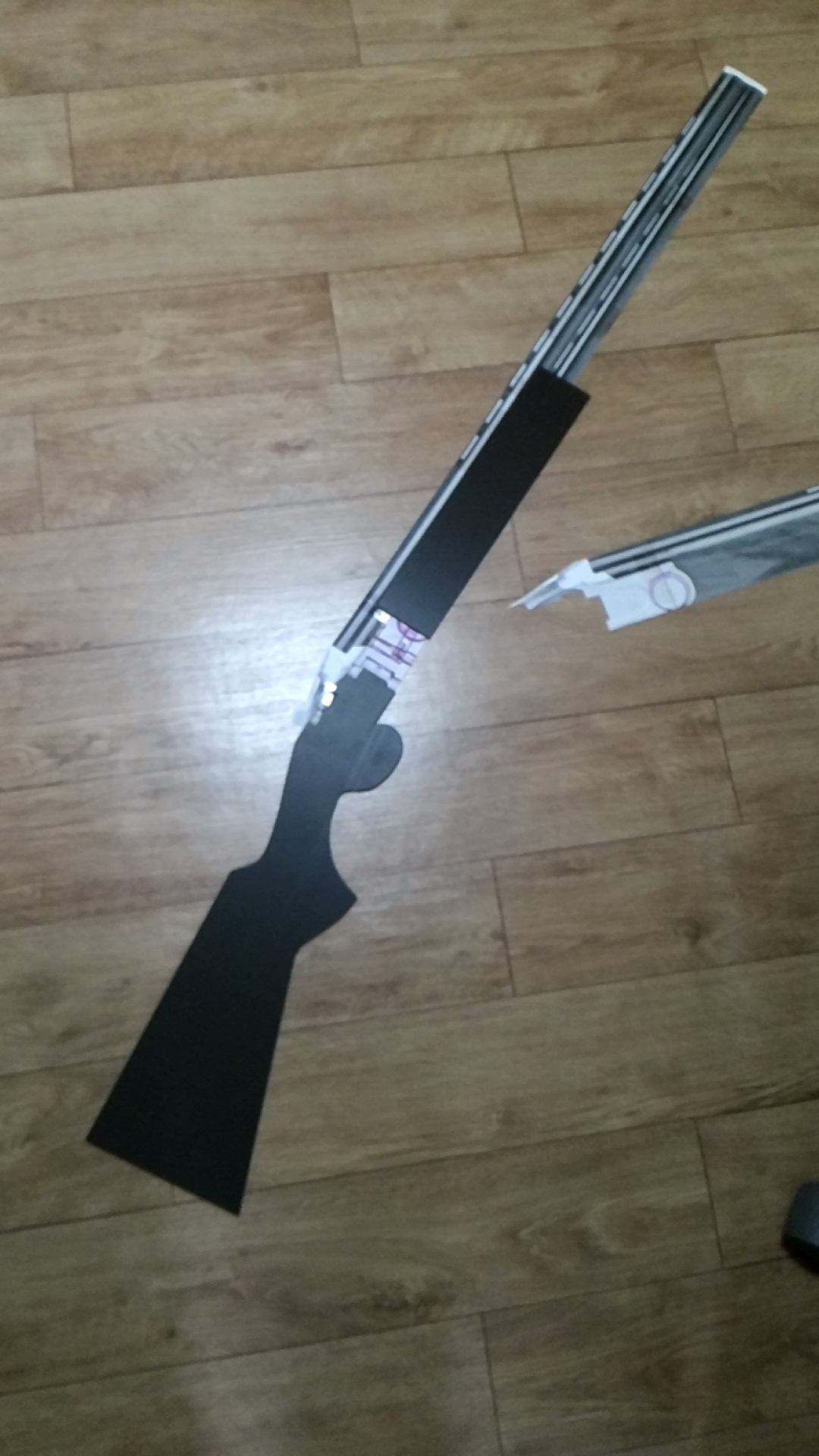

Annnnnnnnd
Always check the barrel guys.....
Yet another fantastic project, you really are getting the hang of this construction technique :)
Welcome to the club :D it could have been worse...

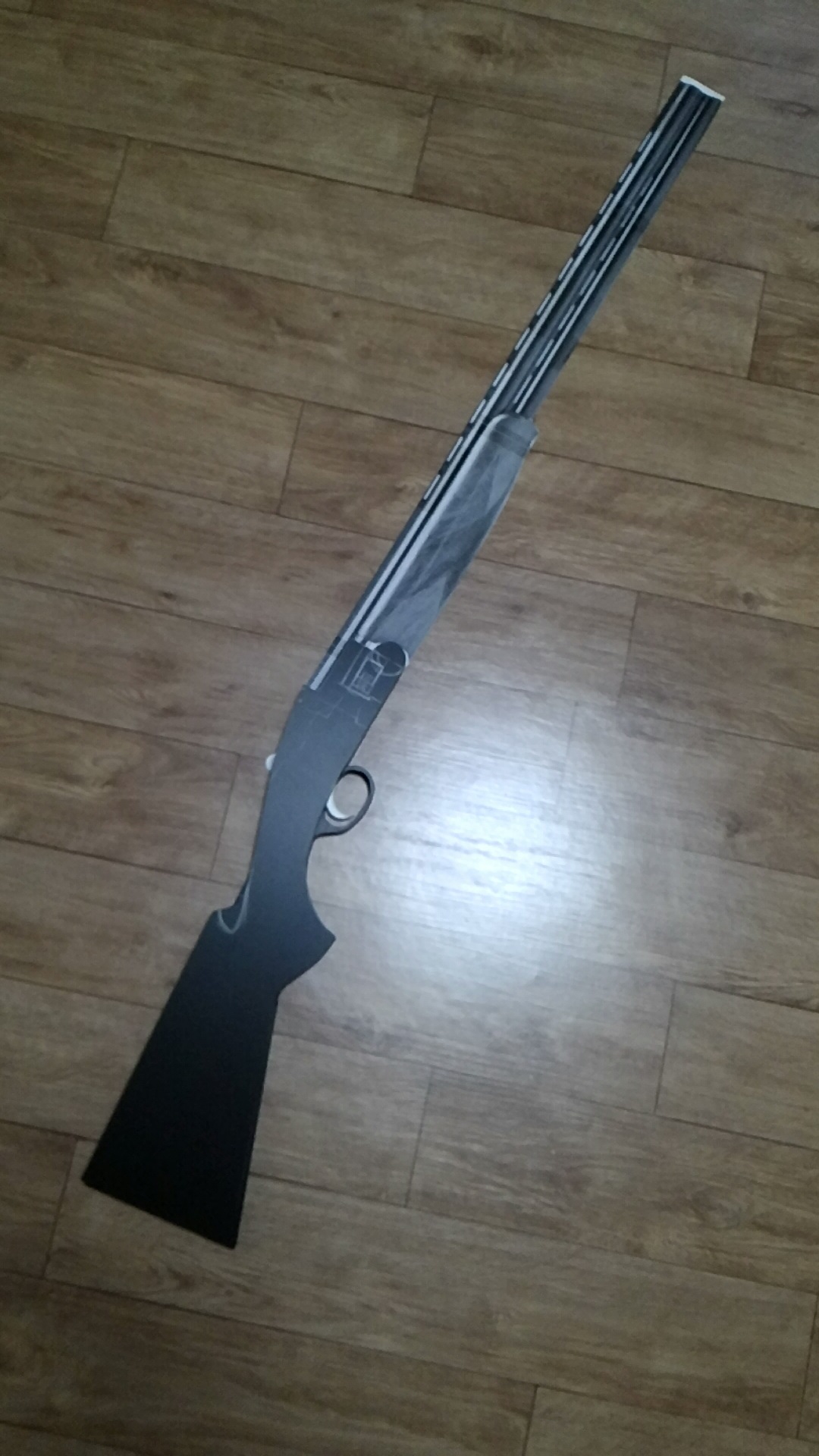

new project...
I see a M107, AA12 and VSS Vintorez... if you keep to your usual standards this should be good :D
