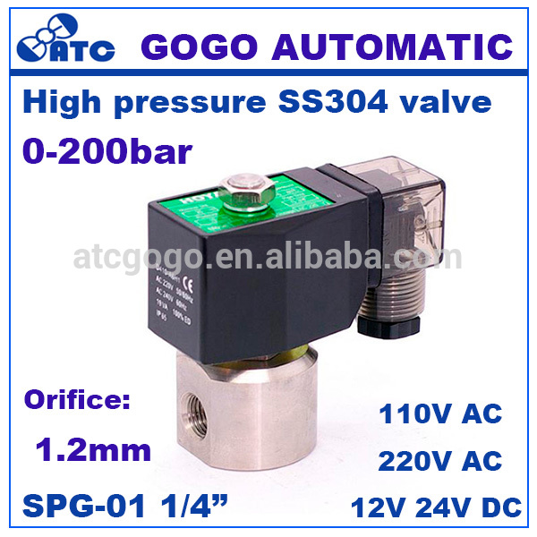

I don't know, are you stuck with something like this :?
Welcome to spudiles!
For your requirements, I think a burst disk is a much better idea for a valve and indeed most high speed gas guns employ such technology.
Tiny orifice but it could be a decent pilot for a small QEV. I have used a schrader to pilot a 1" diameter piston valve in the past.
