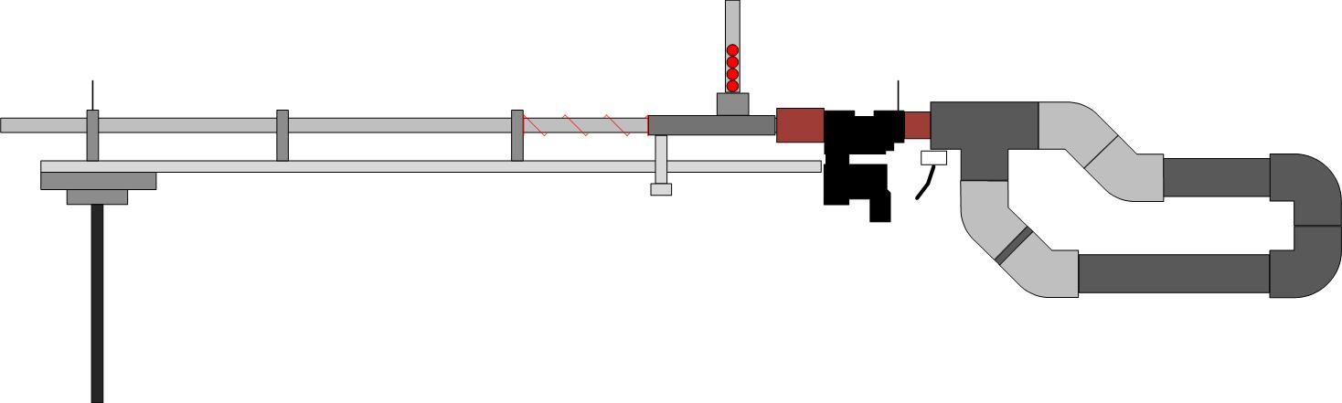

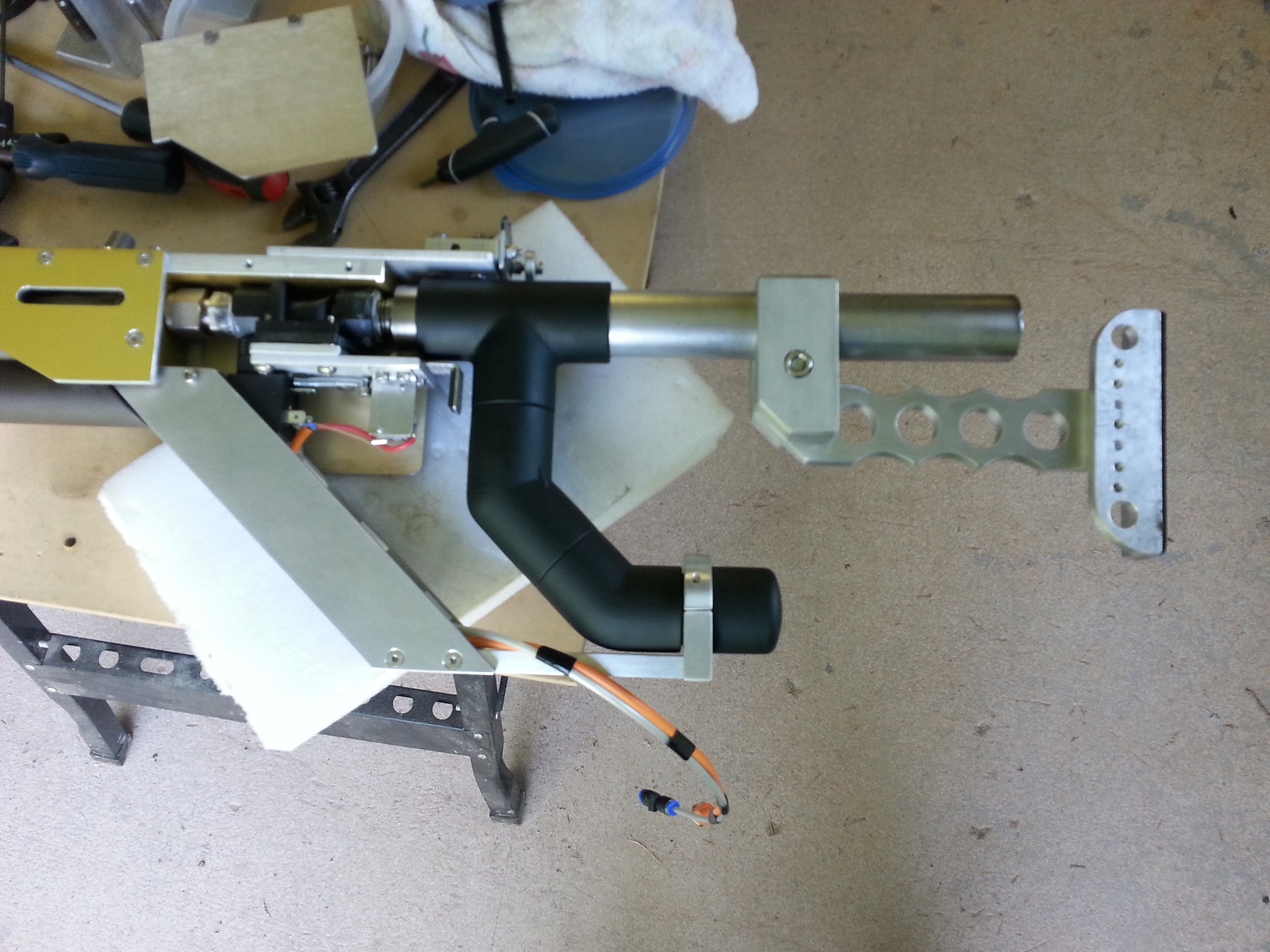

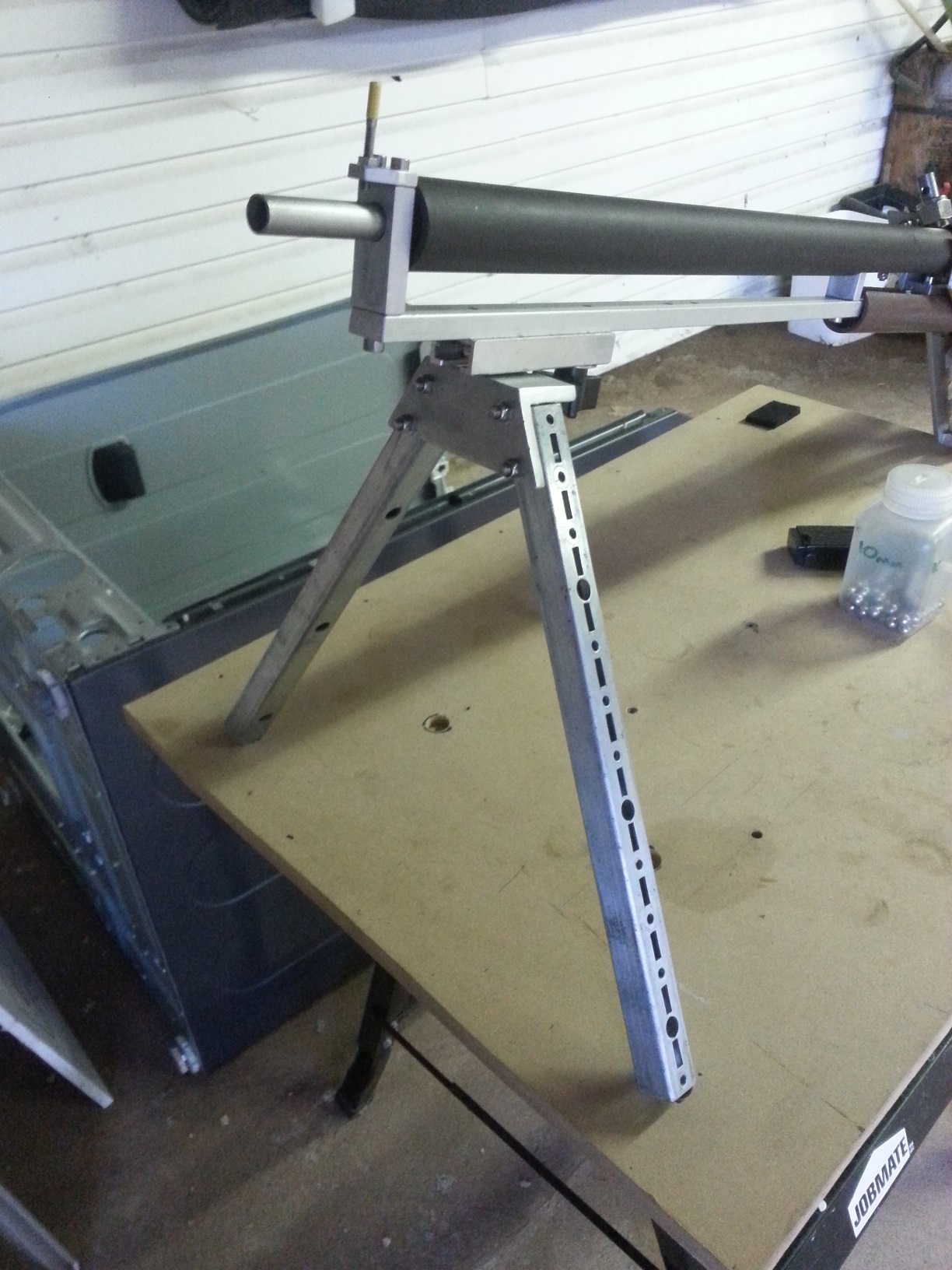

This might be my final build for awhile, I've built pretty much everything I want, well maybe that target pistol :idea:
I'm calling it the LEE10, ammo is 10mm ball bearings, magazine will hold 10, bipod from BFG will fit, making iron sights for this one.
Lee - Copy2.jpg (30.97 KiB) Viewed 8358 times
Will be roughly the same scale as the Lee Enfield

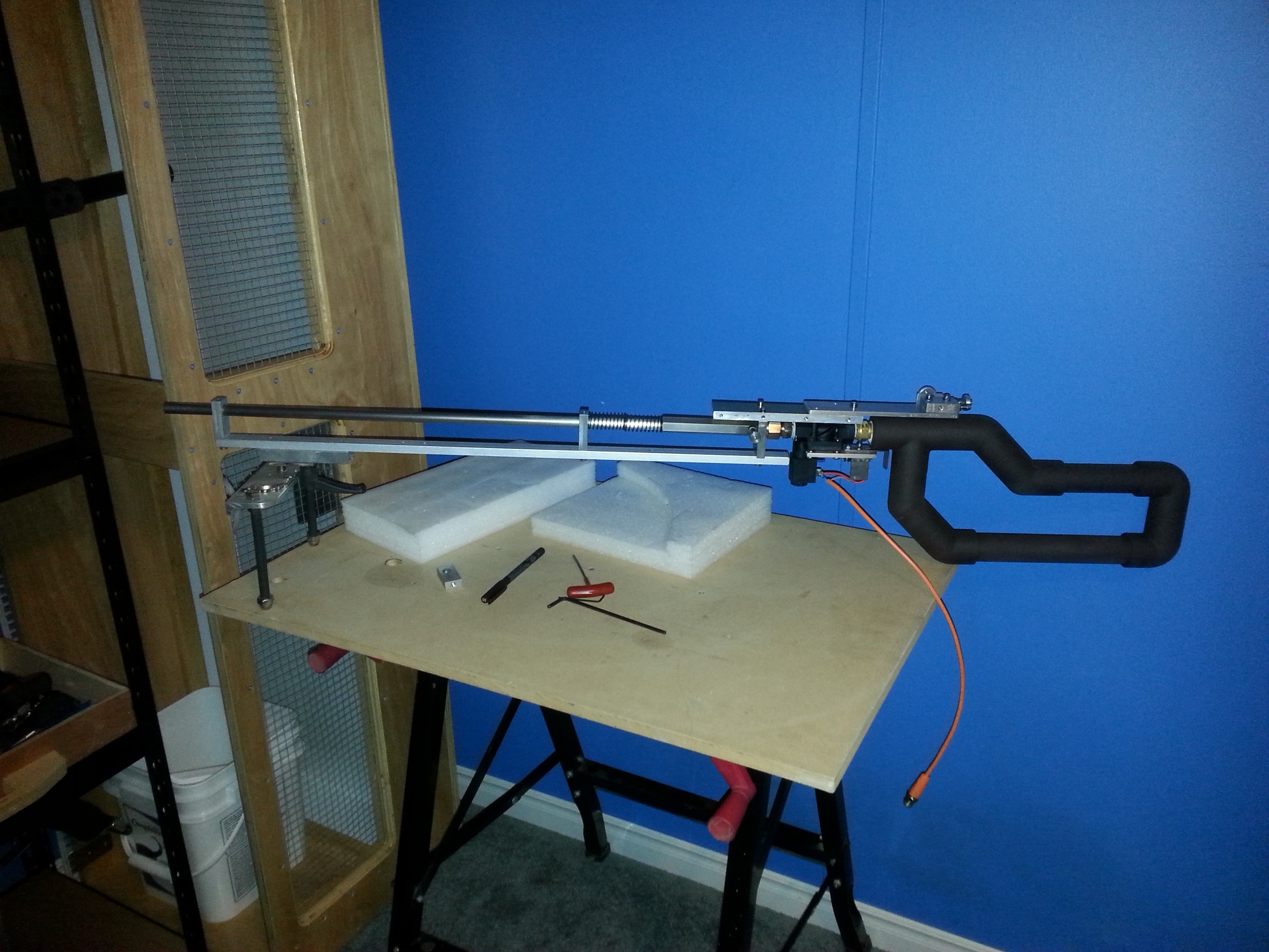

And so it begins

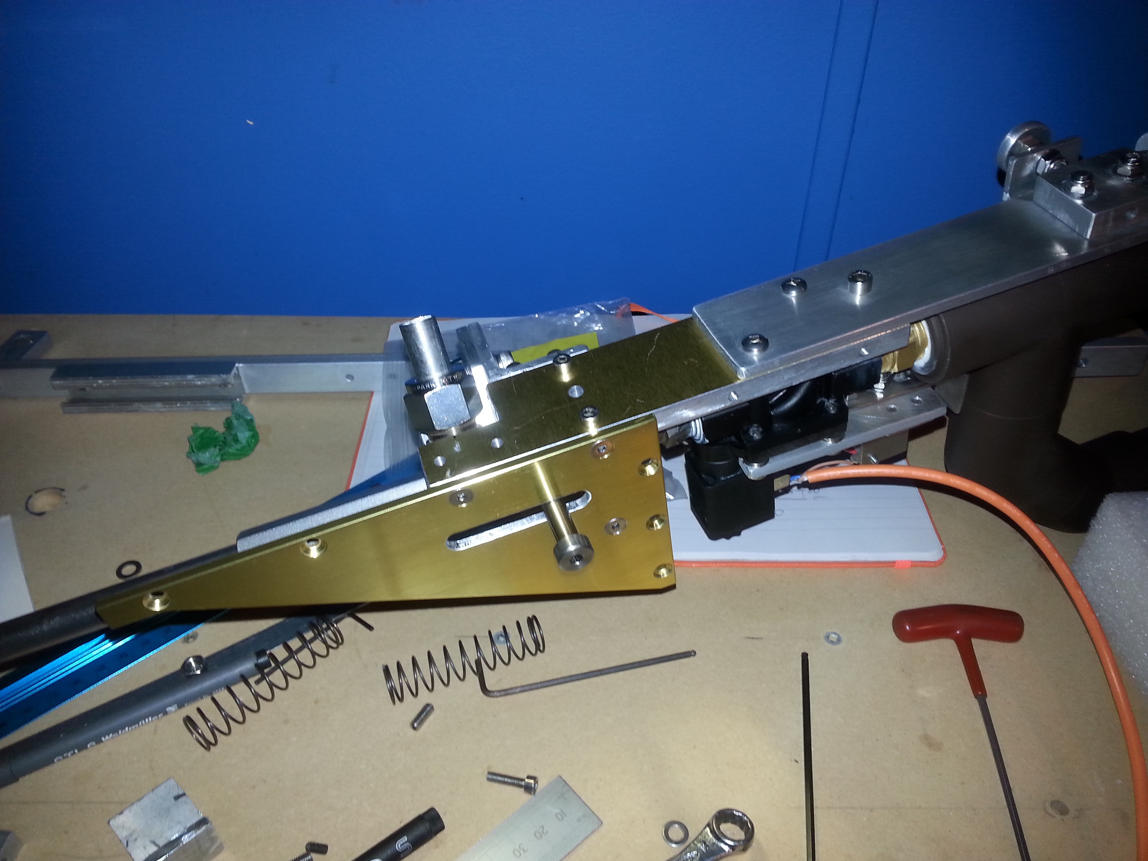

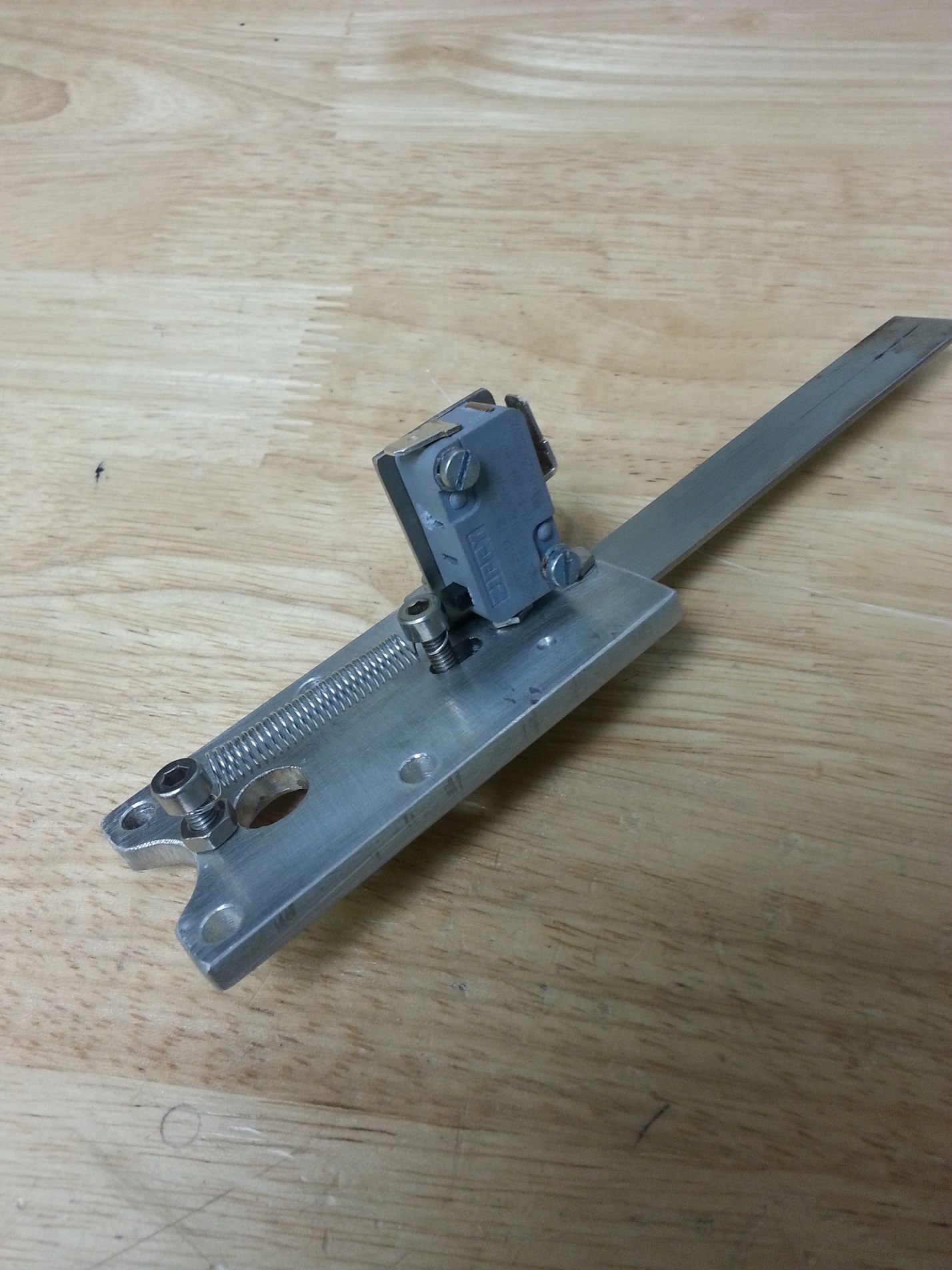

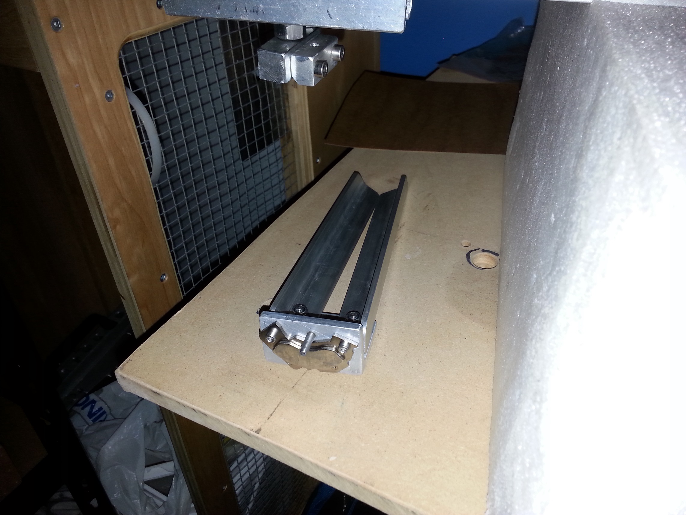

Playing with the trigger switch a bit, the slide has 4mm of travel to actuate the micro switch.
farcticox1
Canada
Posts: 1089
Has thanked: 69 times
Been thanked: 106 times

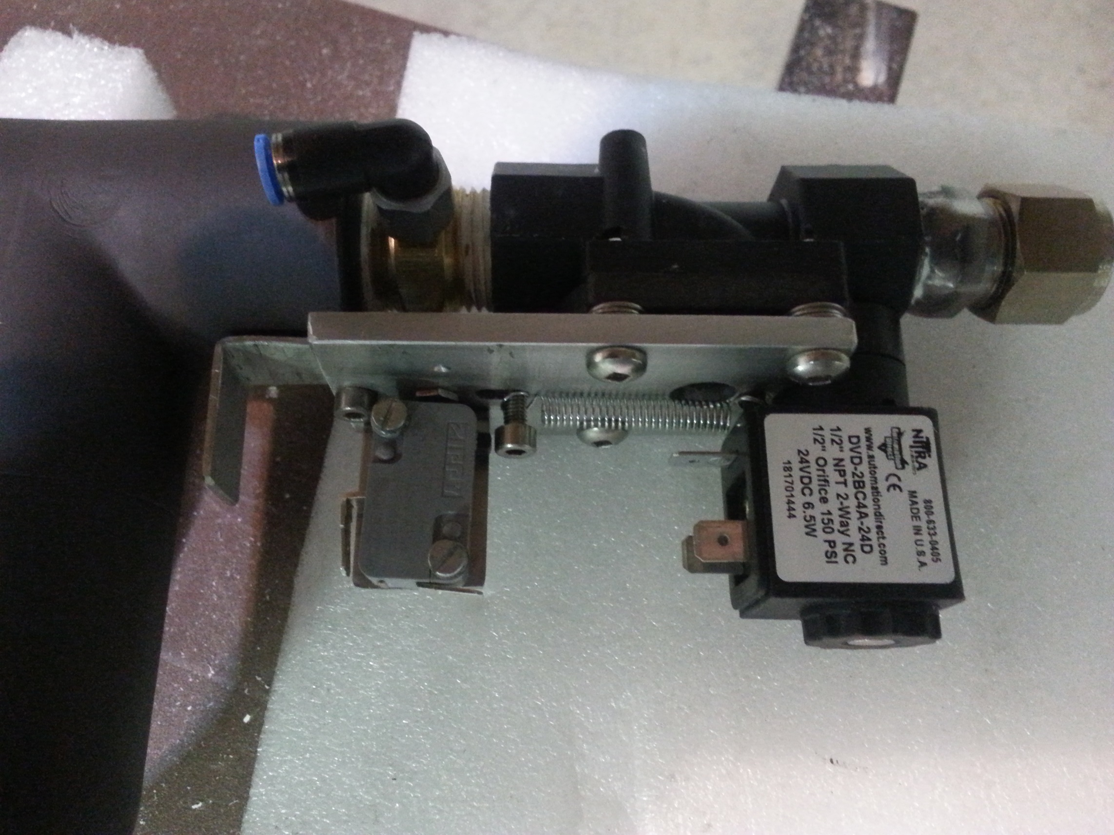

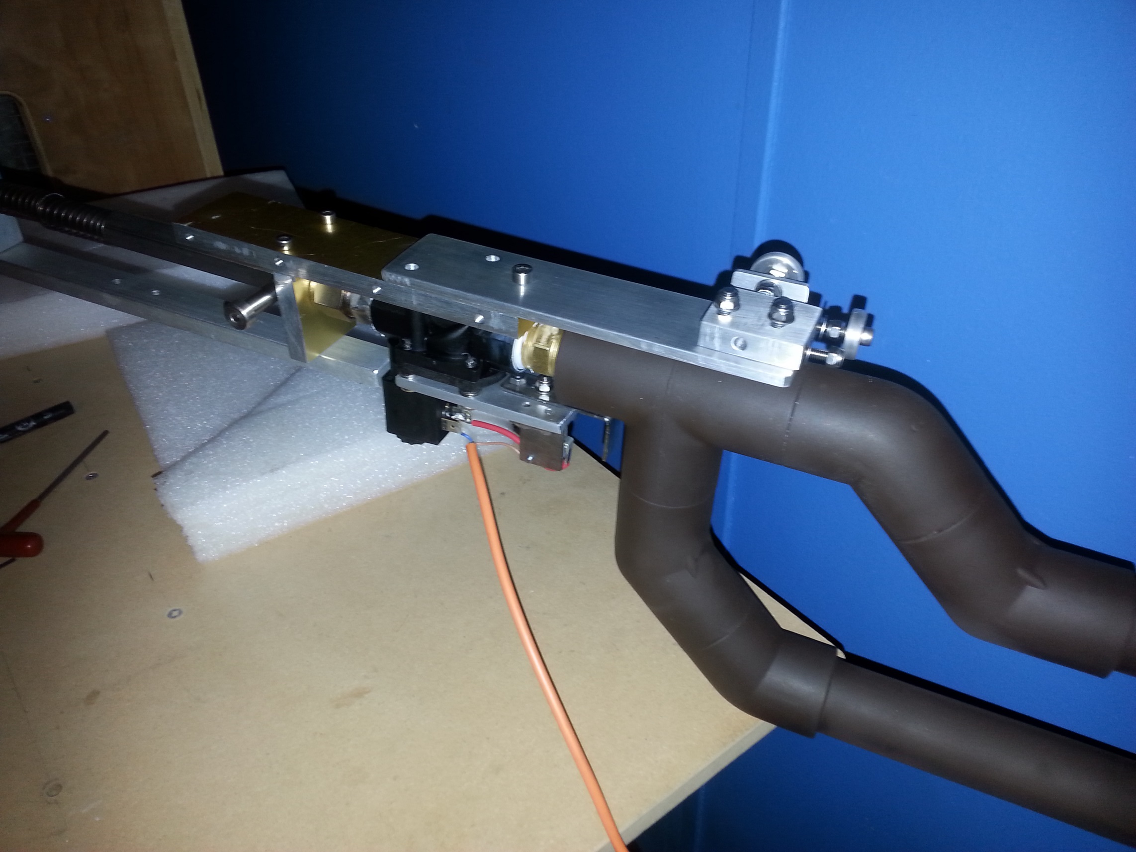

Finally got the trigger to fit, very tight.
Just hope the valve is quick enough, spec. for valve is 20-80ms for complete cycle

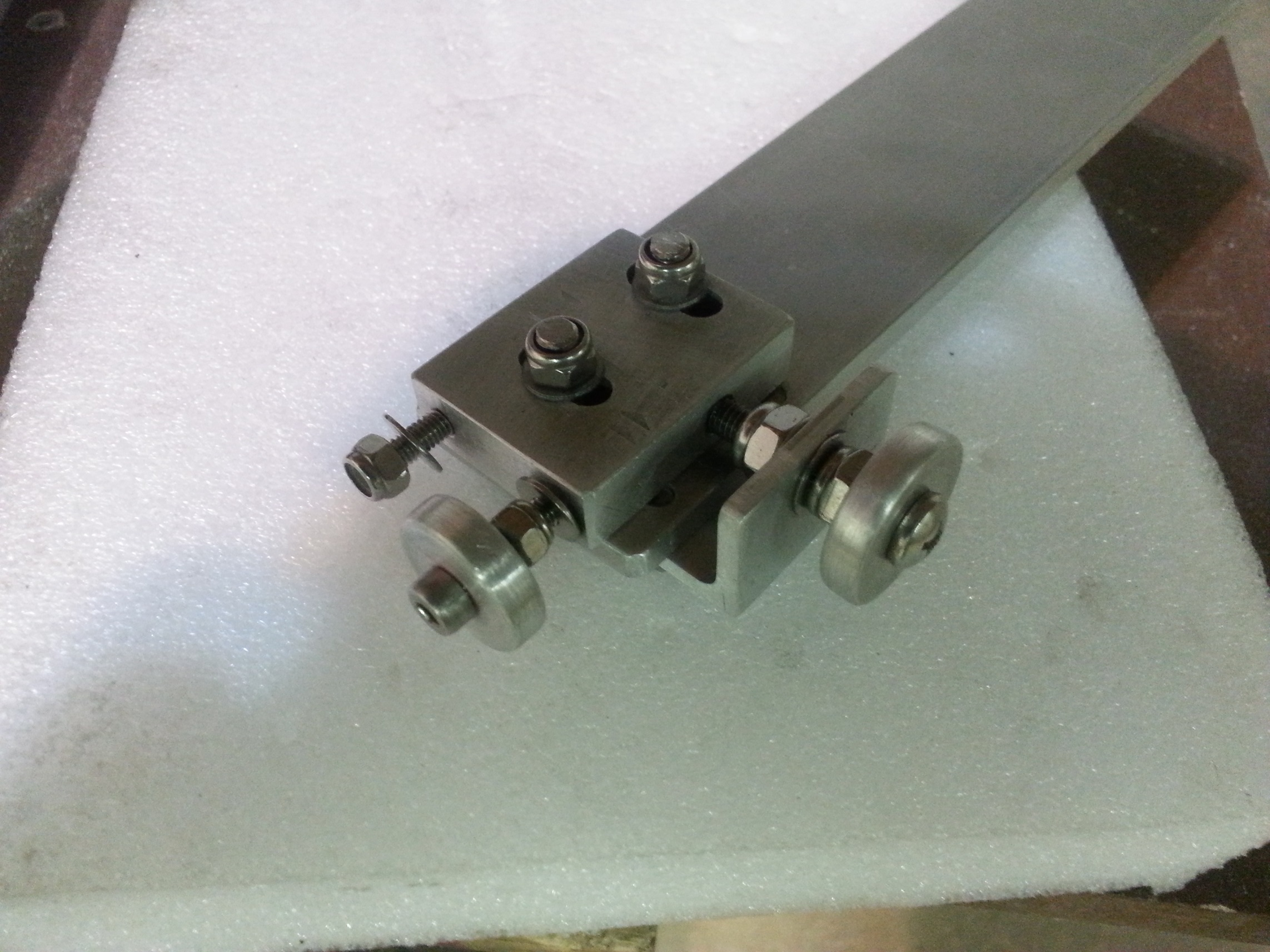

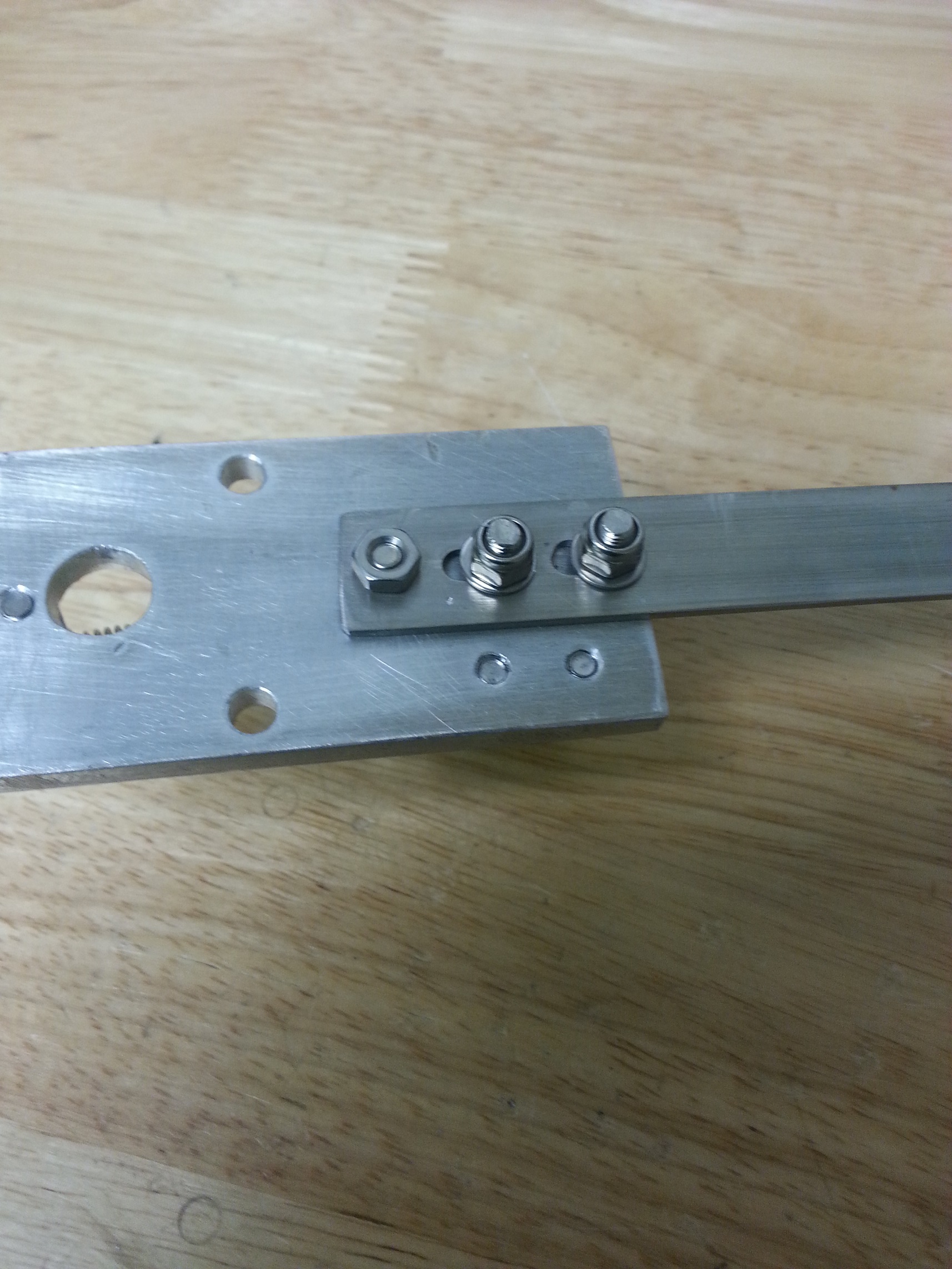

And working on the sights, adjustable elevation and windage.
Argentina
Posts: 1064
Location: Argentina
Has thanked: 274 times
Been thanked: 276 times
looks good, and neat construction.
Posts: 26220
Been thanked: 352 times
Love the sight, again impressive what you can do with basic tools and a lot of patience.

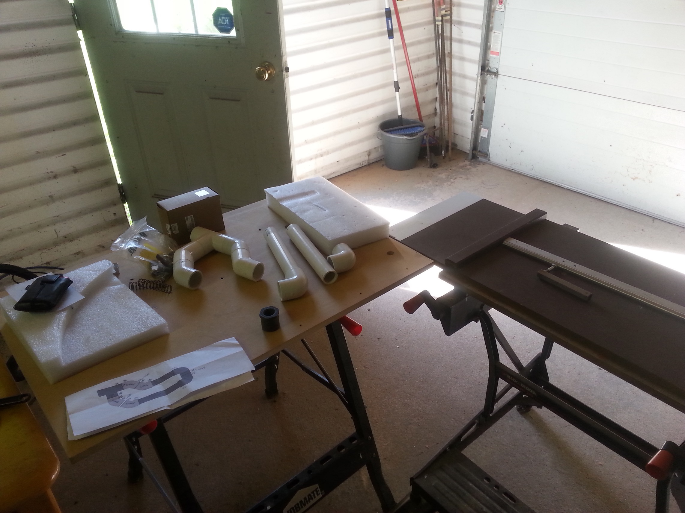

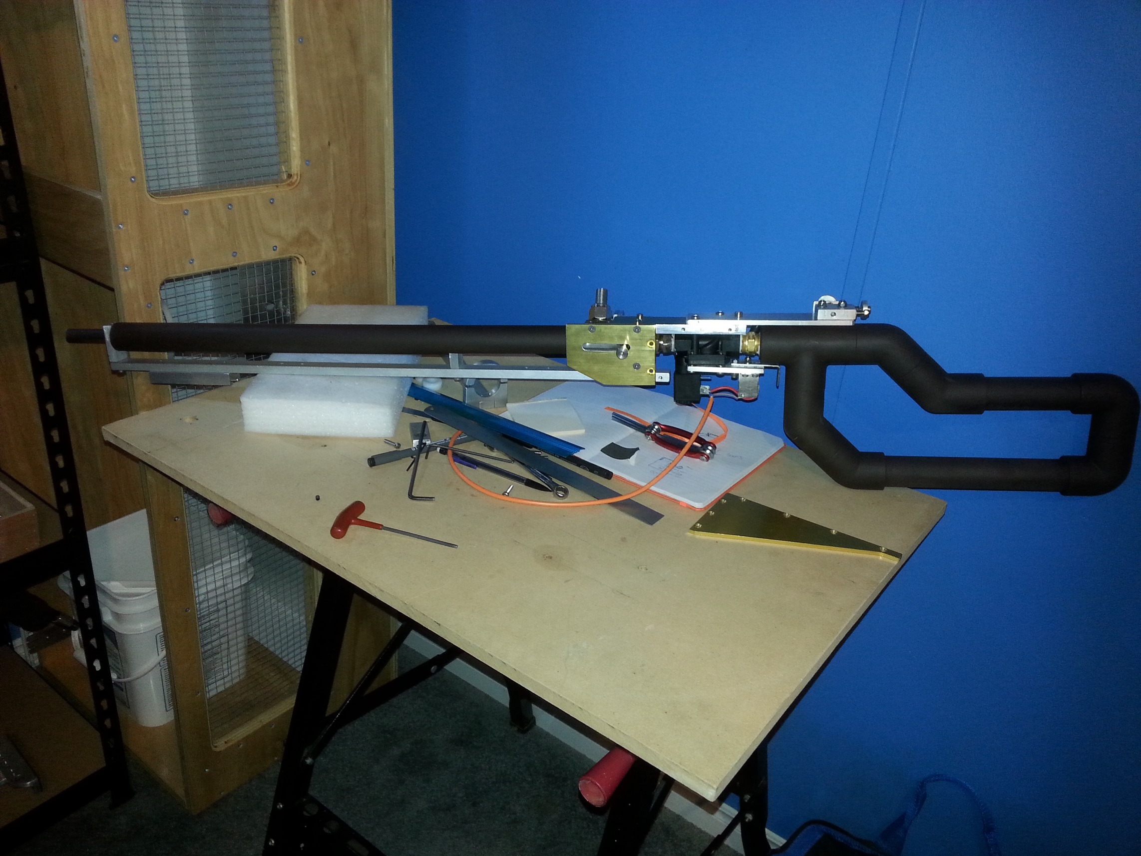

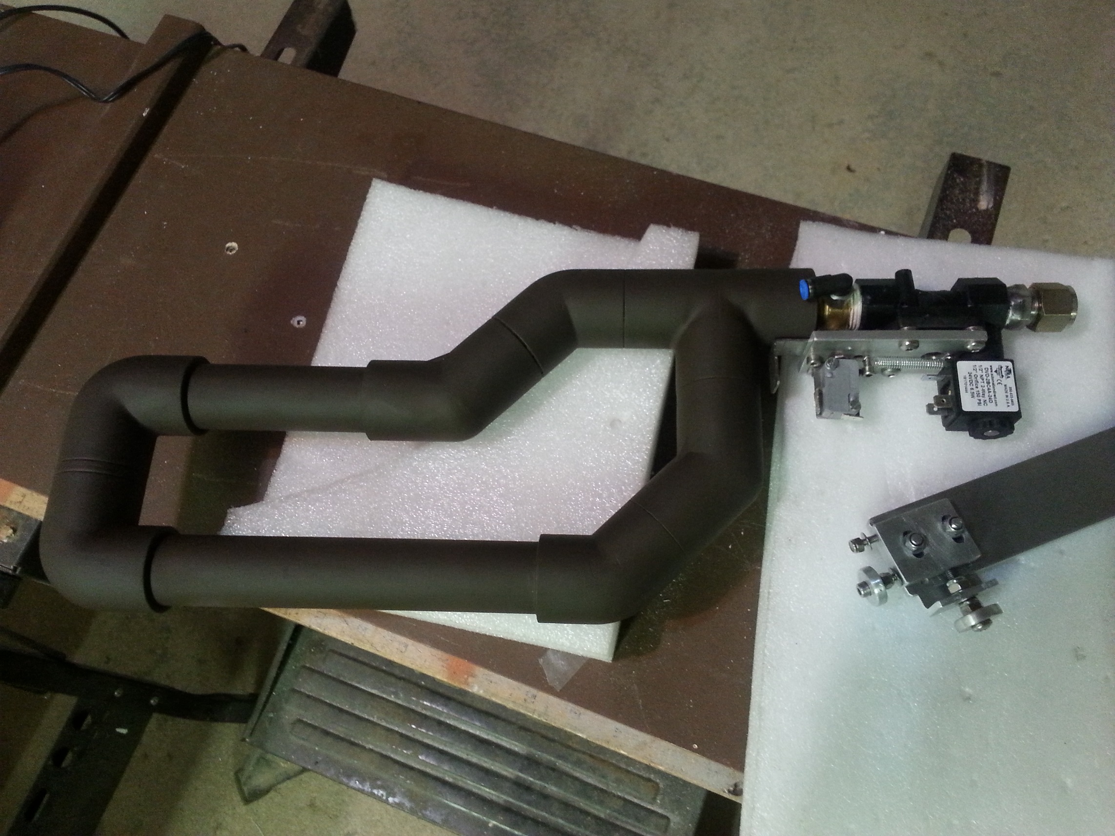

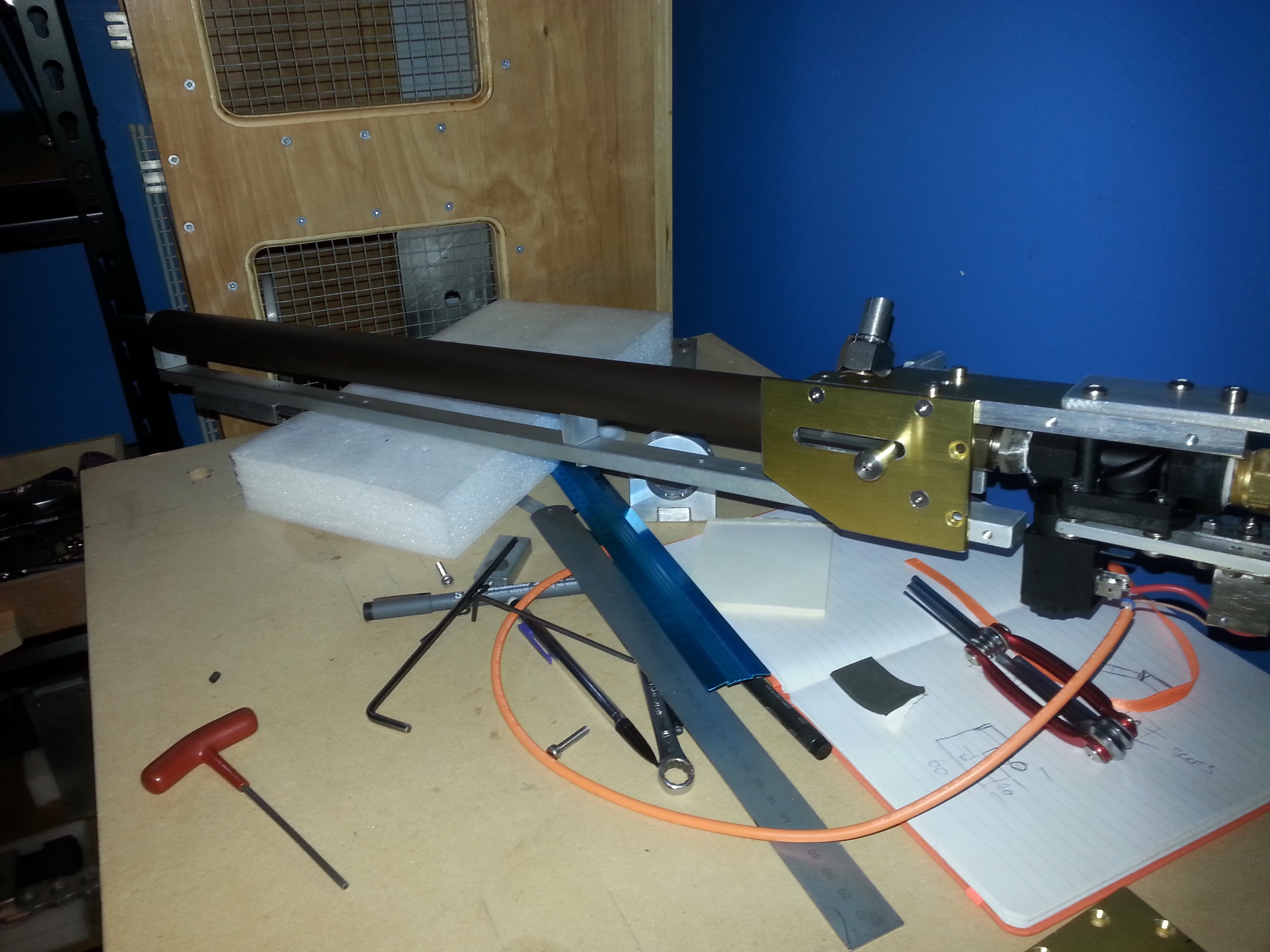

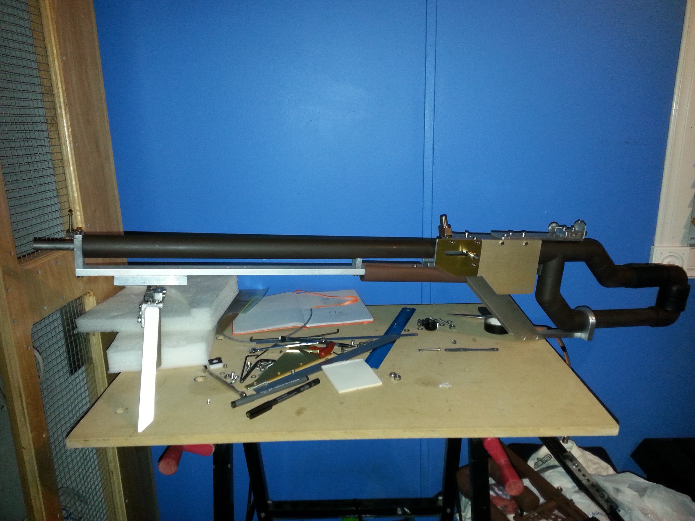

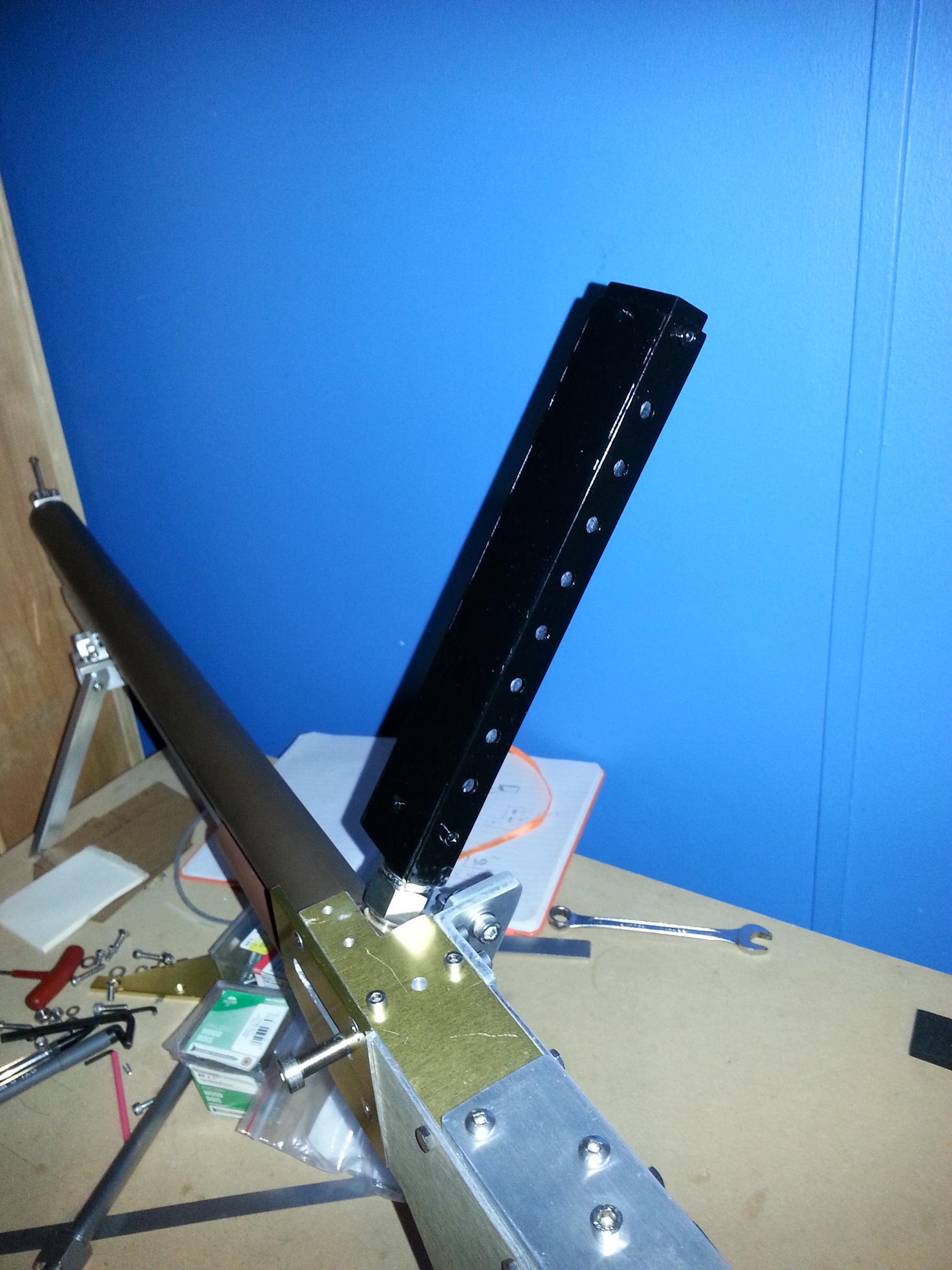

Moved my assembly bench inside as
Put some more parts together.

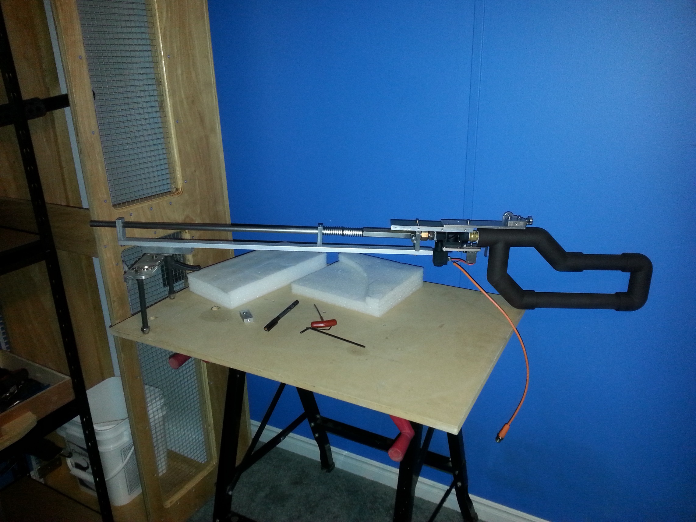

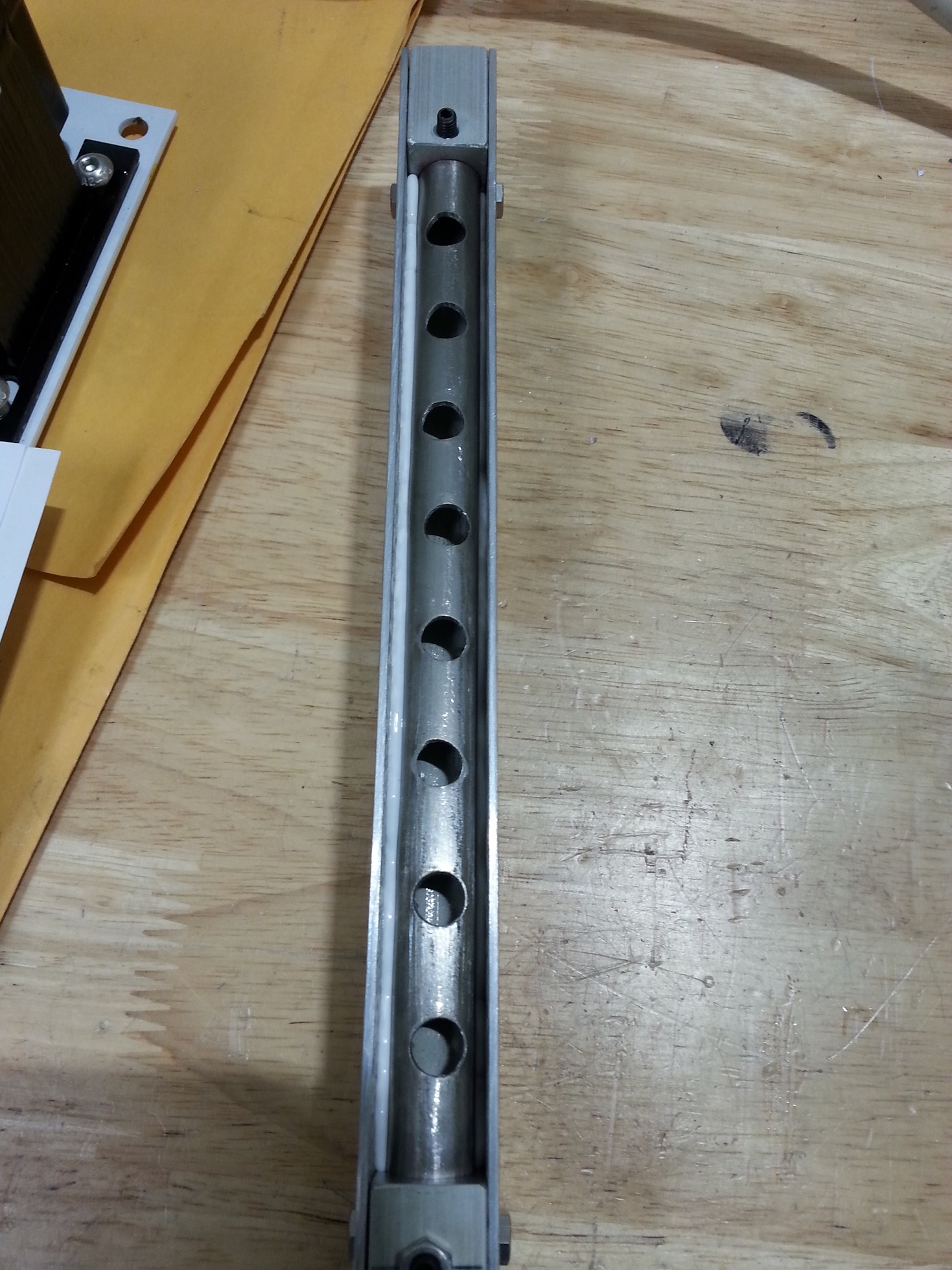

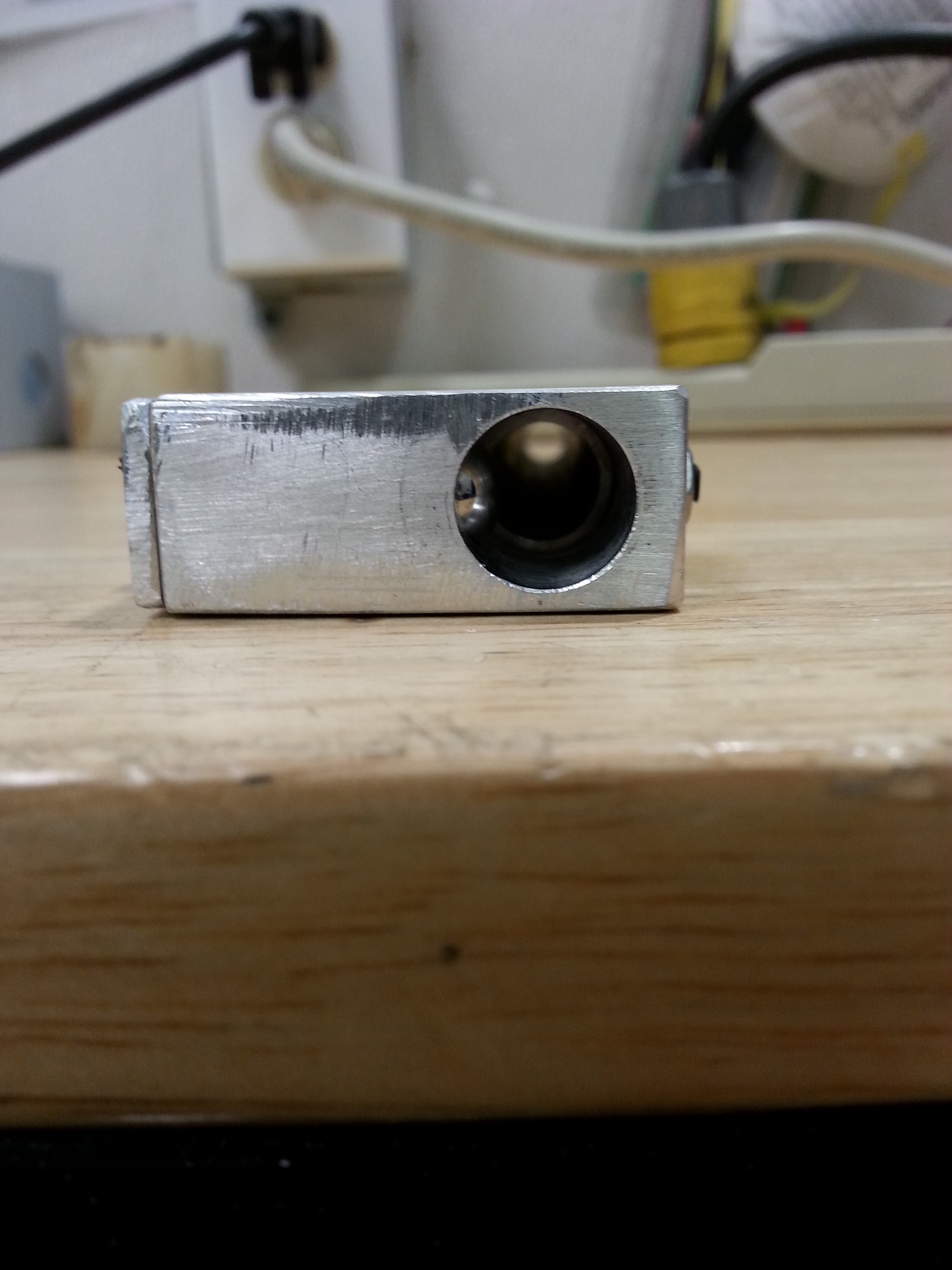

Some 'Golden Gun' work, the short tube holds 5 rounds
Gnarp
Posts: 31
Joined: Thu Aug 22, 2013 4:02 am
Locking good:) are you going for single shoot? In my AK6 i need to go over 20volts to make it trigger at 20bar and 25bar i use 30v. My is rated for 12v and 20bars:P So boost the voltage and it should go faster! Ad a capacitor. btw do you have a link on the solenoid valve?
farcticox1
Canada
Posts: 1089
I am using 24Vdc 1Amp unregulated power supply, so it sits at about 30V when it's not loaded.
Single shot with a self loading bolt action. The valve is rated for 10bar max and the stock/chamber is PVC so I can't go over that anyway :shock:
This is the valve https://www.automationdirect.com/adc/Sh ... -2BC4A-24D
