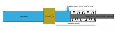

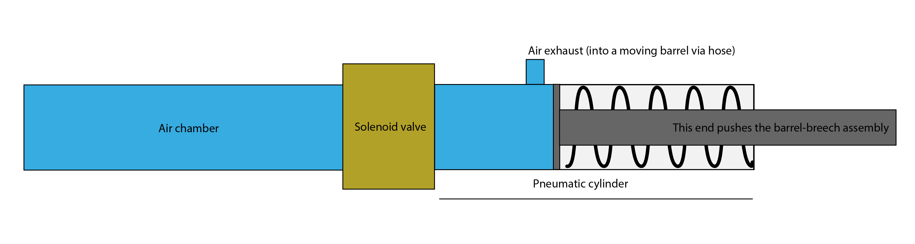

Here is my simple drawing. What I have in mind is a modified pneumatic cylinder with an exhaust. Upon opening the valve the cylinder pushes the barrel-breech assembly backwards for a moment. Then the piston reaches the exhaust and the air rushes to the barrel to make the shot. Piston then travels further with smaller amount of remaining pressure; mainly because of already created momentum of the barrel and the breech assembly.
What I tried to achieve with this solution is that only a single valve and single air chamber could be used. And to create a compromise between the power applied on a piston and an inevitable delay of the shot.
The same could probably be achieved with a specific 3-way solenoid valve but likely with greater space demands and with some controller circuit necessary.

Sear wrote:From what I saw (and I admit this tech is new for me), cylinders didn't seem to have any perceivable acceleration time in the beginning.
If they're trying to shove a 45kg launcher about, they are going to be slowed down quite a bit.
This flow restriction is going to *massively* cripple performance.
You'd be far better off doing it the other way around, tapping gas off the barrel for the pneumatic cylinder (rather than tapping gas off the cylinder for the barrel).
If you trap some gas in the cylinder with something like a check valve and a way of venting it once it'd recoiled enough, then it'd let it recoil for longer than the projectile was in the barrel.

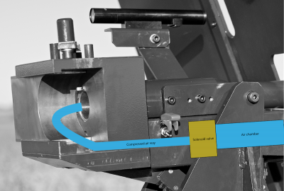

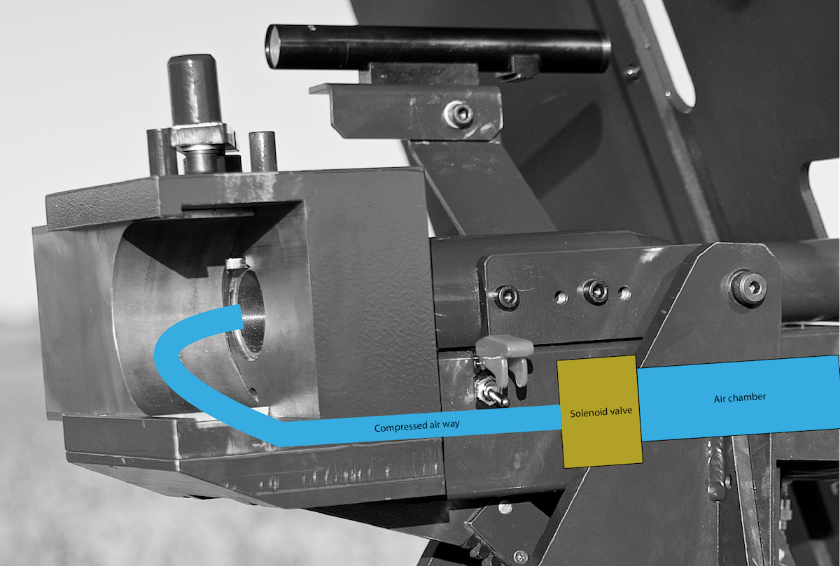

Ok, here is how the setup looks like.
Ragnarok
Posts: 5401
Location: The UK
... right, I've gone back and looked through your posts.
If this is for paintball, the performance of the design is probably not a major concern.
I do have two concerns though:
-If such a light projectile and low velocity is involved, the pressure and the time the system is under pressure simply may not be enough to be able to drive a recoil mechanism off the same valve.
- And I do question the safety aspect of having a 45kg launcher recoiling "aggressively" in the relatively hectic environment of a paintball game. If anyone is the slightest careless or a component fails at the wrong time, someone could get fingers broken or severed.
