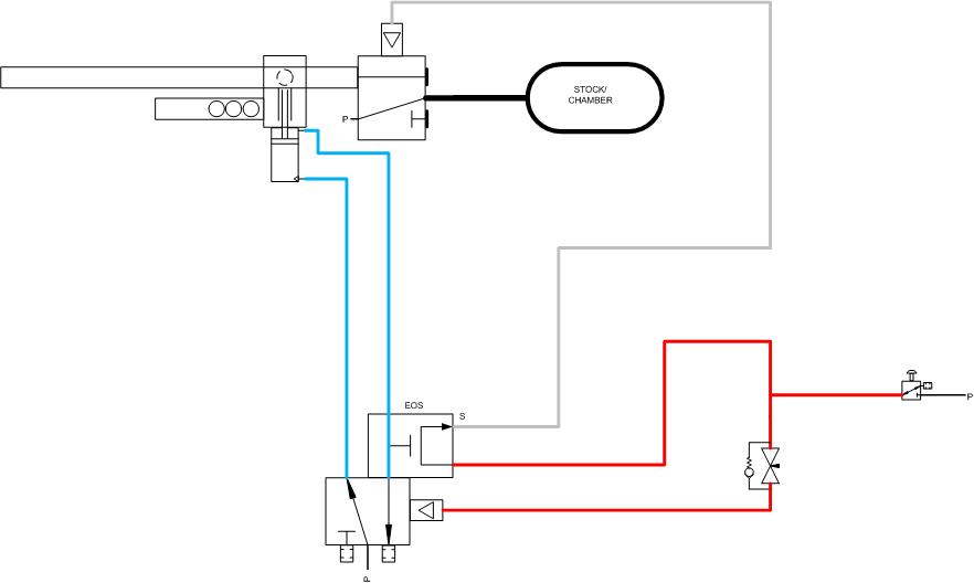

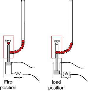

This is how this one of mine works, the pneumatics got a bit complicated though :shock:
self loading block piston.jpg (11.29 KiB) Viewed 6542 times
air lines 3.jpg (25.5 KiB) Viewed 6542 times

farcticox1 wrote:This is how this one of mine works, the pneumatics got a bit complicated though :shock:
It is very logical the system that F1 uses. :) I use them in a similar way but I block the ammunition that goes in with the one that comes out so that two do not enter. Otherwise, if the measure is very fair, sometimes the ammunition entry is blocked.

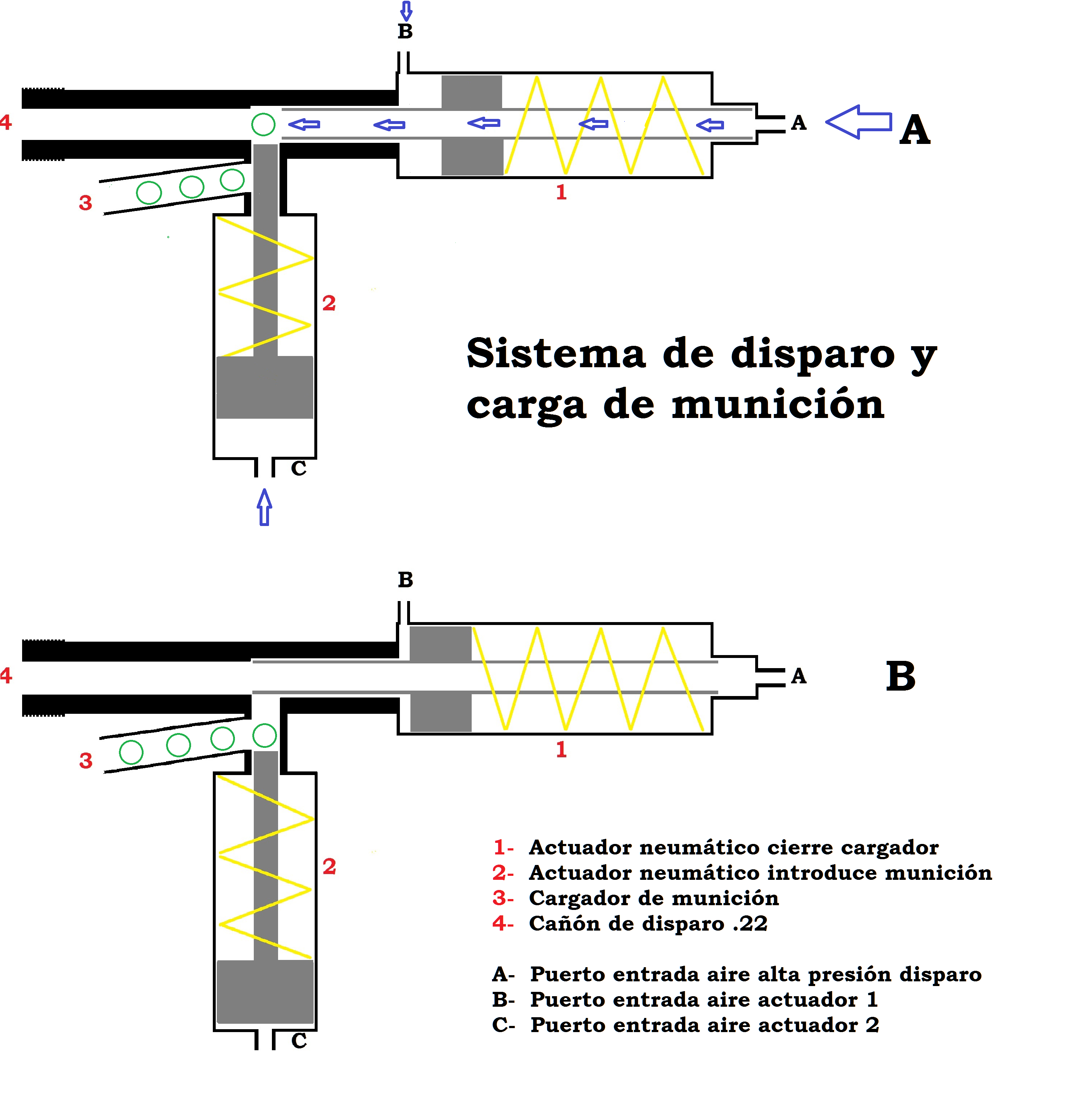

Argentina
Posts: 1064
Location: Argentina
Has thanked: 274 times
Been thanked: 276 times
My system is like that. Can shoot semi auto and full auto. :D
