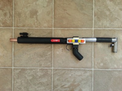

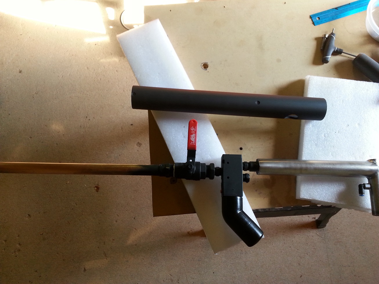

I had a go at a shotgun, a 3/8" valve provided plenty of flow.

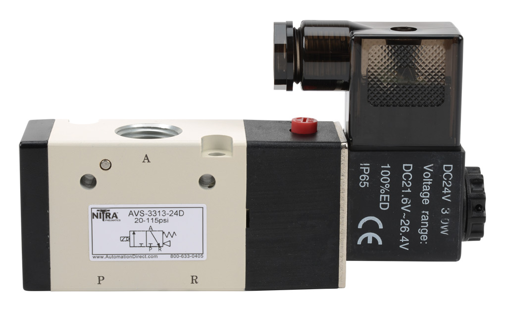

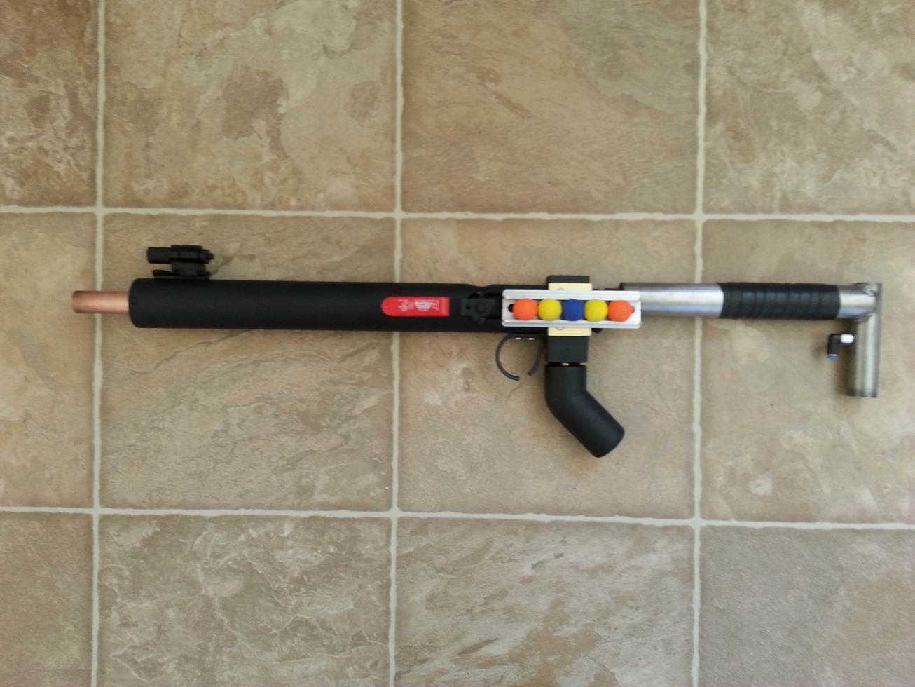

I used a 3/8" solenoid valve, but used the manual button as a trigger, I would think a 1/4" would be ok for air soft, or you could go with a QEV valve but then you will need a trigger valve as well. I used PVC on my shotgun but I would recommend that you don't, I did replace the chamber with stainless steel and the barrel with 3/4" copper, but it is only for Nerf Rival now. If I was going to make another shogun I would use copper again with an inner barrel and probably the 1/4" manual trigger valve.
Here's a nice one https://www.ebay.ca/itm/DC12V-Air-Alumi ... rk:91:pf:0

Farcticox what is that thing at the bottom of that solinoid valve on your rival gun?

I removed the solenoid coil and made a grip from 1" pvc pieces. The red button is the trigger.
