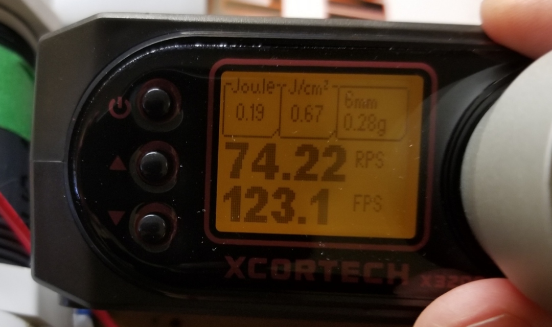

I think I just figured out my BBMG design. I tried putting the barrel along the bottom of the bb chamber, with the air inlet through the back of the endcap, inline with the barrel...about 3/4" inch between air inlet and barrel. With the detent, it works beautifully.
I nearly packed it full of .28g bbs and ran it at 100psi with my small solenoid. I kept the gun completely horizontal and stationary and got a consistent 70-80 RPS until it was less than half full and then the ROF started to drop off a bit. When I got near the end (about 25% left) the ROF dropped off to 40ish RPS. I think with my intended use, it's going to work well just as it is. I think I could add a plunger if I need to keep the ROF and feeding more consistent. FPS was 117-131 throughout. Which might be okay for my use...if not, I'll switch to the larger solenoid.

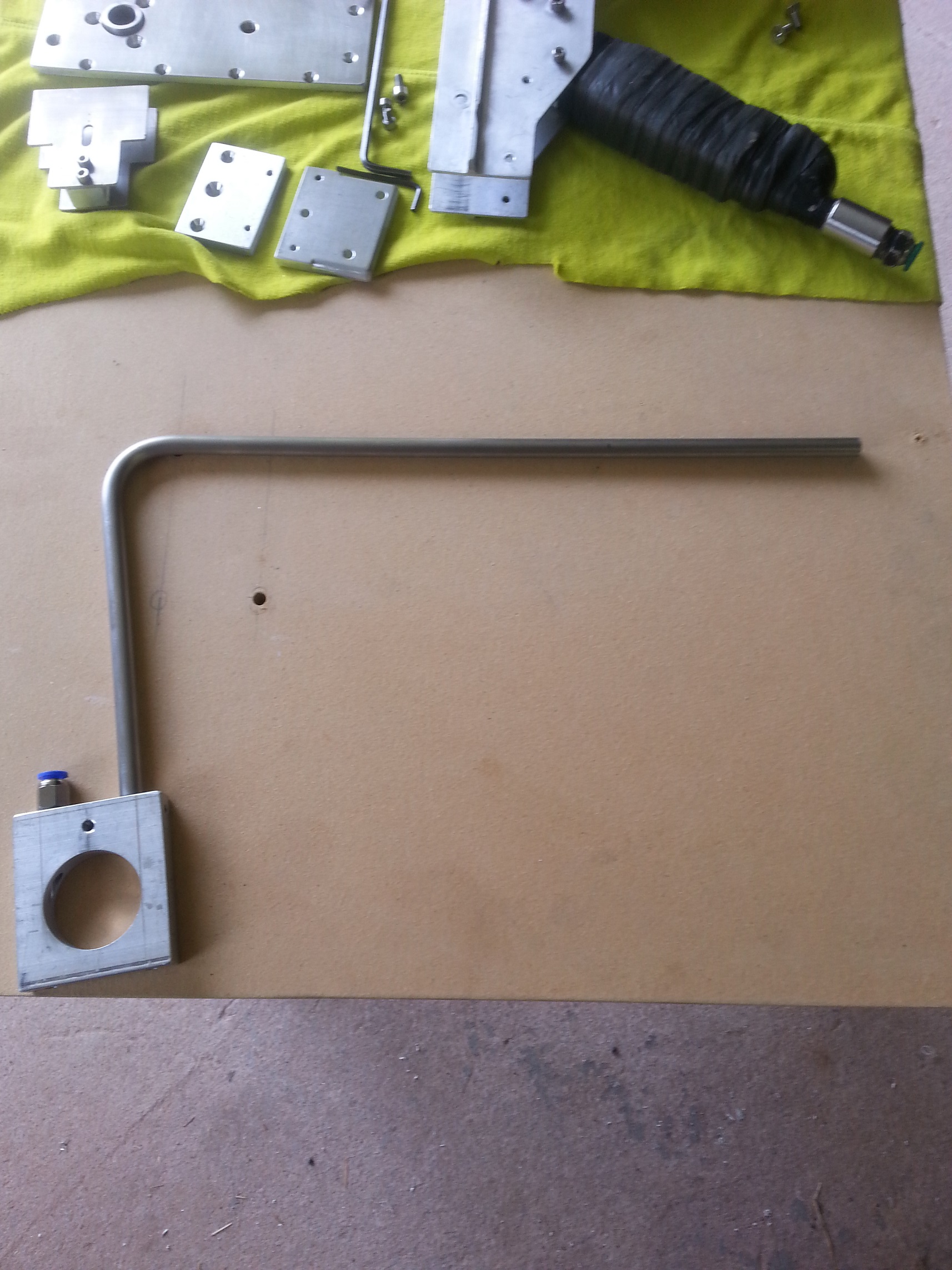

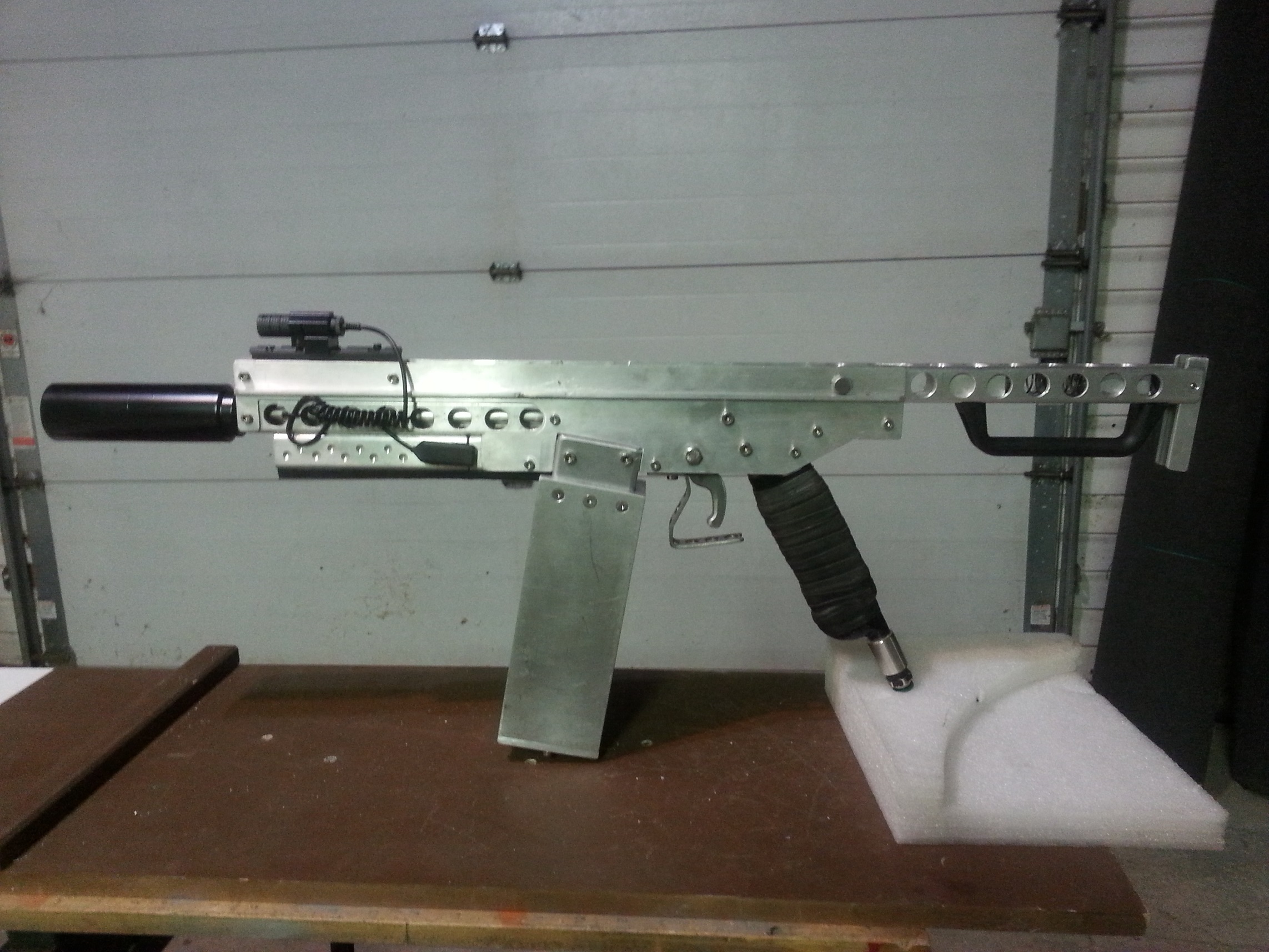

I made a vortex block, it works quite well, holds 2000+ BBs, needs a lot of air volume though
Looks like lots of interesting data there Jimmy. I'll look at that in more detail alongside my data from the one I built.
Farcticox1 that thing is cool!

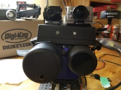

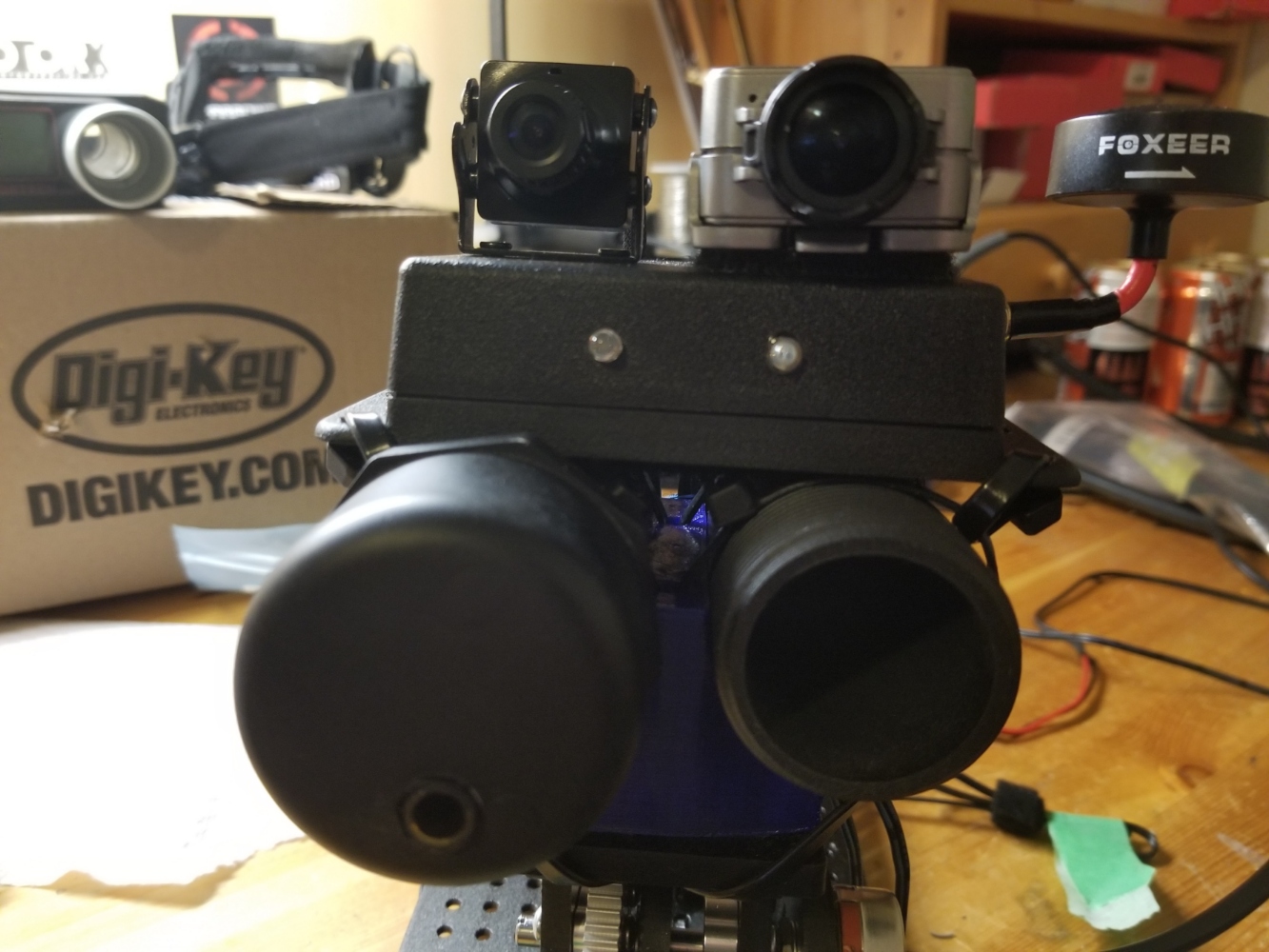

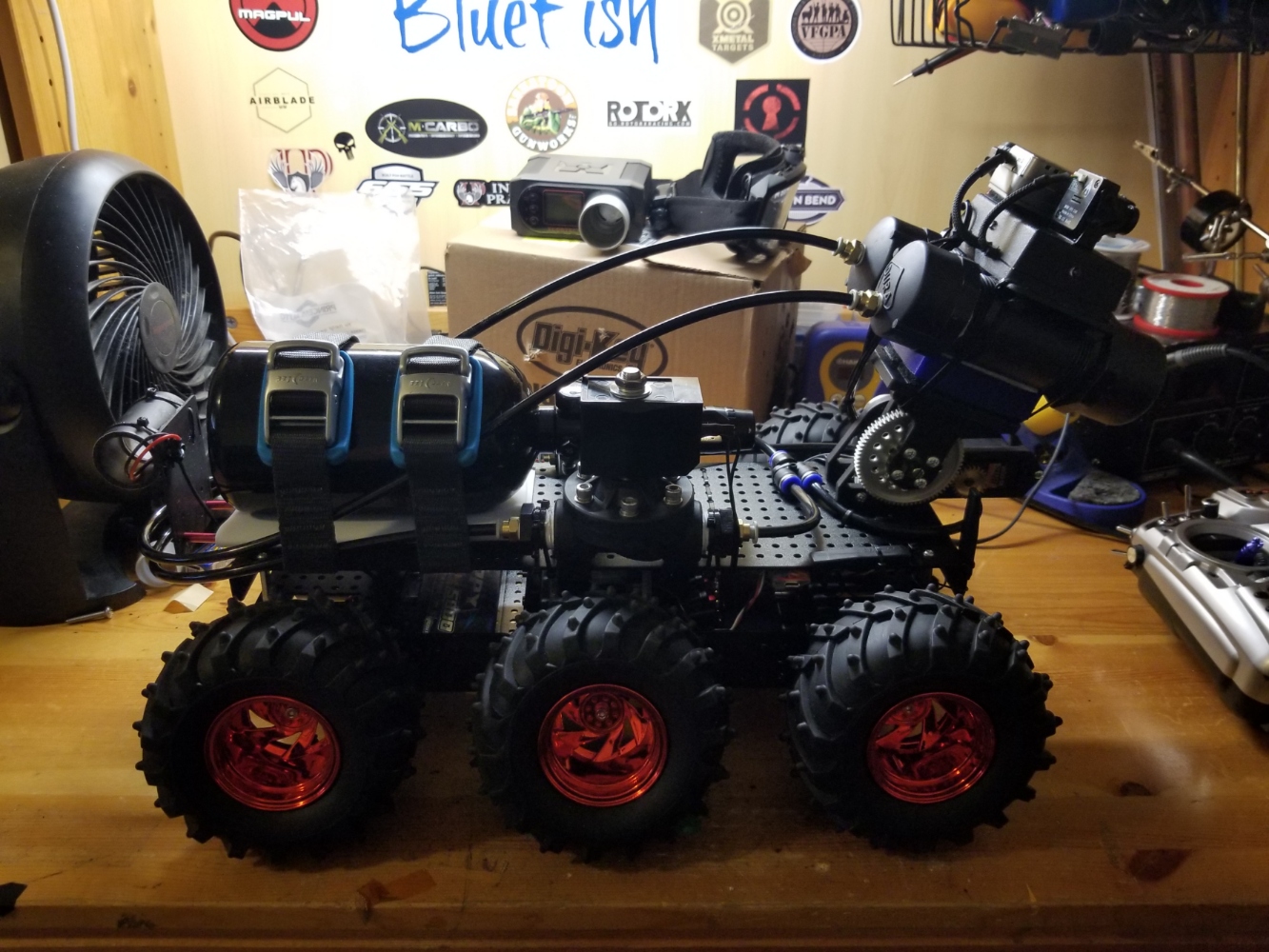

Finished my project! Haven't been able to test it outside yet, but it at least fits my standards for safety on an airsoft field. The 1/2" solenoid is massive in relation to my project, so likely will keep the smaller solenoid on the BBMG. Running at 90psi.

Nice! I was wondering what all those Digi-key boxes were doing lying aroundFinished my project! Haven't been able to test it outside yet, but it at least fits my standards for safety on an airsoft field.
You can definitely get away with a smaller valve, I used a servo-operated ball valve on my sentry project:
You'll have proportional flow control that will be able to control power to some extent, for example open it less for short range to reduce the risk of injury.
Using a ball valve instead also means that it could also be connected directly to the rear of the BB chamber along with the controlling servo, reducing the amount of dead space in the air line and making it more efficient - if "efficiency" is indeed a concept that can be spoken of with this sort of BBMG

This probably concludes my indoor testing. I broke my ankle a few weeks ago (primary reason for building the airsoft land drone) and I can't get this thing downstairs to bring it outside lol.

You have a thread for that turret? I might look into a computer vision turret for my next project. I have never seen a ball valve turn so effortlessly...did you modify or lubricate it?
