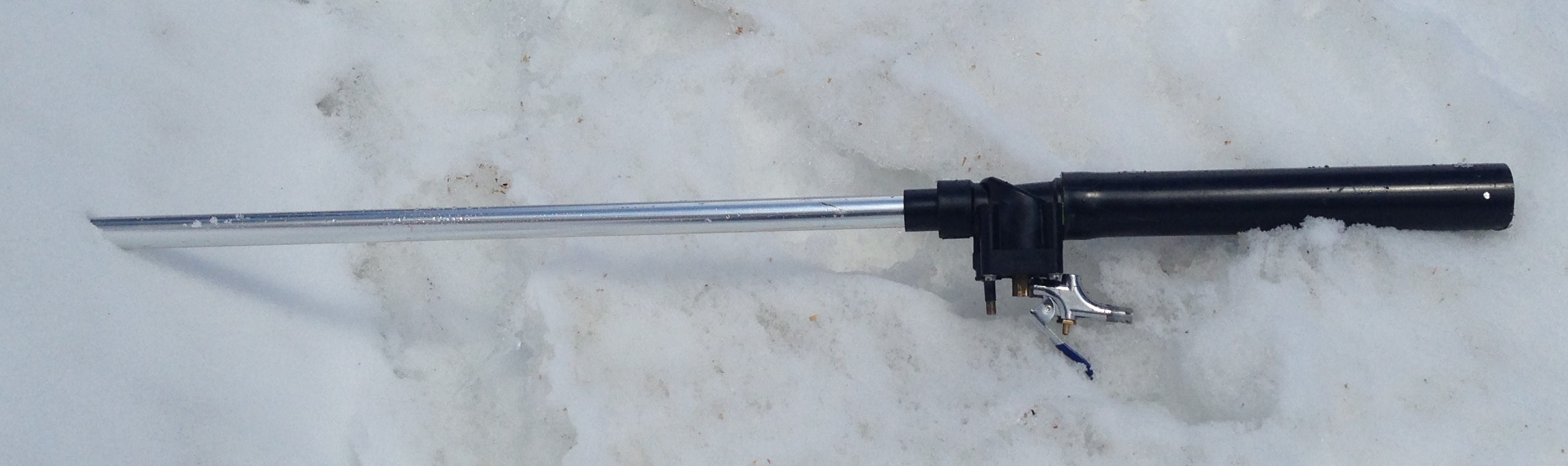

I find sprinkler valves in the ground and take them home. This is a 1" Hunter chamber sealing valve, piloted by a modified blowgun I had almost given up on. Unmodified it produced a bit of honking. I can't see how it would have worked with the solenoid... too little flow.

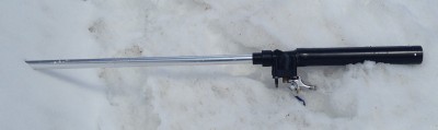

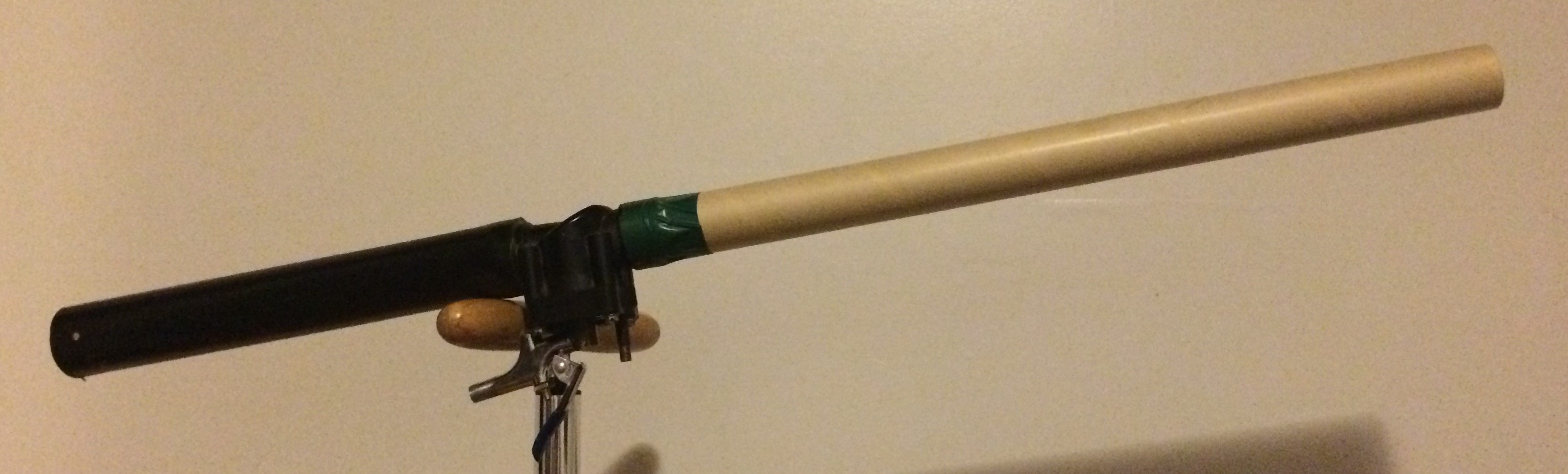

Right now it has a cardboard tube for a barrel and can launch a sock with authority. Also it will splat a sticky squishy ball into our very high (18") ceiling for old spiderweb removal. Best dusting ever!
Without the barrel it will launch a pair of briefs into the lower ceiling. My 5 year old thinks this is the best and manages to get it to about 25 psi. The future is underwear cannons!
Next step: a better barrel and/or converting to barrel-sealing operation. Current investment is zero dollars. There are several more valves to play with.

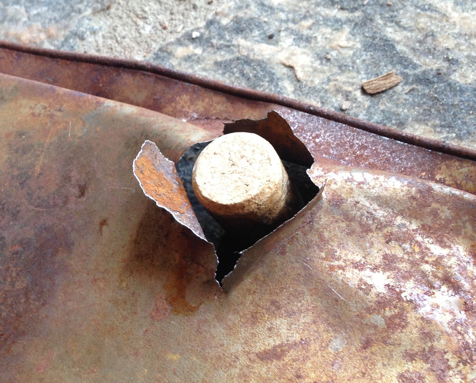

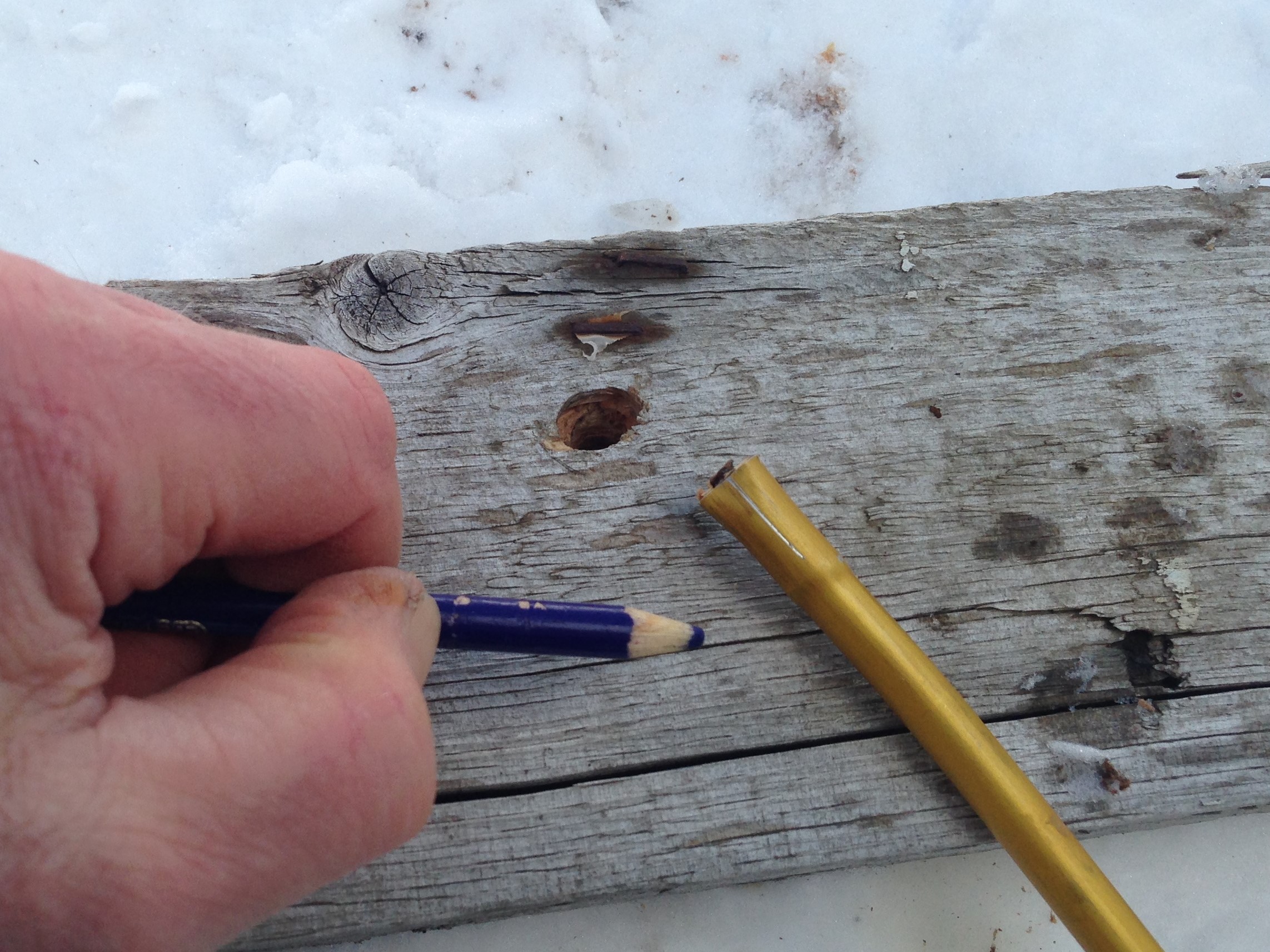

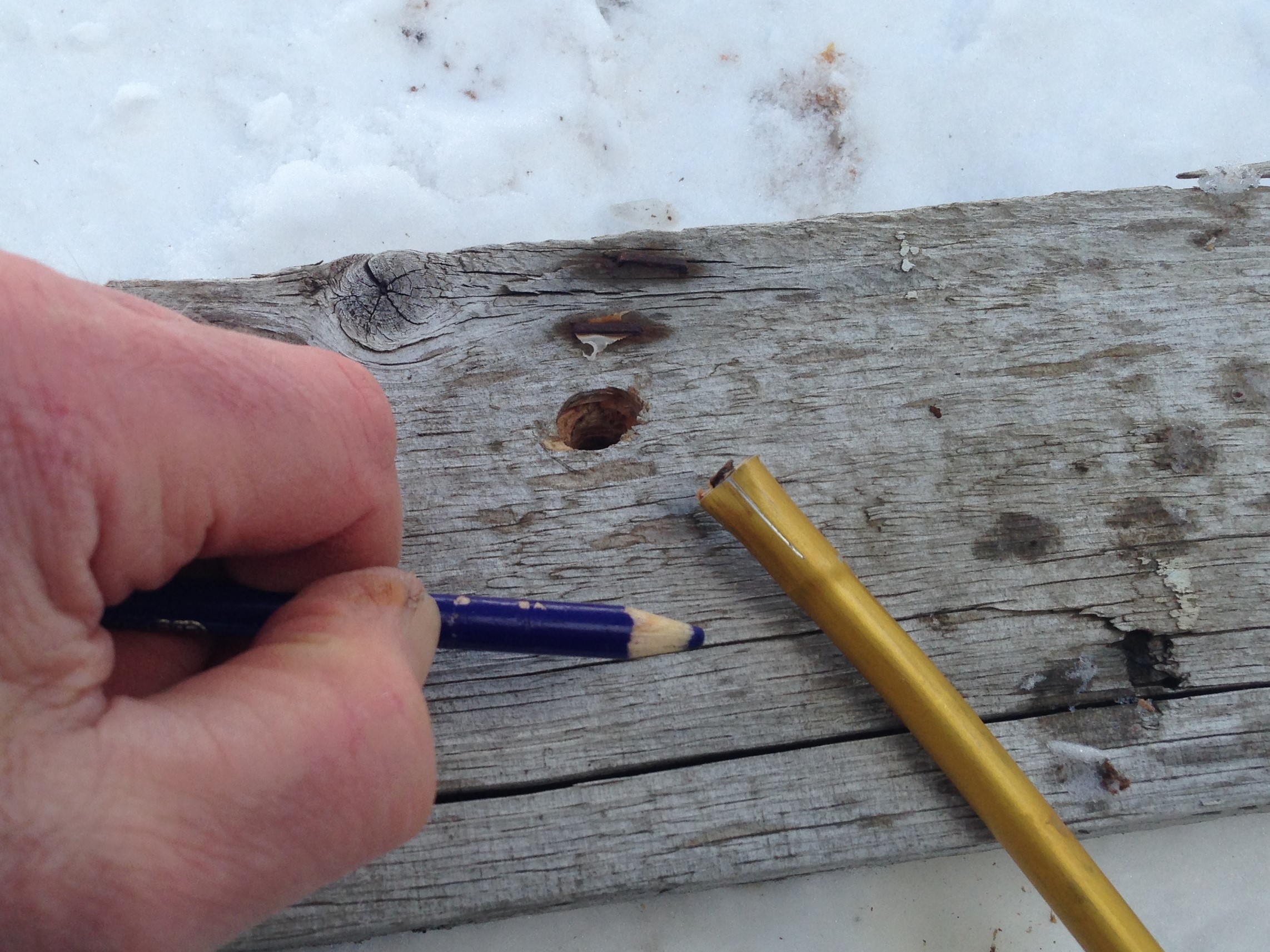

.93 cal by 26 inch screw in barrel, from a dumpster
All shots about 105 psi.
Delivers a 5 gram cork at 560fps !
Heavy arrow plus cork driving wad (650 grains) at 197 fps
There is residual pressure after the shot. Also I was going to compare velocity with the air supply detached but I need to either catch the ammo or make extra next session!

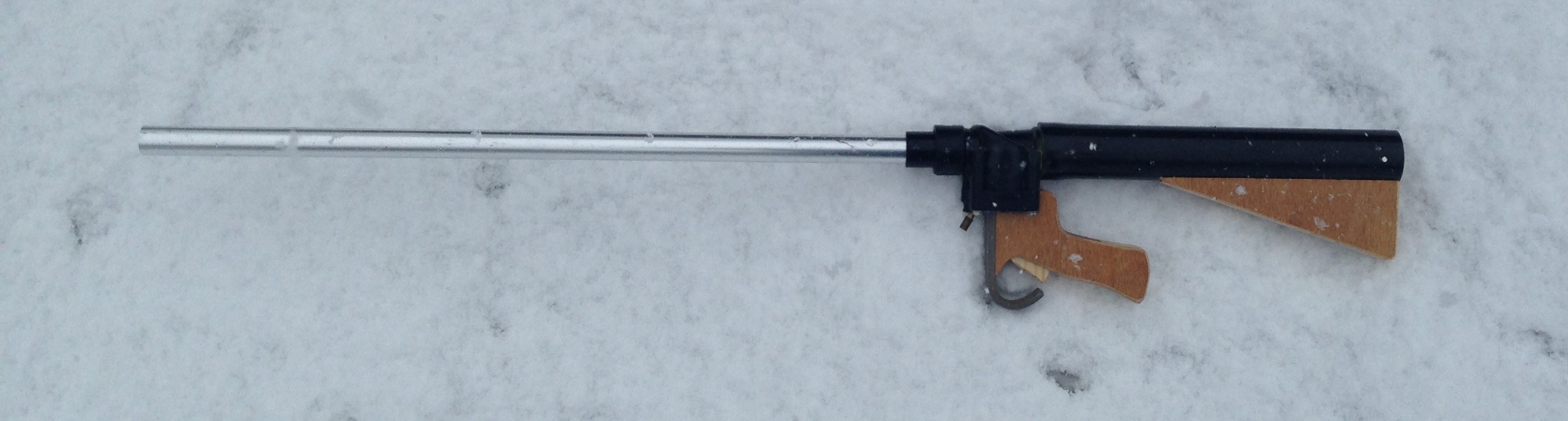

added some furniture
Fairly ergonomic if I raise my right elbow until my arm is horizontal.
Every time I hack one of these together with an assortment of adhesives and fillers instead of fittings and craftsmanship I tell myself it's the last time. It often leaks, and then it gets retired for parts or re-hacked.
