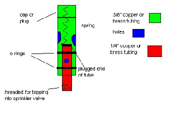

This would work, wouldn't it?

You could easily make a push button trigger for a valve like this.
push button trigger.jpg (16.11 KiB) Viewed 1873 times

Seems a little complicated but yeah, that would work, I'm planning on making a pneumatic with a homemade 3 way valve for the exhaust/input.

Seems over-complicated for what it is,just use a one way brass valve if you want to make a push button valve. I made one on my cannon, which is cheaper than a blowgun. http://spudshot.com/Forum/viewtopic.php?t=35 I have used the valve for a sprinkler exhaust.

It doesnt look that hard to make but ive been rigging up my trigger from my spray kit.
