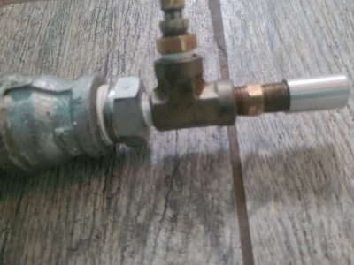

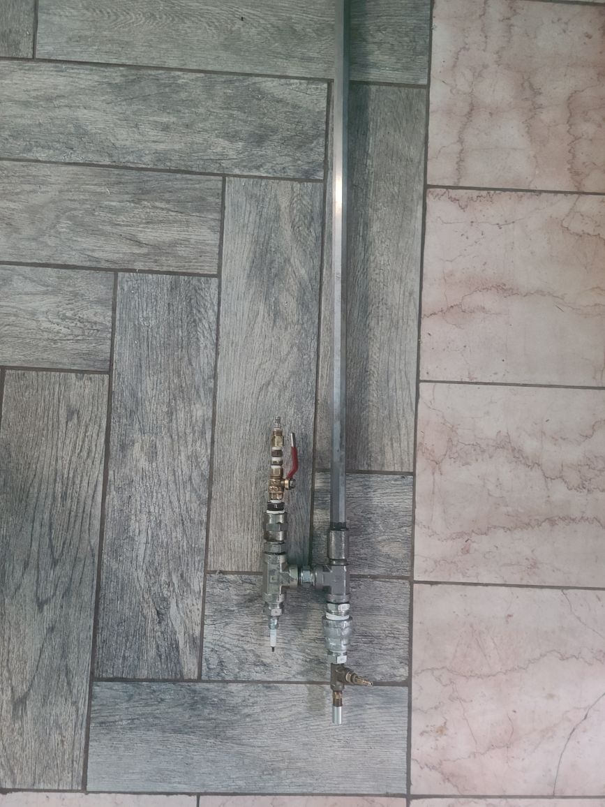

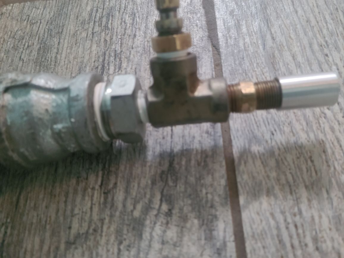

So I've put something together, its a hybrid clone of my phenumatic rifle. Right now they share a barrel but it will get its own dedicated when complete.
For the time being I have had a few successful test shots at 10x using the chart from the forum. They are hard to repeat. But I have had some success.
The gun is made from hydraulic pipe with a work pressure of 3000psi I feel like I am safe to push maybe 50x??
Questions
1• how high would you go on hydraulic pipe?
2• how accurate are the gauges we use for metering?
3• can you ignight a 50x mix with a spark?
4• how to achieve reliable fueling?
5• most cases of a failure i get some smoke out of the chamber when venting, so partial ignition? Am I lean or rich? I am using a 0-300 psi gauge at the moment and it has no resolution.
Let me hear it guys? What do you think. I insist on achieving super sonic.

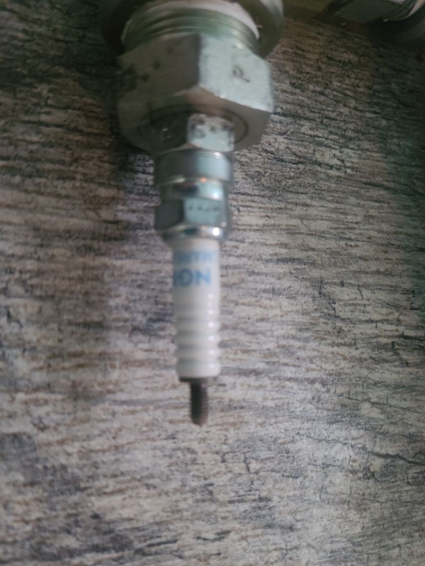

Are you using a burst disk or is there a piston? What are you hooking up to your spark plug?

So the gun has a piston valve.
If you have seen my other rifle, this is a clone.
The only difference being a venting pilot valve, a spark plug, and the piston does NOT have a check valve.
Because of the identical construction I can use the rifled barrel on both of my projects.
My miss fire issue is due to mixing the fuel, at least this is my conclusion.
Regarding 50x and compressed air, my understanding is that by increasing the pressure you increase the available oxygen? How does the oxygen stop getting pumped into the chamber?
I was on the forums many years ago. I credit larda for getting me into hybrids. Watching that thing punch a hole in 1/2 steel plate was something els. He did use a heated wire, something like a glow plug.
I say 50x because a 10x air/propane yelled significantly less damage than my phenumatic rifle at 3000psi. Same barrel, same ammo.
I cant have a phenumatic that out performs my hybrid
Thanks guys, this place is great!

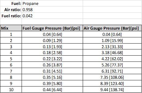

I have been using the chart posted in the forum, I haven't done any calculations.
For 10x 6.44 ~6.5 psi propane
138.74 ~ 140psi air
Are you saying I need to subtract 15 psi?
So 6.5 and 125?
138.74 ~ 140psi air
So 6.5 and 125?
I’m a scientist; because I invent, transform, create, and destroy for a living, and when I don’t like something about the world, I change it. ~Rick Sanchez.
The table you are using seems to account for this, with the air gauge at zero for 1x.
One thing that might be throwing off your mix is the volume of the pump between the launcher and the pump's check valve, can you measure the volume of the hose?
Basically once you connect the pump the propane from the chamber is going to flow into the hose and dilute your mix.
