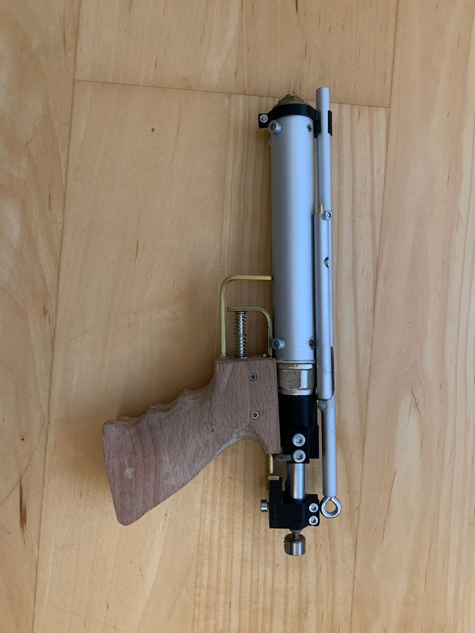

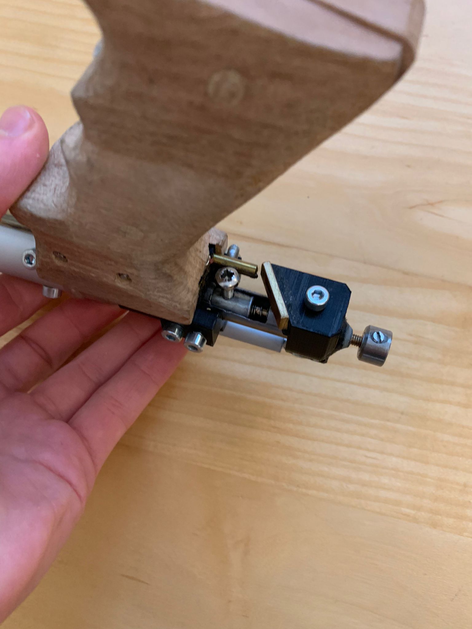

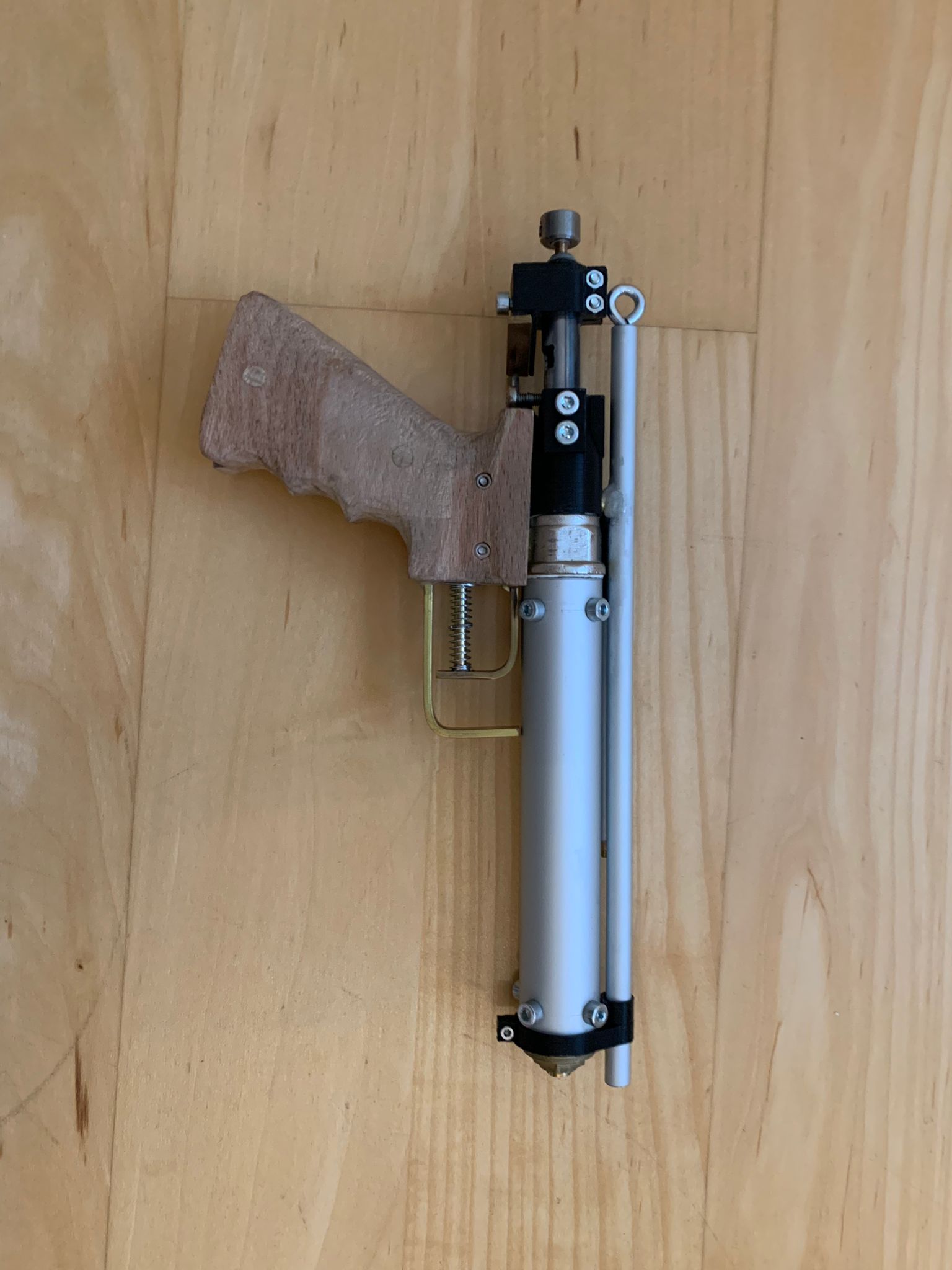

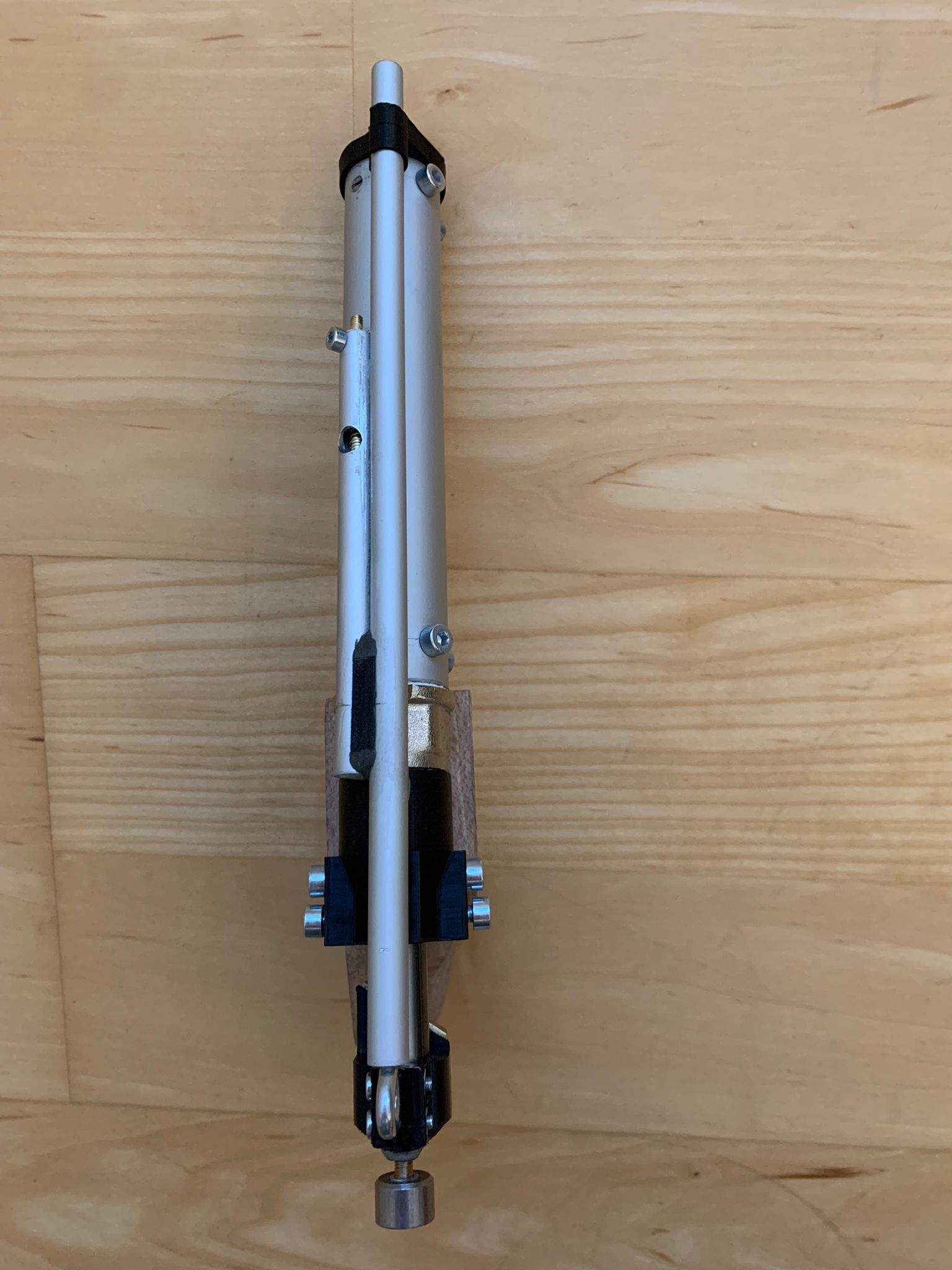

Finally my Semi-Auto Pistol project is finished to my liking.
It runs on green gas (@12Bar) using a 2-stage trigger with a sliding hammer mechanism actuating the valve.
It has NO BOLT, it is using a internal 11 shot magazine, that is sealed with the barrel.
It has around 1.2J of muzzle energy and feeds reliably with the occasional double feed.
Feel free to ask questions.

Very clean, I'm guessing it's a double-action trigger and a simple "tee" bolt?
My Fionda works the same way.
