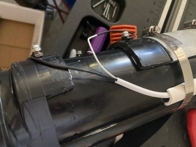

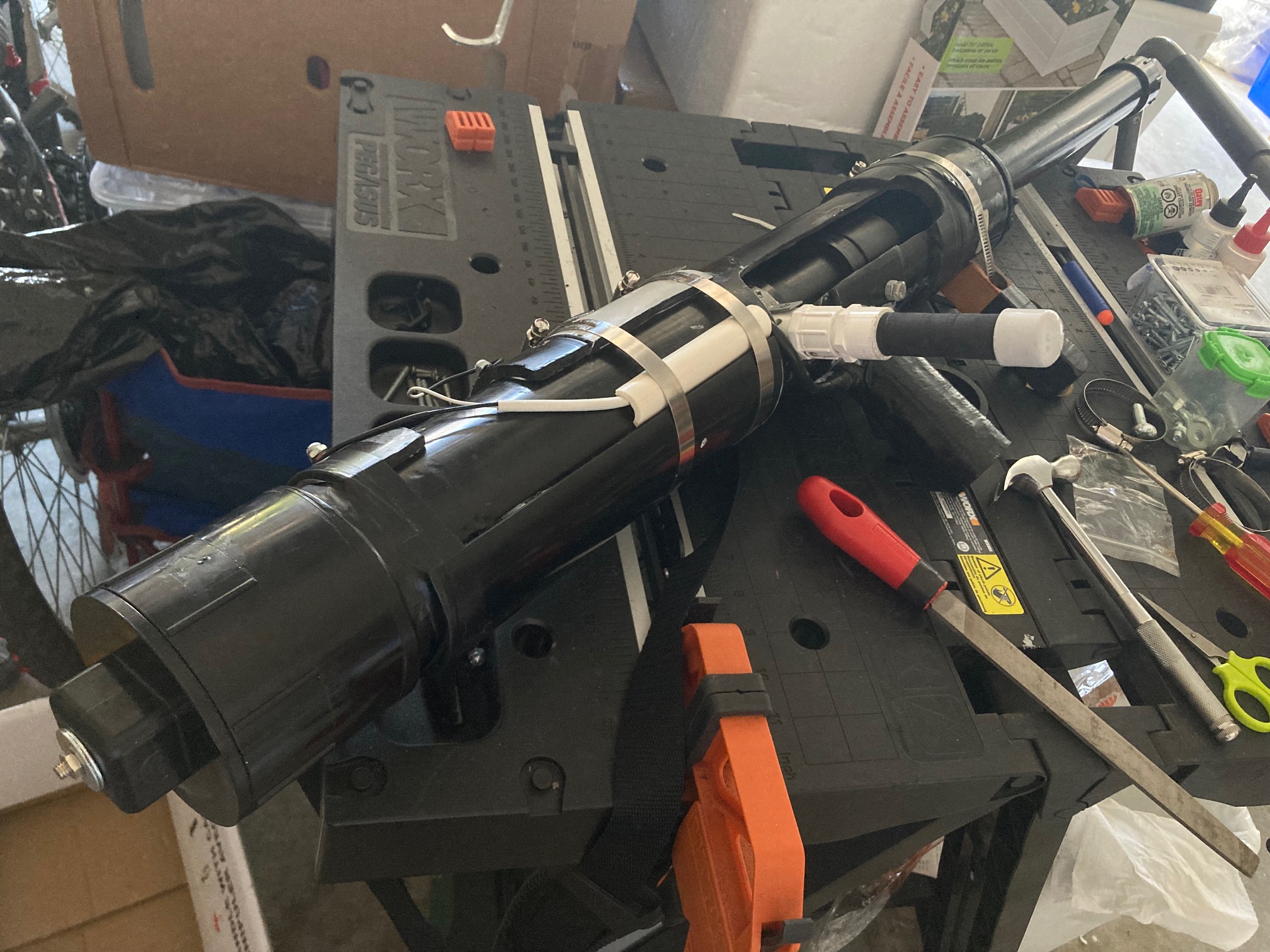

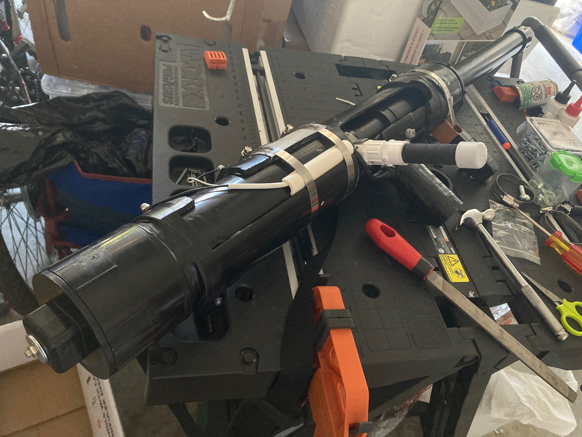

Hey all, I am building a combustion potato cannon for a school project, a 1.5 inch ABS pipe based cannon (yes I know, pretty risky seeing how people see dmw ABS with its pros and cons here, also because I made the mistake of not researching beforehand), posting about it to get feedback and criticism on it, areas where to improve and all that. :D

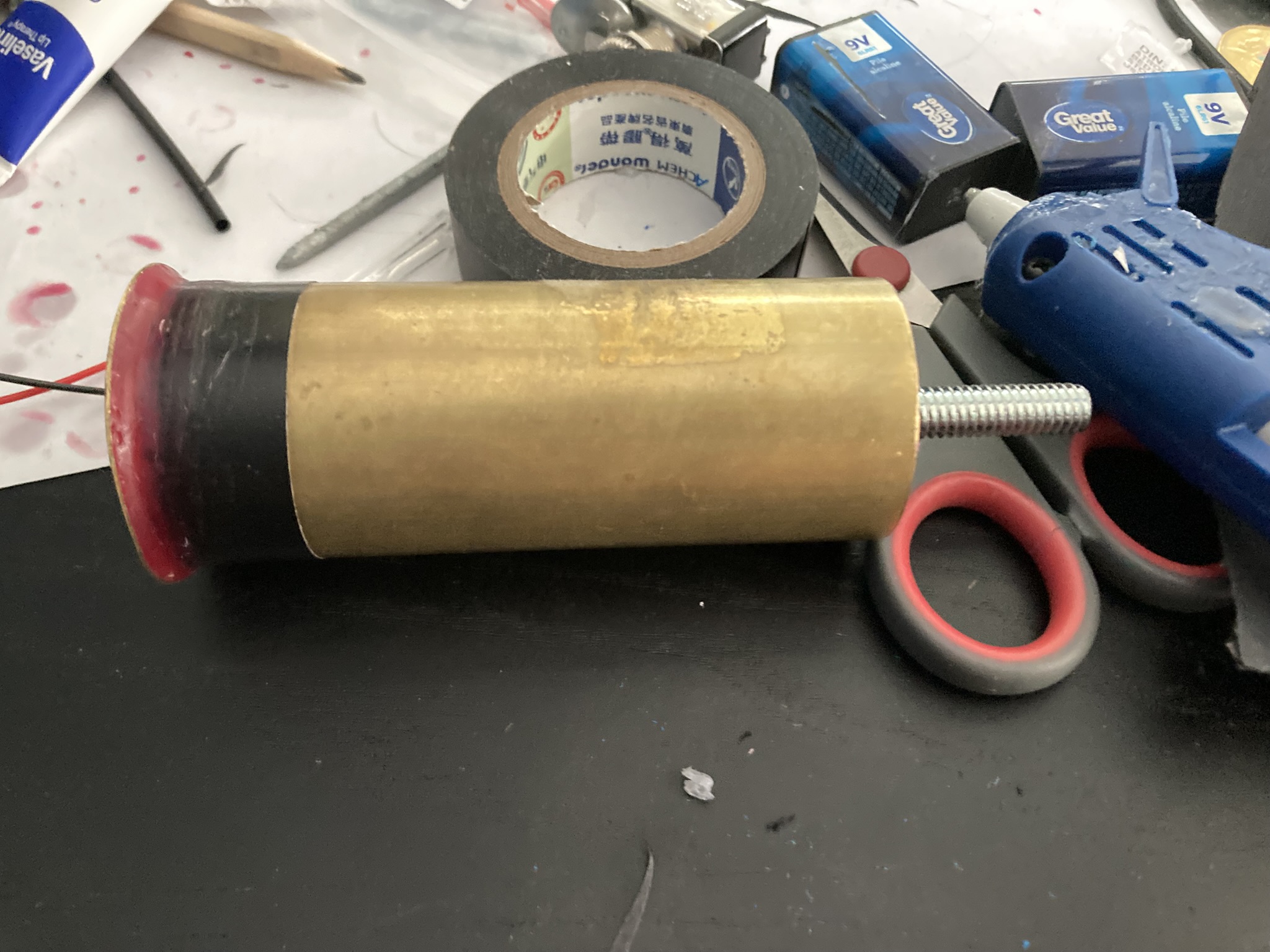

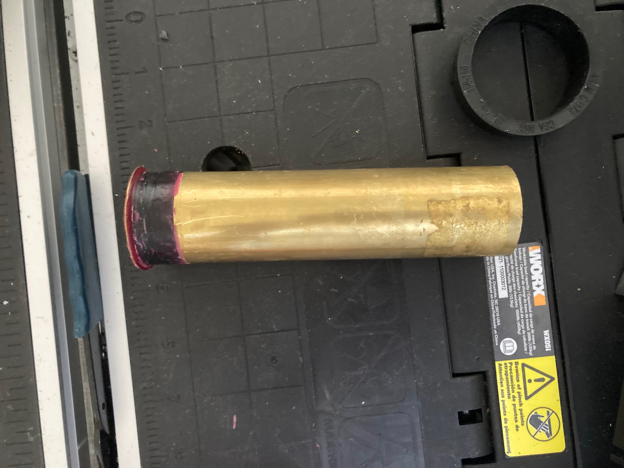

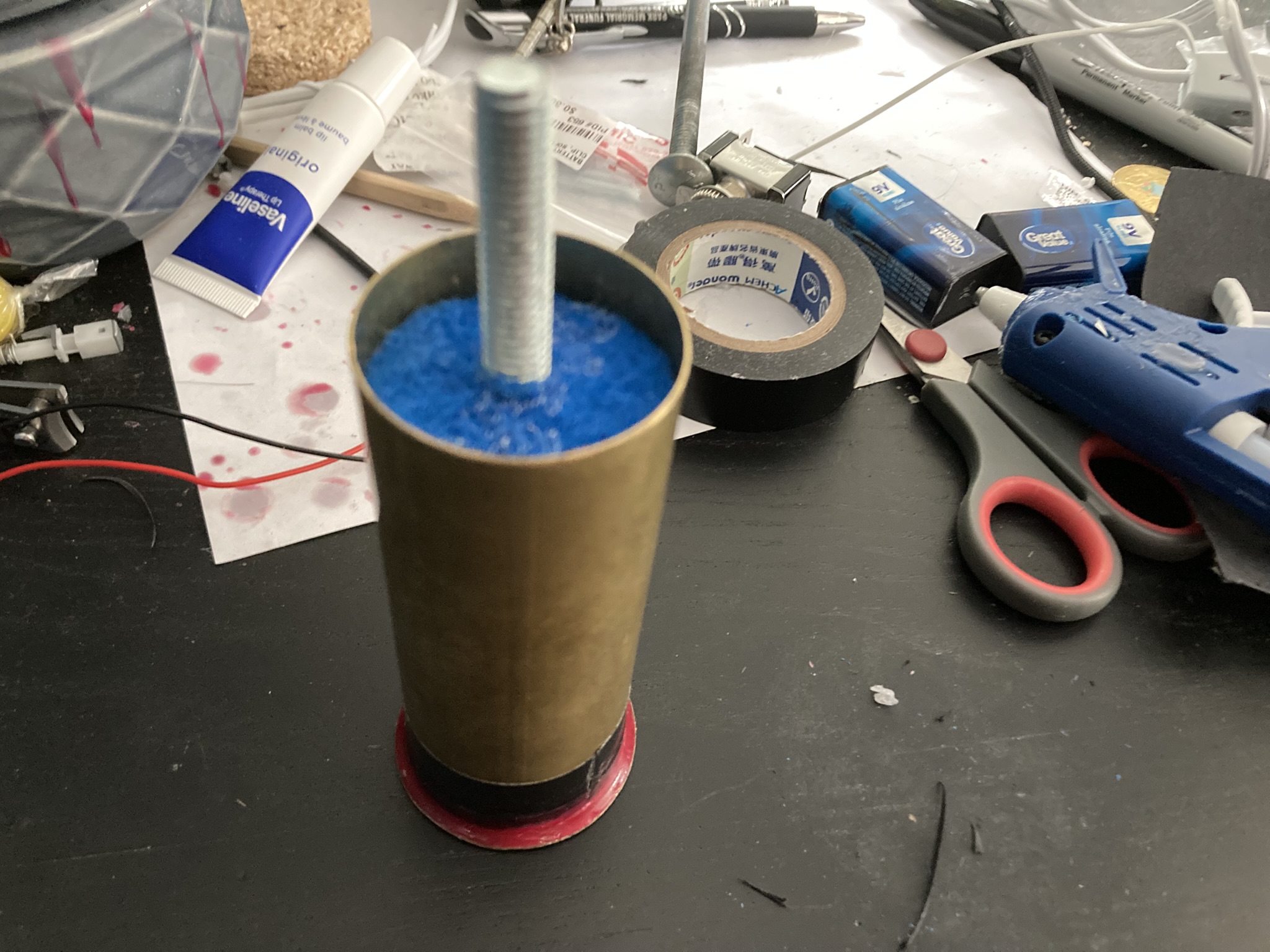

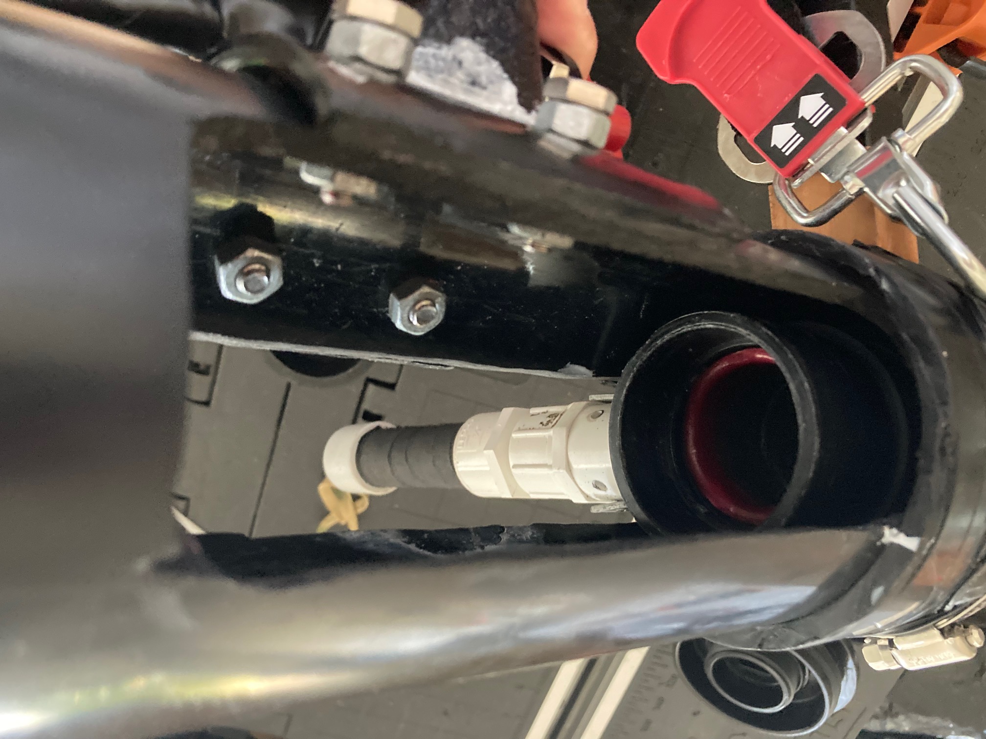

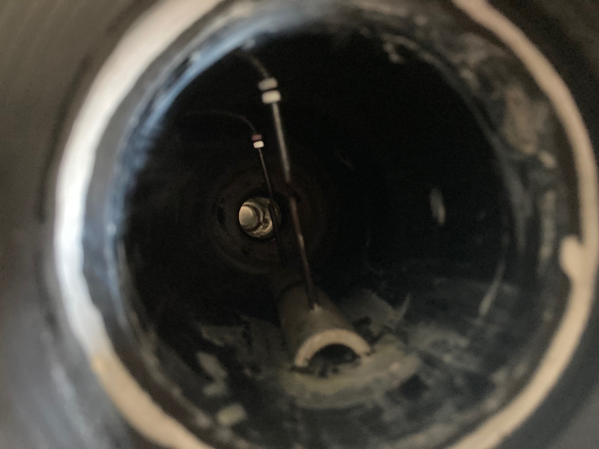

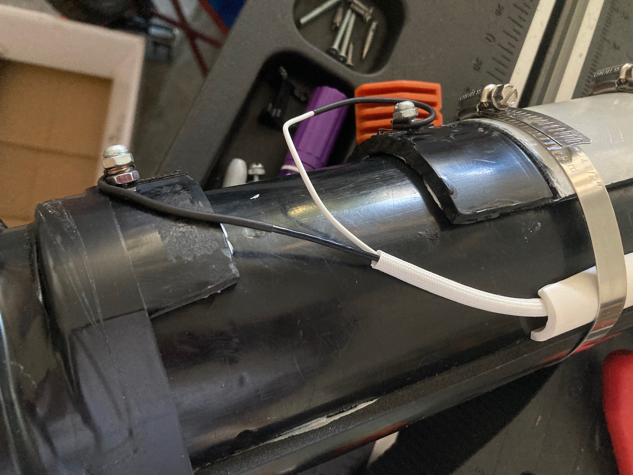

Cannon uses a brass "shell", also known as the 1.5 inch brass fitting I found in the home depot plumbing section, covered the lip area with wax and electrical tape to keep in the pressure so the gas doesn't escape, along with heat shrink on the wires to keep it from fraying, 2 points of ignition for more power, and of course, the "bolt" of it, the floating barrel just simply sitting there with Vaseline applied to keep it's movement smooth, handle and the layering I've added onto it required me to apply heat and bending it to shape, thankfully had a p100 mask my dad gave me beforehand incase of fumes, even when I did it outside
Planning to add a fan and possibly a gas injection system for butane, to make it more 'advanced'
Also credits to this man for inspiring me to build this thing, aka Auxiliary on this site, basically built a shoddy version of his :)
Overview, don't mind my messy worktable, will eventually come around to clean it... maybe :oops:
Wires wrapped around 8-32 machine screws

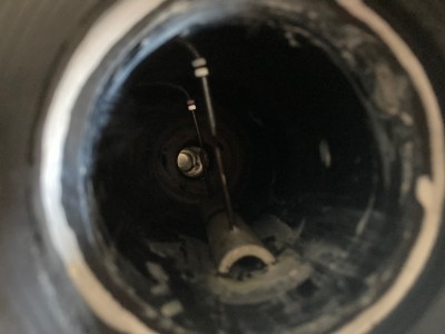

Combustion chamber
Open bolt
Brass shell
Open bolt 2

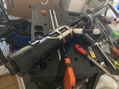

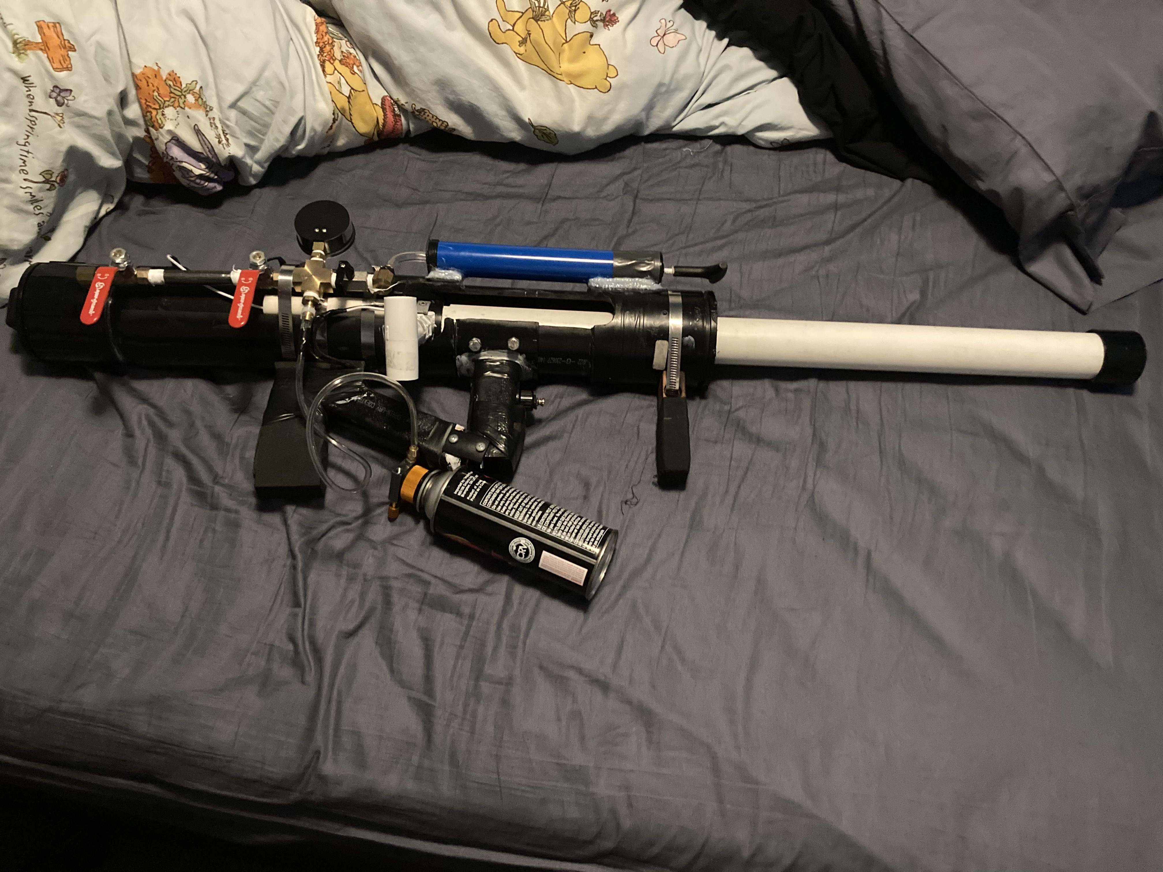

Regardless, the current cannons design,

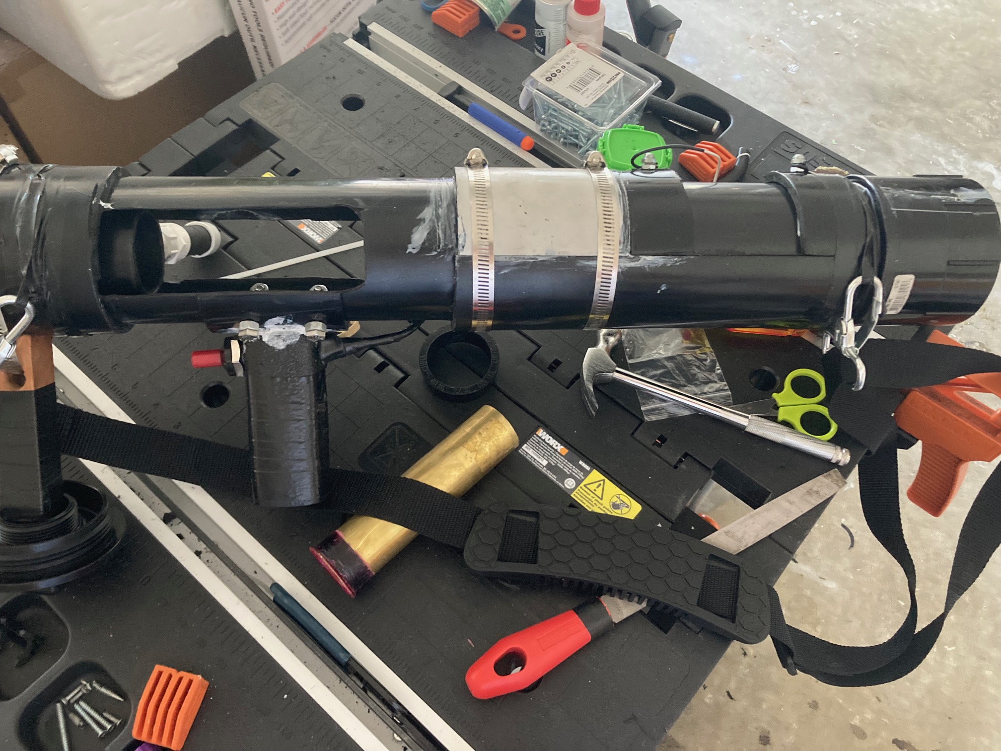

New stuff: gas metering and injection, the thing is a fairly small but it works well regardless at 20-40 psi worth of butane, found just 1-2 injections makes pretty good launches, crude as hell 'thumb hole grip' that's literally being held by a hose clamp with a L bracket screwed to the grip under the clamp, new trigger that replaces the old big red button one for a 1.5v bbq igniter that automatically sparks when pressed (something I salvaged from my schools auto shop scrap yard from a grill :) ), and a air pump, purpose of it is to get air inside incase of a misfire because of a lack of oxygen, had to drill out the nozzle of it to make room for the vinyl tubing
Few more stuff is new electros, went from 8-32 machine screws to 10-24 ones, new 18 gauge wires taken from a broken washroom mirror light, extra cut coupling solvent welded onto it to make it more sturdy, and make it... look less flimsy, no fan as of it yet, because I done goofed up and shorted it by getting too curious with batteries, lets just say; don't directly shoot 16 volts into a 12 volt computer fan with a drill battery :lol:
Had on it on my bed since I had to get my hot glue gun to attach the air pump onto the cannon, hot glue gun being in my room and couldn't be bother to bring it to my garage (not like there would a nearby outlet anyway lol)

Thanks for the comments! The cannon performed nicely when I went out back to shoot a large paper cone type of dart and 3 cut russet potatoes, found the optimal mix is filling the cannon 3 times or 30 psi of butane, air pump worked as expected and 'troubleshooted' the misfires :)

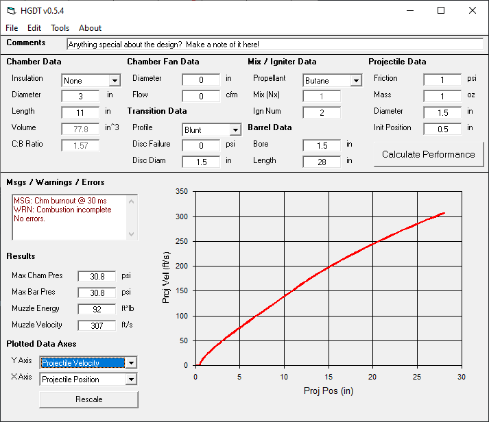

Finally got around to plugging in the supposedly right numbers to hgdt, life being life and just being distracted by stuff :)
Not entirely sure if the stats are right considering I have disc data on it and just shoot cut potato's from a brass tube in the barrel, despite it clearly just being a regular combustion cannon, hopefully doesn't goof it up

Nice cannon! Any plans for using that threaded adapter on the end of the barrel?

Nah, it just there for more or less show but, the muzzle end is chipped when my dad gave to me from his workplace, so I grabbed a spare piece from a box of parts I have and attached it, maybe not all for show then, even seems like it affected how the sparks left my cannons barrel, giving it a little spin :D
Possibly though, thinking of doing a 'conversion' mod for it where I can screw a 1/2" pvc barrel in it, not much practicality in it but I have multiple spare nail rounds from my first potato shooter (which I had to repair countless times), plus it seems interesting and fun to do
If I do end up doing the little modification that I can just screw off and put back on, I'll be sure to post it here :)

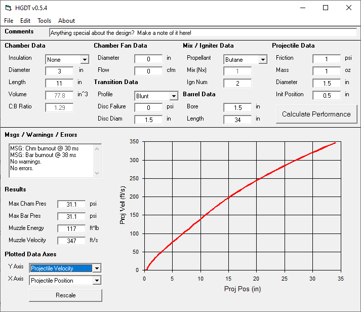

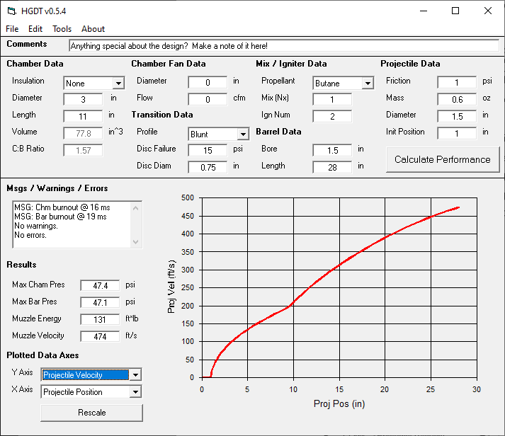

Techexical wrote: Fri Dec 13, 2024 1:49 amNot entirely sure if the stats are right considering I have disc data on it and just shoot cut potato's from a brass tube in the barrel, despite it clearly just being a regular combustion cannon, hopefully doesn't goof it up
You need to "trick" HGDT for combustions by putting disk failure at zero and the disk diameter the same as your barrel inner diameter

As it turns out it goes at 320-ish feet per second or 97 meters per second, still pretty solid for a second build, especially when I load it with a dart round or regular spuds still mauling a rotting tree stump
However for the incomplete combustion issue, I could just add an extra 6 inches of barrel, going from 28 inches to 34 inches, which would bring it to 350-ish feet per second or 106 meters per second, won't be doing that for a while since my school project (being this potato cannon) is coming pretty soon after winter break and will be presenting it to my classmates, and already blew crap loads of money on a hho generator project in school too, at least I know mc master carr and metal places around my area are pretty good... :D
