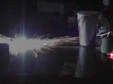

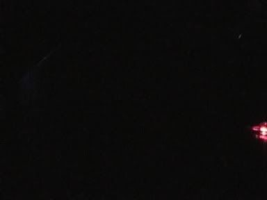

I know this thread is old but I think that the spark would be great for spud-guns! Just look at this, I charged up the capasitor and touched the posative and negative to this metal ruler. Look at these pictures.
Before.
0.08 seconds later.
Very bright and hot. It burns little dents into the ruler. But the spark wont jump because its too low in voltage. Still very usable.

You "touched" the ruler... that means you didn't get an open-air spark.I charged up the capasitor and touched the posative and negative to this metal ruler.

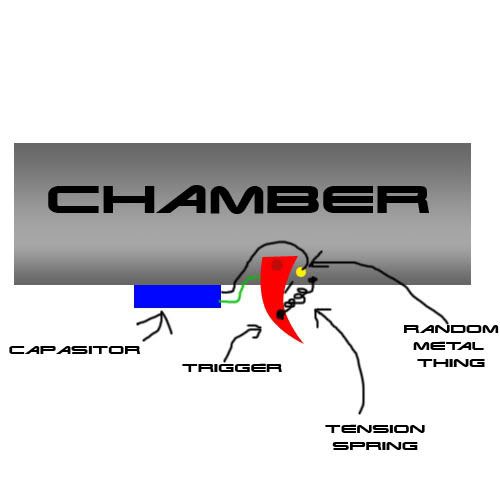

Does it have to be an open air spark? I don't think it does. It just means you will need to make the trigger a bit more complicated. Here's my diagram.
I hope it makes sense. Ohh and the black thing between the trigger and the chamber is a bolt or something like that just to stop the trigger being pulled back to far by the tension spring. The darker red bit on the trigger is the pivot-point. It the 2 things coming from the capacitor are the positive and negative.
When you pull the trigger it will touch the random metal thing. (the yellow circle) and well.... BOOM

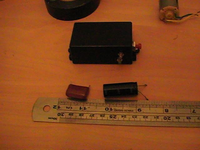

That's how big the capacitor is. (The cylinder one) and the black box behind it is what I use to charge it. It took the transformer out of the camera and put it in the box with a battery and a button. Those 2 bolts you can see are the positive and negative. Its fun to give to people and say the button is really clicky. Hee hee. Its like 350 volts I think. (The charger not the capacitor. I have no idea how many volts that is.
