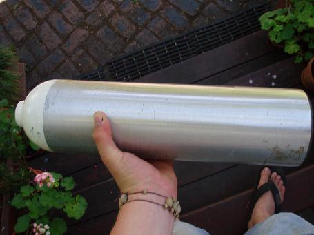

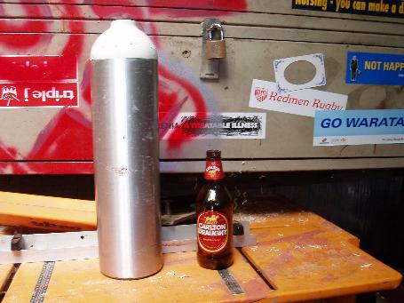

I have been toying with the idea of using an liquid oxygen bottle as a chamber for a hybrid cannon.The bottle is rated to 12,00psi and thus has a burst pressure of around 30,000psi the walls are 14mm thick alloy of some sort(aluminium but not sure what type)It has an internal volume of 3000cm3.I plan to make this a burst disk hybrid and use a metal union one with bolts and nuts just like 2 plates screwed together.I have pictures but mum took the camera to work.I plan to run this at a 6xmix and maybe oxygen enriched mixtures aswell.I plan to get suppersonic speeds and have proof of them from a chrony.One problem is the ignition were should i have the igniton and how many points of ignition should i have?I was thinking have a spark plug mounted in the bottom on the chamber.Any ideas on this cannon to improve it would be great.

You could take the tank and get the head cut off, bored out appropriately to 2-7/32", and tapped to 2" female NPT threads. Then, you can connect whatever kind of union you want with male threads.
