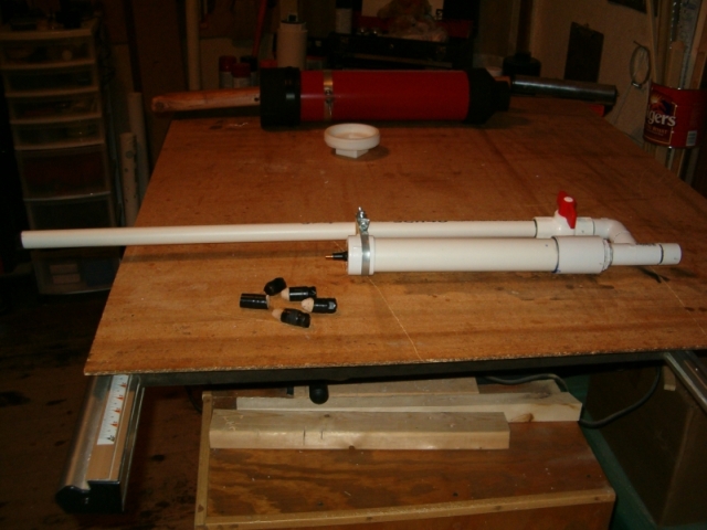

This is my first pneumatic that actually works. I got a bit crazy with the primer, and it dripped all over the place. Its chamber is 1 1/2in by 7in and the barrel is 3/4 by 30in. The ball valve is 3/4 inch and is solvent welded onto the cannon.

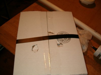

Damage to a cardboard box.

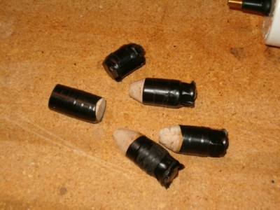

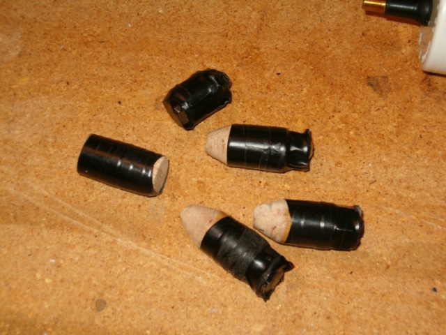

The ammo I use.
The ammo I use.
The Whole Gun
The Whole Gun

what are thoughs bullets made of, they look awsome, like really .45cal

i think they're cork wrapped in black duct tape. they fire really well with my pocketrocket. nice cannon

that it the coolest ammo ive ever seen, and it looks like its perfect for indoor use since it cant even shoot through a cardboard box. what psi was it pumped to when u shot the box??

Very Cool gun(simple and basic). Like the bullets to. The gun would be cooler if you used a sprikler vavle. Walrus i looks like it went through the box on the picture.

i dont see a full pierce just really big dents, and also loking at that again, did he use thoughs big rubber tire valves that take a 3/4" hole?? i used to use thoughs, i hear they are dangerous.

I can't use sprinkler valve because they are not available in my area. The bullets are wooden dowels with nuts (hehe) on the ends to give them wieght.
The tire valves do go in a 3/4 in hole, but I *cough*made them fit*cough* in a 1/2 in hole. I don't see any safety issues with them.
The bullets did not tear a clean hole, instead they left a flap where they went through.
