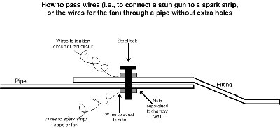

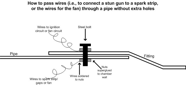

I was pondering a way to run wires (for instance, from a stun gun to a spark strip or the wires for a fan) through the wall of the combustion chamber without unnecessary holes.
I'm building an over/under combustion with a ball valve to vent the chamber. The reducer and ball valve on the back of the chamber are going to be attached to the chamber with screws - not glue - to allow for chamber maintenance in the future. So I came up with this idea. It's pretty self-explanatory. Let me know what you think.

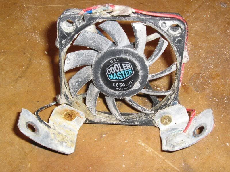

Thru bolting is the way I did it in my gun.
The "feet" are lead coated copper.
Residue on fan from deoderant.Image

Thanks for the tip!
Does a gun using deoderant get that hot?

The way you got it looks good. Just put some sealer to the threads so it stay air tight.
