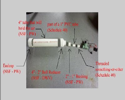

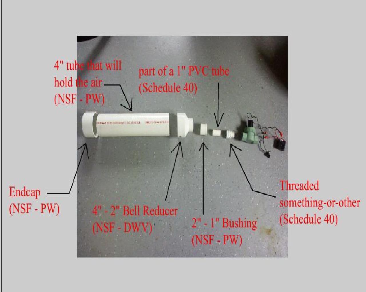

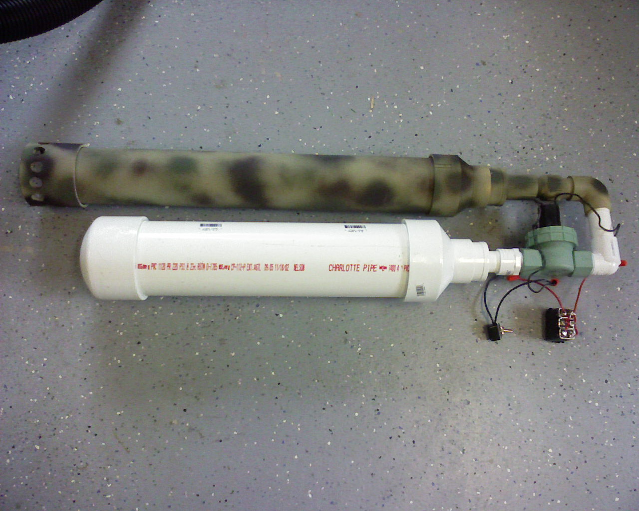

Ok, I saw a 2005 post that alluded to this question (so i'm really not trying to be a post whore) , but I'm still not sure o.O ... I already looked on NSF.org, and they said that the difference between NSF-PW and NSF-DWV piping is that "-pw" means that you can hold potable drinking water in it, and that "-dwv" means that you can't. So, I posted a question or two yesterday and got some great responses that my bell reducers were NSF-DWV and that they were not safe. My question is: What is the actual difference? also, what should I use instead of a bell reducer? (I couldn't find any bushings large enough) I plan on going by a plumbing supply store...would they have properly pressure rated bell reducers there? I will attach a picture (the second one) of my parts leading from my pressure tank to my valve. (and another one of my paint job i'm so proud of.) Please give this cannon builder some much needed advice

nice cannon. I think you should mod the sprinkler valve and then strap the chamber and barrel together so it's not all wobbly. Your probably not done yet though so never mind. Next time I would put the sprinkler valve on top so there is less dead space.

As for the Bell reducer there is a saftey issue wiht the socket depth,it isnt nearly as deep as a coupler and reducer socket depth that is were the weakness is.
But nice lil cannon might sugest a whole camo paint job and modded valve

You have the right idea, but not quite there. DWV stands for "Drain, Waste, Vent". The designation means the pipe is designed to be used in gravity-fed systems. This means that the pipe is rated for a maximum pressure of about 10psi. It does not mean that it fails catastrophically, as indicated by your post.keep_it_real wrote:I just went to nsf.org and this is what it said...

You're correct about the "-pw" rating on pressure rated pipe. The pipe you have, the "-DWV" pipe is not designed for any amount of pressure higher that what gravity produces on liquid in a drain application. Bell reducers, because of their shape are typically not pressure rated (although pressure rated bell reducers can be special ordered from some companies). As a rule, expect your local hardware store to carry pressure rated PVC components up to 2" in size but beyond that, DWV components are the norm. However, a plumbing store (for example, the one you're going to) will likely carry pressure rated PVC as large as 4" in diameter.
Regarding non-pressure rated components, these are typically thinner than pressure-rated pipe and fittings and hence are cheaper to manufacture. This means they cost less to buy, but you get what you pay for, right? When purchasing PVC, look for the rating NSF-PW. It is usually followed by a pressure rating such as 200psi (for 4" pipe) or something similar. Beware of pipe without a pressure rating, as this would automatically make it DWV, regardless of how thick it is. Socket depth (how far you can push the pipe into a fitting) is less than in pressure rated fittings as well.
I would suggest using a bushing as an alternative to your bell reducer, as they are pressure rated. Don't worry about not being able to find one PVC manufacturers make them in a variety of sizes for pressure applications.

Thanks for all the tips! I did some research and found a wholesaler near me, and they showed me all the differences and such. As for a bell reducer, they're unsafe unless you get them in schedule 80, which are like 25 bucks each
so I just went with a 4" schedule 40 bushing that takes a 2" bushing and then connected that to the other stuff pictured. The 4" bushing is connected to my 4" pressure tank with a coupler. I just finished staining my shoes purple / cementing the parts together, and i'll be sure to post a pic in the showcase when it's all painted.
