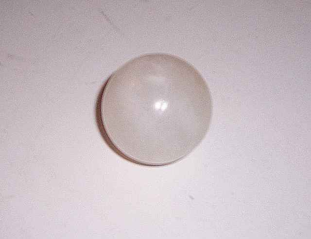

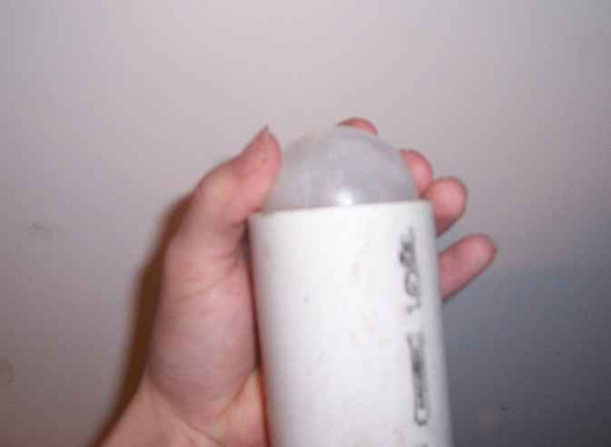

4. cut the wax into a rough sphere, make sure not to cut middle down any, as it will become a smaller diameter than your pipe. Soften the wax in warm water if necessary.

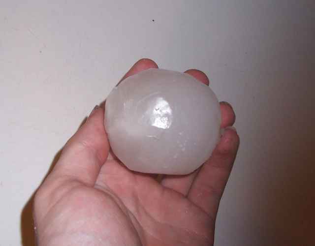

5. Take your rough sphere and roll it around on the end of your pipe. Allow the edge of the pipe to slowly shave off bits of wax until it wants to fall into the pipe. This may take some practice, but if you do it right you should end up with a nice, nearly perfect sphere. save your wax shavings, as you might need to use them later
6. make a cylinder of wax about 1/4 the diameter of your ball (no bigger than half an inch), and 1-2 inches long it doesn't have to look good, it will only be used to make a channel for the metal to be poured into.
Attach this cylinder to the ball by heating one end with a lighter until it drips, and then just stick it on and hold it in place while it cools.

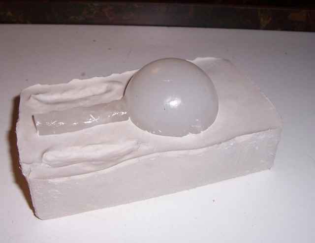

Then spray the ball down with pam and lay it down into the plaster until it is EXACTLY half buried.
9. Now you need to make grooves in the wet plaster with your finger(see the pictures below), this will help the halves line up when you are ready to cast metal.
Let the plaster harden.

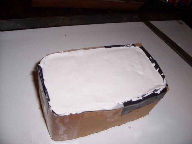

F. tape cardboard to the sides of the mold to form a box to pour the other half of the plaster in. Spray the inside down again with pam and go to step 10.
10. mix the other half of the plaster the same as the first batch and pour it in, making sure that it is worked in to every small detail of the mold.
Let it harden overnight

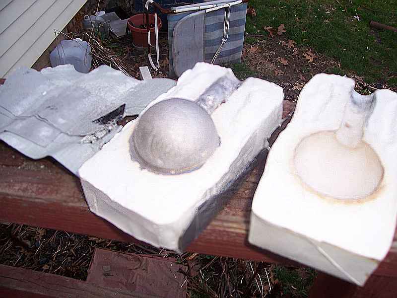

11. You should now be able to separate the two halves relatively easily. If you have done everything right you might be able to remove the ball without damaging it so it can be reused.
DON'T PANIC if your mold has little air bubbles in it. You can always fill them in before you bake it.

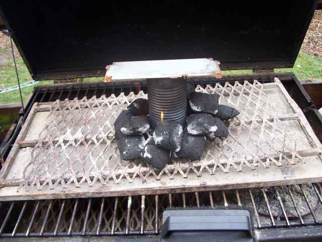

14. Now you are ready to cast the metal (lead, in this case).
Do this OUTSIDE; none of the gasses that come from molten lead are good for you. Wear a respirator/gasmask if you have one.
There is a good tutorial on casting lead at http://www.spudfiles.com/forums/viewtopic.php?t=6613& , which uses a portable gas stove to melt lead. I did mine on the grill.
Heat the lead up in the soup can and use your pliers/ tongs to pour it in(Are you wearing your gloves and safety glasses???)

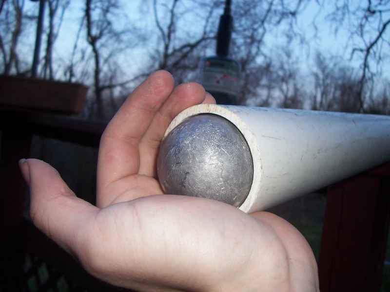

15. After the mold is fairly cool remove the tape and open it gently. Unless you waited a really long time, it will still be hot but you can pick it up with tongs/heat-resistant gloves and dunk it in water.
Now just cut off the extra lead with your saw and file, and smooth out any rough spots (Keep track of where your lead dust is falling, it's really bad for the environment)

picture of step 4.<br />this is the rough sphere I cut.
picture of step 4.
step 5. shave the wax off by rolling it on the end of the pipe.
what you should end up with after you shape the wax in the pipe.

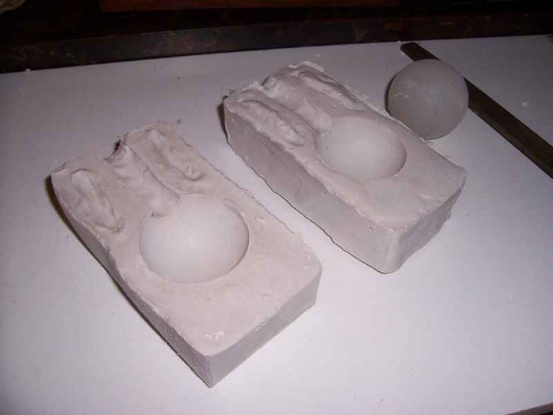

one half of the mold after it dries

step 10
step 10
step 11, after the mold separated.
Yeah, thats how I melted my lead. I dont really recommend this though.

The finished product. mine ended up being about a mm smaller than my barrel.
