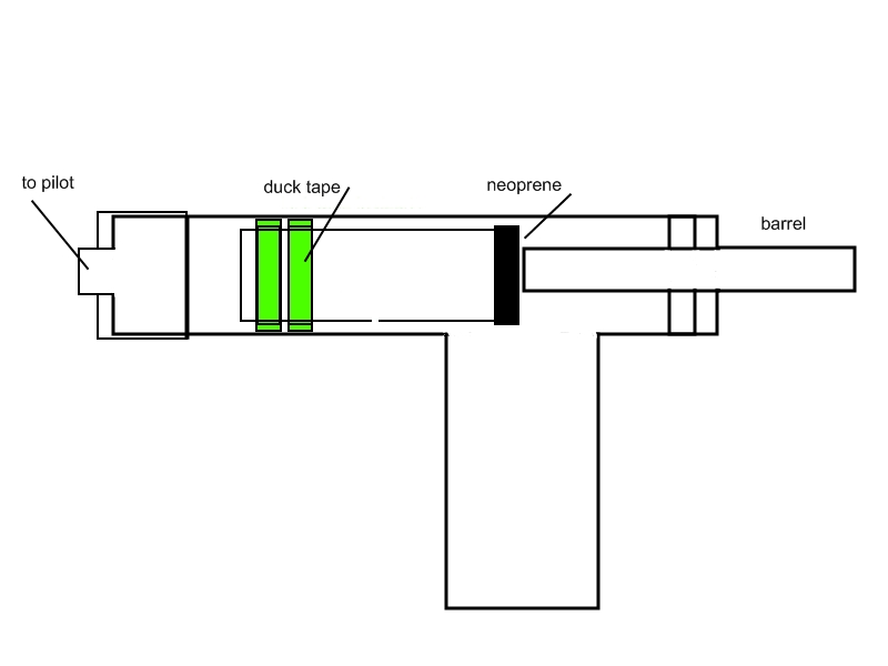

ok i know there are hundreds of posts like this but iv searched and cant find anything
but iv built my first piston valve and and it seals and holds pressure but wen i vent it (through blowgun) the piston it doesn't pull back right up until the end of the pressure and it only lets a tiny tiny bit out
plz can anyboby help me
oh and my chamber is 400mm of 25mm, barrel is a 500mm 6mm, and the piston housing is a 25mm T

chaos
Posts: 1205
a blowgun will do it i have proved that.
its will end up being the pilot volume and the seal between the pilot volume and chamber/barrel seal.

joannaardway
Posts: 949
Location: SW Hertfordshire, England, UK.
Naah. Electrical tape would work much better than duct tape for those purposes. (referring to the picture)
Or you could try modding your blowgun.

chaos wrote:a blowgun will do it i have proved that.
i wouldn't use duck tape seeing as it can stick to the pvc somtimes.
chaos
Posts: 1205
ok thnx i suppose it would be better with electricle tape.
i only used it in the pic coz that is what he has been using.
