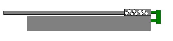

I meant something like this (the green bit is a solenoid valve - excuse the crappy drawing, I'm at work at the mo)

OOOh I see... I was thinking like you meant a cloud golf gun where the barrel was at the top...... Oooh okay I might use that design then..thanks.. Haha don't worry about the drawing...It got the point across thanks...Have you ever built one? Just wondering.

As far as I can tell, in your original design the GBs will be blown backwards and the air will flow out of the barrel - unless the air flows past them until it reaches the back of the magazine then flows out through the barrel, but while all this is happening it seems to me you're just wasting a lot of air.

K...Darnit, I just want to figure out that design....even just to see how it works..So your design will work correct? Like no jamming?
