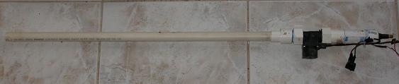

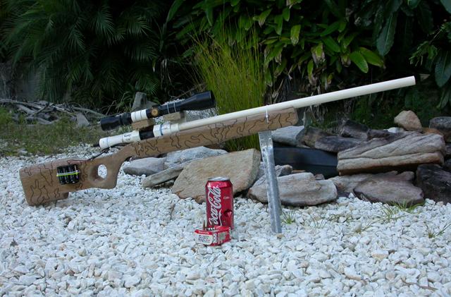

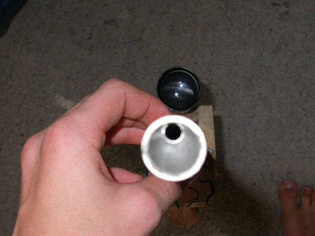

It may look small but this cannon packs a punch. I designed it to ba be a nice, quiet plinker. The chamber is extremely small and that means that it only takes two pumps from my big bike pump and around six from my small pump to get it to a decent pressure, even though I mostly use my propane pneumatic fill setup now.
Here are some specs:
-20mm x 10cm chamber (tiny I know)
-6mm x 65cm barrel
-20mm sprinkler valve
-Handmade wooden stock
-Nikko 3-9 x 40 scope

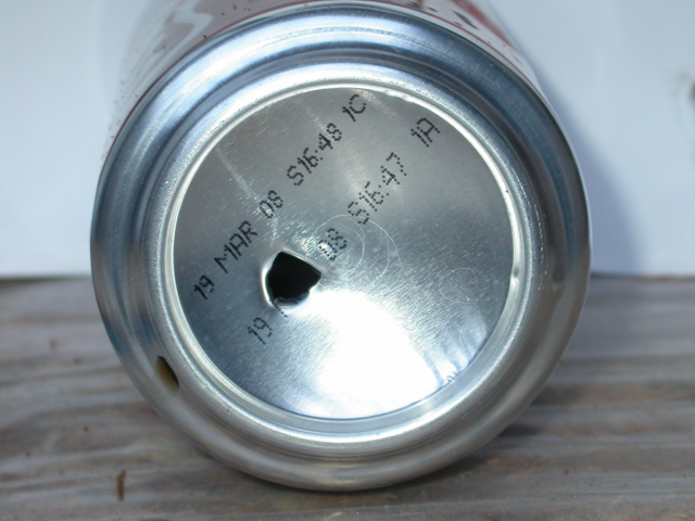

Coke can from around 5m, the front was severly dented

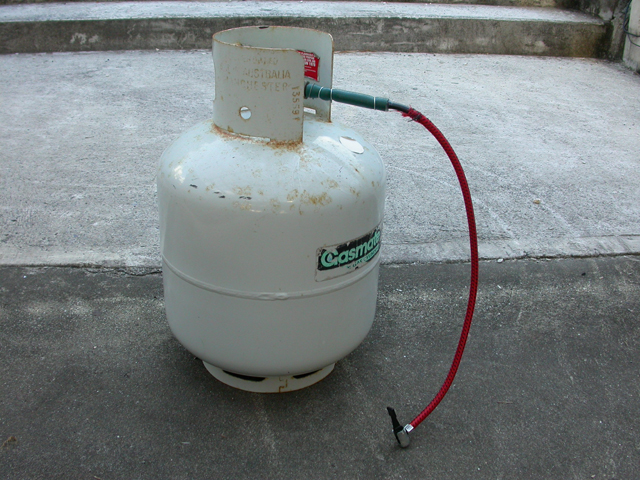

Propane pneumatic setup

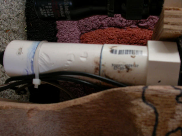

Chamber
Chamber

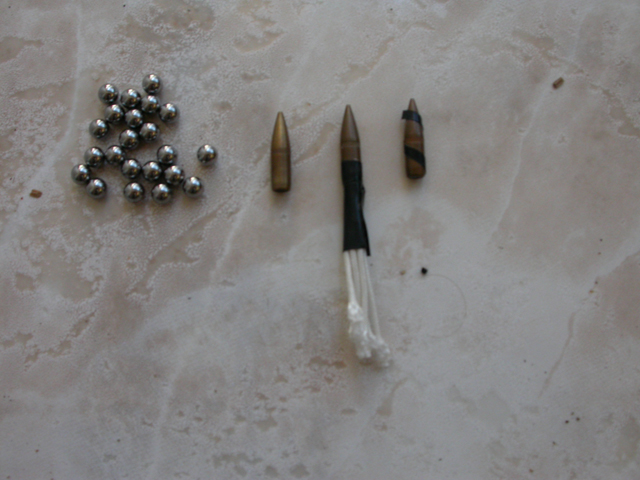

Ammo (left to right):Steel BB's, .224 FMJ, .224 FMJ with stabilising tail, .224 FMJ with tape 'rifling' to induce spin
The business end
The business end
The action
The action

that is such a sweet gun i love it the barrel and friends just need a coat of paint and it would look insain
great job on the engraving

How do you know how much pressure you're putting into the chamber?
FreakyShotGlass
Posts: 114
Joined: Fri Dec 02, 2005 6:34 pm
You can work out the pressure of propane inside your chamber using this table.
Around here it is probably averaging 20oC this time of year do I am getting around 110psi.
I'll put up a thread this weekend on the propane setup.

when you fill does your chamber actually contain liquid propane from being compressed?
FreakyShotGlass
Posts: 114
Because there is a 20% (I think) vapour space in the tank there shouldn't be any liquid in the chamber, because most of the expanding is done in the tank only vapour should come out.

What colour do you guys reckon I should paint it. I'm thinking either Woodland Camo, Urban black or a Walnut stain. The barrel is gonna be either Matte black (cant go wrong) or I might try Woodland on the barrel as well as the stock.
integral
Posts: 204
Joined: Fri Mar 09, 2007 11:54 pm
Location: Aussieland
Paint over that wood-burn job...? I was just suggesting that you paint the barrel but if you are going to give the whole thing a paint... woodland would be the best. Although I do like the burn pattern you did so personally i would go the stain and give the barrel a matte balck. GOGO before submissions close!

You have inspired me to build myself one of these. how accurate is it with those bb's? they look like 1/4 inch steel slinghsot ammo but then your an aussie so......... those might be illigal there
i found on mcmaster .25 cal high polish steel bearings for 5 bucks (.0001 in tolerance) and for 20 bucks 48 inches of stainless steel tubing with a .251 ID. (tolerance, .001 inches). i have a feeling this will make my gun quite accurate. im thinking a piston valve, however, but i really like that wood frame yuve got on that. might have to steal that...... KIDDIng. ill make myself something different. but otherwise, this gun is what i like. small calibre, high power, and realistic.

Seeing as your chamber is so small, there is ample space for another. Have you considered putting a second chamber behind it with another valve? :idea: That way you could get two shots per charge.
