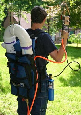

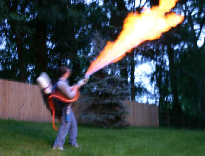

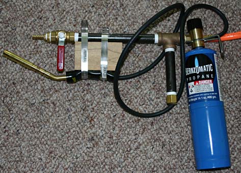

Like any red-blooded, masculine man of the male gender, I love PVC weaponry. You should too. If the concept of heading on down to the local Home Depot and transforming $100 worth of random pipe bits into a killing machine doesn't appeal to you, you're a goddamn pansy. Also, you're probably sane and will live significantly longer than I will. Nonetheless you disgust me, and I take comfort in the knowledge that your obituary will be nowhere near as humorous as mine. For those of you who laugh in the face of hypersonic shards of plastic puncturing your spleen, here's an intimate look at how I've kept myself busy for the past week: building a PVC flamethrower. If you're not interested in the building process, skip to the bottom of the post for the fire. My flamethrower has two main parts, a gun/hose assembly, and the tank. I made the gun first: It's made entirely of parts you can get at your average hardware store. The hose connects to a stop valve, which connects to a short pipe nipple that's tapped directly into the tank. The tank took a while to make, because I let each set of chemical welds dry before doing the next ones. The ends of the tank are two 90° elbows and two 90° street elbows, welded to make two full 180° "U"s. One side of the tank is a 2' length of 4" sch.40 PVC, the other is a 4"x4"x1.5" T with standard pipe attached to each 4" socket. Before assembling the parts, I drilled and threaded the two holes I needed in the tank ends: a 1/4" standard pipe hole for the outlet to the hose, and a 1/8" standard pipe hole for the valve that I would use to pressurize the tank. Interesting note: 1/4" and 1/8" pipes have no actual relation to the measurements of distance commonly known as the quarter inch and eighth inch. The holes are actually 7/16" and 11/32" respectively. Hooray for non-metric measurements. Next step: cement one end of the tank: Then the other: After the tank dried, I dredged up an old camping backpack to hold it. I cut a hole in the bottom of the pack and screwed the gun/hose assembly into the base of the tank. Finally, I screwed in the Schrader valve (tire valve) to complete the tank: Now the whole rig was ready for some pressure testing. Since I would soon be running the distinct risk of giving myself heat-assisted, deep tissue exfoliation, I was extra-careful to make sure there weren't any leaks. I used up a lot of Teflon tape. And, after filling the tank with water for a trial run, made sure the cleanout cap was on nice and tight before flipping on the air compressor. No leaks! At this point, I had quite possibly the world's most kick-ass super-soaker. Of course, I didn't go through all that effort for a damn squirt gun. So I added a pilot light in the form of a blow torch. Much better! The finished product

that was a thing i got off the net though i wouldn't suggest using a pvc tank I would use a tank from northerntool.com use the 10 gal tank it has a shrader valve in it already. Use some gas pipes as the handle try to put in a few metal one way valves in and use alchol lacquer or gas as the fuel but not propane trust me!!! Also use brenzo o matic for the ignitor .
Thats the guy who inspired me to build my flamethrower. His desighn though consist of more dwv parts then i would be comfortable using so be warned.
