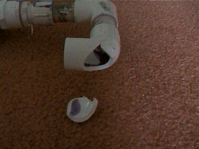

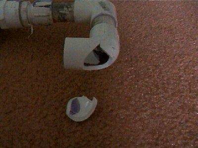

i pumped up my gun to 50 psi and fired it. it was the first time i shot it so i had it laying on the ground instead of holding it. when i fired it a piece of the elbow blew out. if I was holding it would have hit me in the face has anyone else had this problem. it was a 1/2 in Lasco elbow sch 40

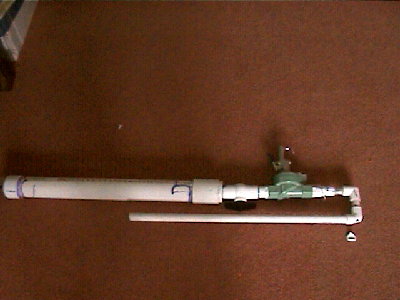

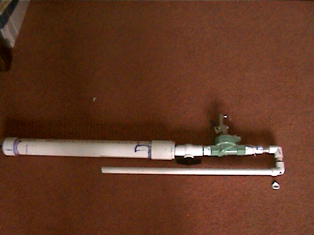

what does the gun look like, is there excessive stress on the elbow

i'll post pics of it tomorrow.

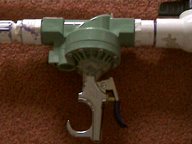

air is also leaking around my blowgun on my sprinkler valve after i get to about 30 psi. i've tried sealing it with everything i can think of but it still leaks

For the blowgun, you did use teflon tape or something similar on the threads, right? If you still have problems, you might check the wiki, or the how-to on modding sprinkler valves. As I've never modded one, I can't really help you. Sorry!

i have tried 4 different kinds of sealant on my blowgun and none keep it from leaking. what is the best thing to seal it with?

The elbow might have failed due to excessive recoil forces (mostly muzzle climb bending the elbow. It compresses the outer part of the elbow, and PVC does not stand up to shock well.). I would recommend putting a connection between the barrel and chamber so that the recoil is more evenly distributed.

About the blowgun... is the leak between the valve and blowgun itself, or the hole where the solenoid used to be?

With that setup, it looks to me like the culprit was definitely stress on the elbow joint. When you fire, the recoil puts stress on that elbow basically bending it slightly outward and placing a lot of stress on that joint, I've heard from people that this is a big problem when you fire without a projectile, was there something in it when you fired?

For sealing the blowgun, take the blowgun out and get all the epoxy off. Glob epoxy all over the nipple and then screw the blowgun in. It should seal up fine. Silicone sealant works even better in this application, but I guess epoxy would work.

IMO, i think it might have been because the valve is placed right before the elbows, the compressed air would have shot straight up hitting the elbows very hard, especially if the projectile was somewhat tight in the barrel, combine that with teh recoil, and the stress on the elbows from the weight of the barrel...but what do i know? im just a n00b...
