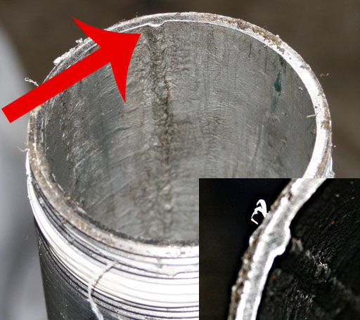

Yeah my current piston is a Coconut Cream can (250ml) that fits PERFECTLY in 50mm PN12 PVC, but not in the steel pipe. I've cast one out of hot glue now, just waiting for it to harden. How long should a piston be?
I've thought about getting a file and removing the first few cm of seam.

Of course you're not making it any stronger but it shouldn't influence the amount of pressure it can take, especially as it's only for a small section.Am I going to weaken the pipe by grinding out the seam?
For a co-axial, piston travel more than 1/4th of the barrel diameter - 5mm in your case - is unnecessary and wasteful.rixth wrote:how far should it travel?l Is 10mm enough? The barrel is 20mm.

Am I going to weaken the pipe by grinding out the seam? (see picture)
Yes that size piston should work fine
You could probably half the piston travel (D4) to 5mm
You may weaken the pipe, but it's plenty strong- don't worry about that.

Don't grind the seam, adjust the piston to the pipes standards not the other way round:rixth wrote:Ok, so piston size:
- as long as the chamber is wide
- how far should it travel?l Is 10mm enough? The barrel is 20mm.
With the seam issue, what I did was...
Jam the piston in a vice, then with one hand hold a set square (to make sure the ruler is straight in comparison with the piston) and then using a dremel with a small cylinder tool bit, I dremeled a small groove into the piston.
It fits perfectly in the pipe's seam.
I don't have a dremel though, and I'd rather not buy one, as I can't see myself using it often... a drill is pretty much all I have sadly.
Hmmm found this http://www.dse.co.nz/cgi-bin/dse.storef ... duct/T4823 might consider getting one if I can justify it.
I'm curious as to why you say modify the piston and not the pipe, is that because of weakening it?

It was made of a PVC fitting, the job can be done with a file in no time as well.
I was going to get one of those dremel but got a Riobi one instead, they are handy in this hobby.
It may weaken the pipe a bit as well, but it would also be difficult to file the seam down evenly and completely even if it only 5cm of it. Without a dremel it may also take awhile. It would be a lot easier just modifying the piston.
