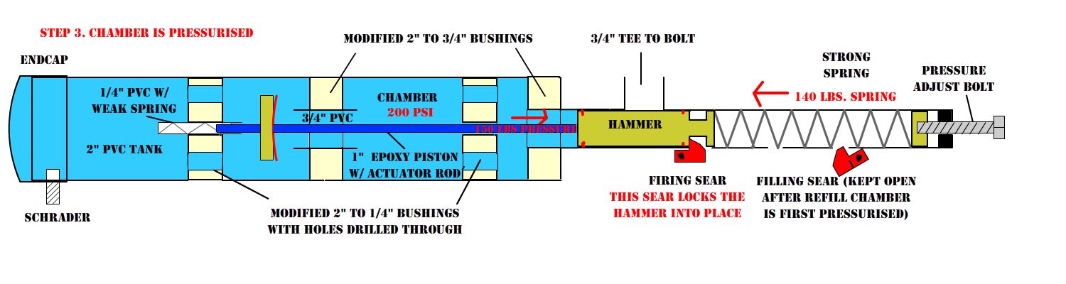

Ok, this is my idea. The hammer would hit the activating rod, which would open the refill chamber, charging the primary chamber. The hammer would be held from opening by a sear. When released, the piston would seal before the hammer releases the air in the primary chamber.
This way, the primary chamber is always fully charged, so there is virtually no delay between trigger pull and firing. The chamber would have enough time to fill, and there is no pilot air lost or air loss from the sear. You would need a heck of a sear to hold the hammer back, (OR a good spring) but that shouldn't be too hard, would it?
You think it would work?
EDIT: WHOOPS! The hammer looks like it is connected to the actuating rod, but it is not. I also forgot the refilling sear. See my next post.
UPDATED MARCH '08
field-legal paintball semi
Hailfire753, I'm not sure I understand how your above design works. It looks like the pistion is blocking the air passage to the barrel. I'm not saying that it won't work because i don't know, but I think the first design was better.
You would need to have more room for air to get past the rod as mentioned above. It needs to fit snugly at two points that so that it isn't rattling around, just not there. I'm not sure how you intend to actually fire this gun. Usually a hammer valve would just release the air. How exactly do you intend for the air to get out of that smaller chamber? It looks like you intend to "fire" the gun just to fill the firing chamber. What then?
If you are happy with a weak gun, just direct the air released right out the barrel through a T. No sense letting it expand uselessly into that smaller chamber.

Opps, in the picture it looks like the hammer is connected to the actuating rod, but it is not. Also, I forgot the refill sear. The mechanism works like a paintball piston.
It goes like this:
1. The weak spring seals the refill chamber.
2. The refill chamber is pressurised.
3. The refilling sear is released, so the hammer slides forward. It is kept open so that the hammer does not catch it when it is cycled.
4. The hammer pushes the actuating rod, opening the refill chamber to the primary chamber. The firing sear catches the hammer and keeps it from cyclying open and reseting.
5. The firing sear is released, and the hammer slides foward from the primary chamber pressure. The piston re-seals from the air pressure and weak spring before the hammer opens. The hammer slides back enough to allow the air through the tee, to the bolt and barrel.
6. The hammer slides foward again, reseting the process. If the firing sear is held open, a high rate of automatic fire is achived. If semi-auto fire is desired, a mechanism is used to only open it briefly.
7. To refill the chamber the refilling sear is released and the gun is fired. The hammer would catch the sear, which would prevent it from cycling and opening the piston.

Still, why that smaller chamber? You're just giving your tiny burp of air room to expand and do virtually nothing. You also have to realize that you need to have quite a blast of air to push the hammer back and fire the projectile. It will run out so fast that the potential for even semi-auto will be limited to very few shots. It may still cycle well as pressure drops since the valve will be easier to open and should stay open longer which may regulate shots fairly well.
- Hailfire753
- Posts: 348
- Joined: Thu Jun 28, 2007 11:50 pm
- Location: Near Philadelphia, PA
My valve is for a regulated CO2 paintball gun, so air is not an issue. The "smaller" chamber is the only chamber. Its like the piston chamber on the GB semi. The refill chamber is for exactly that, to refill the chamber for semi/auto shots. Maybe I don't understand what you are saying. Also, in the new valve, there is no "burp" of air. The piston stays open
