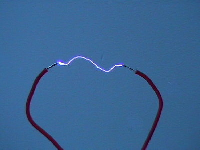

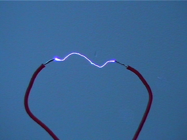

Well, I've accomplished the first and most simple setup. This is the tube switched ignition coil. Basically, all I just did was wire the primary of the ignition coil in series with the lead coming off the "ground" end of the flash tube. I left the ionization plate intact and taped behind the flash tube to maintain function, so all you have to do is trigger the flash and the current will flow through the tube and then through the coil. The only modifications to the photoflash circuit were the coil wired in series coming off the flashtube, and a toggle switch wired in place of the shutter switch, (two thin leads of metal that touch together when shutter is triggered).
The setup and a picture of a spark that came off the coil are below. My estimate is a 3/2 centimeters spark gap, which would ballpark the voltage around 30 kV, from what I've read. Moreover, this would allow a 3/8" spark gap in a hybrid with a 4:1 compression mixture.... The picture's a little grainy, because I took it from a video, of which my camera does not take very high quality.

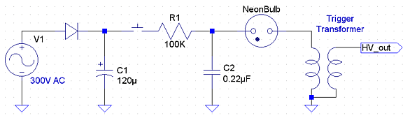

I wonder if you could replace the 0.022uF cap with say a 0.22uF cap and boost the trigger voltage and current enough to get it to be useable as an ignition system?
I suppose if you dumped the 120uF/300V photocap through the trigger transformer you would fry the tansformer. Sounds like a fun experiment.
I wonder if the circuit below would work to (1) boost the power of the trigger voltage (but not the voltage) and (2) make the trigger fire repetively instead of just once.
- From the left side of the schematic;
1. 300V poser source, diode and photocap allready on the photoflash board.
2. Add a push button switch, 100K resistor and boost the capacitance of the trigger cap.
3. Use a neon bulb as the trigger.
4. Use the trigger coil fromthe photoflash board. - cyclic_trigger.gif (10.92 KiB) Viewed 2748 times

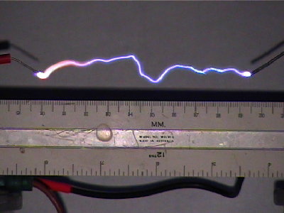

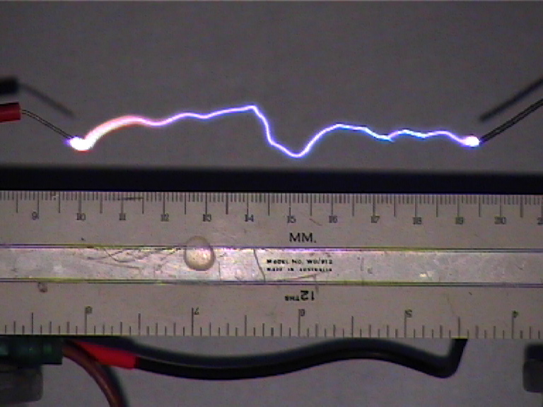

I did some playing round with these circuits a while back, I wrote a wee how-to on using one to make a spark, it's floating around in the how-to section somewhere.
Just done with an SCR. Simple, safe, reliable.
50mm sparks from one cap.
90mm sparks from same cap with two coils.
