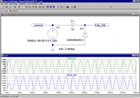

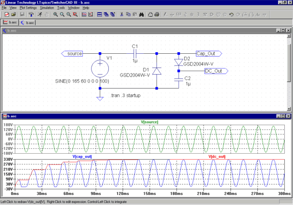

As far as I know a single cap and a single diode does not form an AC to DC voltage doubler. With a single cap and a single diode you double the AC voltage but you still have AC and the cap's voltage swings from -AC to +AC (see the attachment "A").
To double AC and get a DC voltage you need at least two caps and two diodes (see the attachment "B"). This is gives a single stage of the standard "voltage doubler" circuit.
I don't see a DC doubler capability in the various schematics for the photoflashes. The peak voltage on the cap is generated by the transformer, not a doubler or similar circuit.
Voltage doubler, AC to DC.
AC voltage doubler
AC voltage doubler
