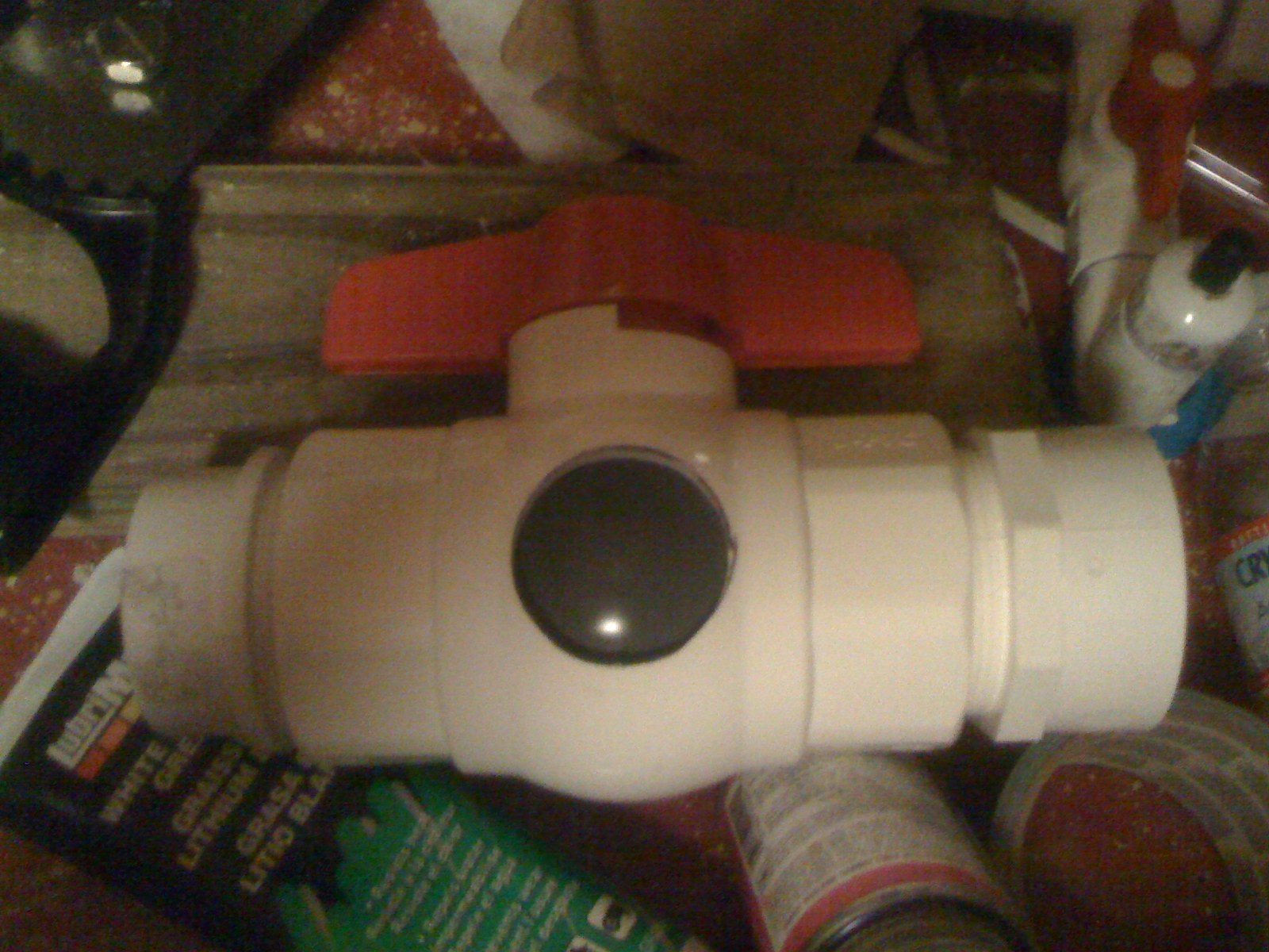

heh, the only part ive actually made already is that valve. used a 2" ball valve, which is why the 1.5 SDR is inside of it. works perfectly, except its really tough to turn it from the close position. I think i'm going to add an arm on to make it easier once its actually on the gun.
The 1.5" is sleeved in 2" pressure rated on both sides, saftey i guess? even though its supposed to be ok. I've only ever worked with pneumatic and its not fun when they blow up unexpectedly.

Correct Ford, the ball valve does have a smaller hole than the pipe. That will leave you with a little more rethinking...
EDIT:
If the 2" works, but is hard to open, put some vasoling on the ball of the ball valve while it's closed. Then open and close it a few time and it will open as fast as you can turn it. :)

Nice job lining up the golfball hole with the valve hole...looks perfect from the picture. Did you use a forstner bit and a drill press to drill it?

i used something like a forstner, its ancient though not as spiffy as they are now. but it was a tad small, widened it a little with a dremel
havnt got a drill press though, had to just do it by hand. marked a dot in the center by eye and drilled a pilot, got lucky i guess.
EDIT: looked it up, called a holesaw lol, i actually think its the same one as in the picture on wikipedia

JET47 wrote:i used something like a forstner, its ancient though not as spiffy as they are now. but it was a tad small, widened it a little with a dremel
Actually a holesaw may work better for this application. You did a good job with it!

JET47: That mod'd ball valve was beautifully done. The gun looks very good.
