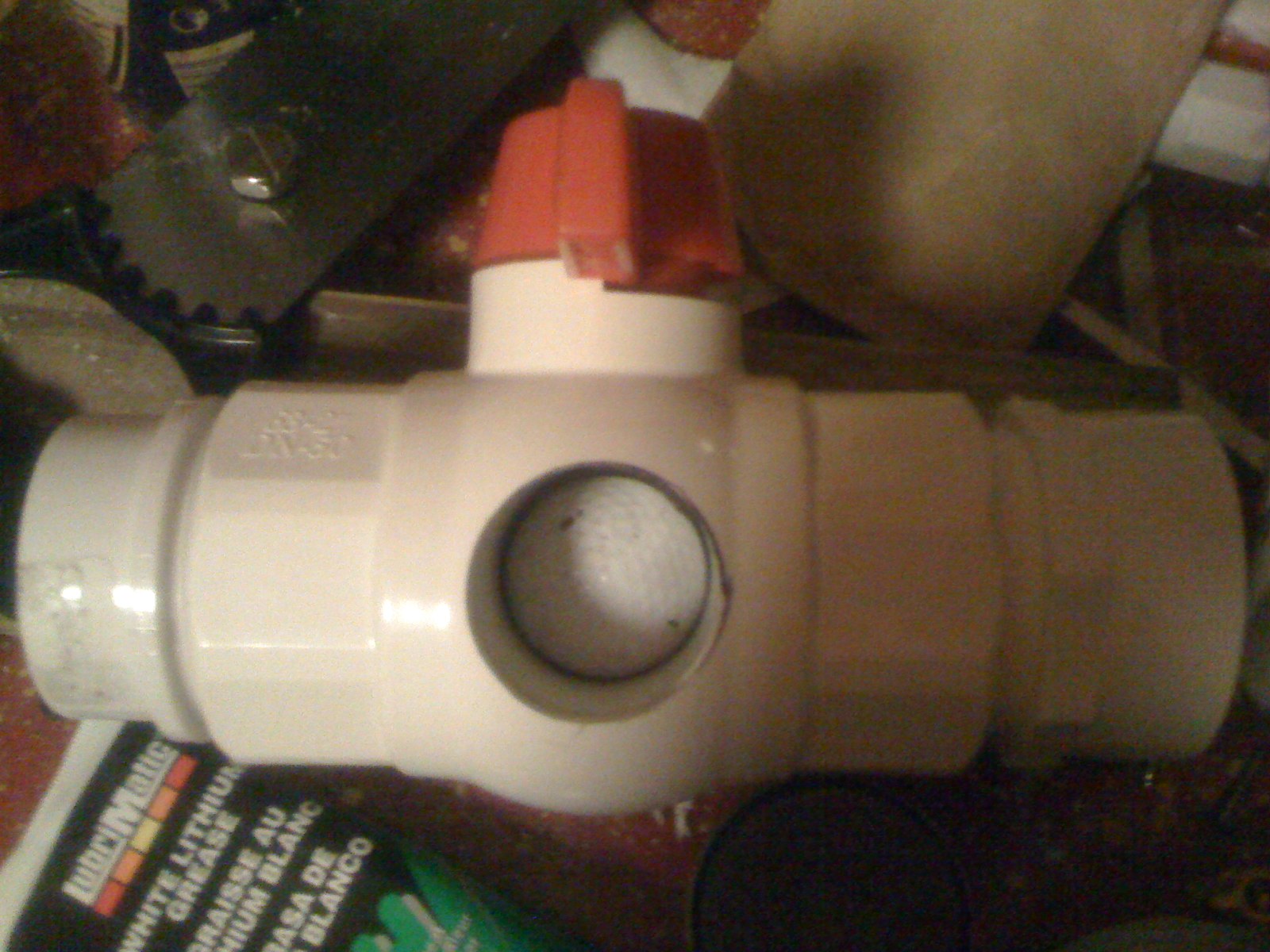

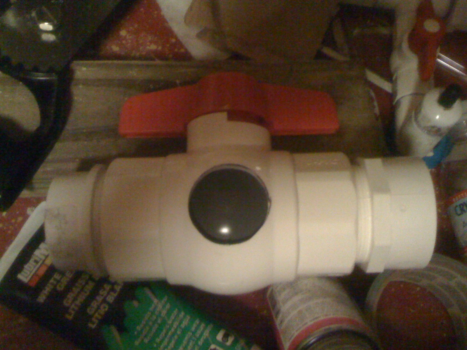

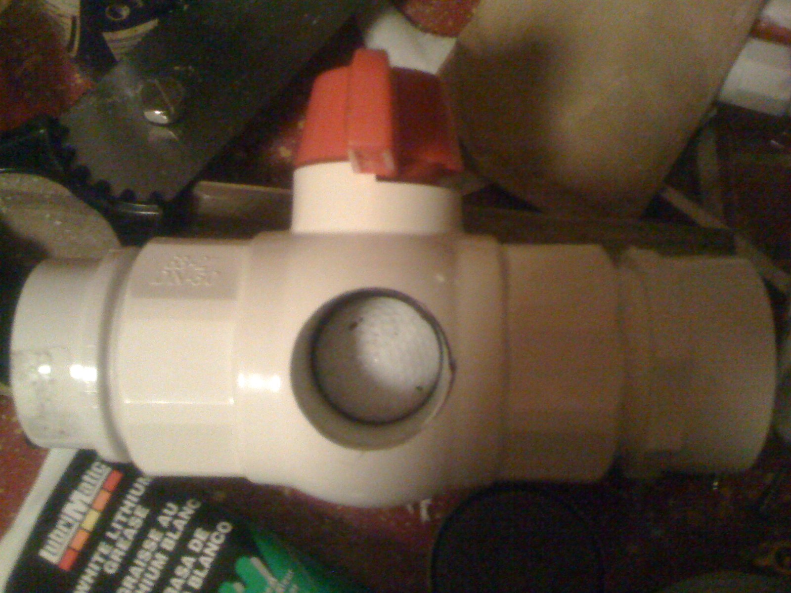

took some pictures of the valve, ill add them

Nice job lining up the golfball hole with the valve hole...looks perfect from the picture. Did you use a forstner bit and a drill press to drill it?

i used something like a forstner, its ancient though not as spiffy as they are now. but it was a tad small, widened it a little with a dremel
havnt got a drill press though, had to just do it by hand. marked a dot in the center by eye and drilled a pilot, got lucky i guess.
EDIT: looked it up, called a holesaw lol, i actually think its the same one as in the picture on wikipedia
