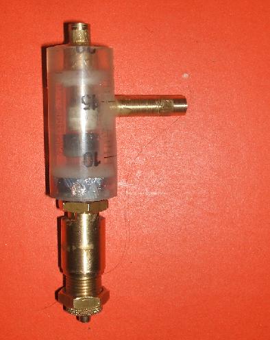

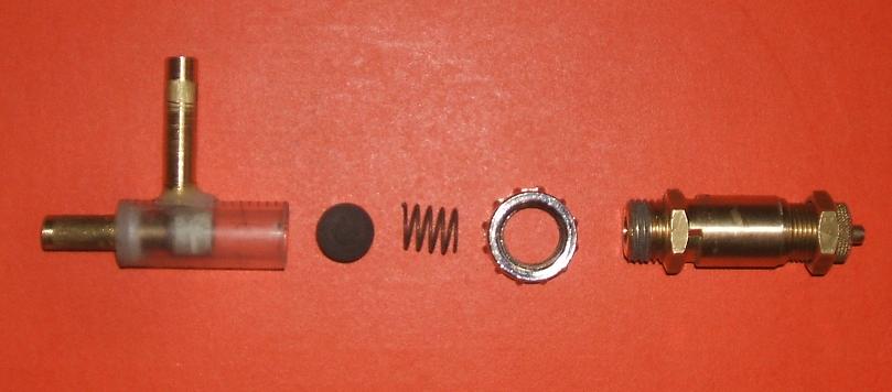

Just a heads up, I'm giving this concept another go, this time with an adjustable pop-off valve as a pilot. I found a female threaded section that fits the valve perfect, so it will be removable and allow me to adjust piston spring tension. The vertical brass tube will be connected to an air chamber (which in turn will be connected to an air supply) while the horizontal tube will feed into an as yet undecided reloading mechanism.
You also might recognise the breech and piston as being recycled from the failed marker project - to avoid the same fate as the latter, all will be comprehensively encased in epoxy

I'm quite confident it will, the pop-off pilot formula is a proven one, indeed my first prototype functioned in this manner. The advantage here is that not only do I have fine control over the pop-off pressure, but also I can make sure there's enough tension in the piston spring for the chamber to fill without exhausting through the "barrel" while also allowing the piston move when the pop-off actuates.ALIHISGREAT wrote:i hope it works, you deserve some sucess from your many efforts
I'm hoping for a much more powerful blast of air that will give me the confidence to turn it into a properly completed mag-fed auto launcher, and a more relibable firing cycle than I got using just the pop-off.

Nothing original, I know, but I had to give it a go.Brian the brain wrote:It's all starting to look familiar now..THe set up that is..not the actual parts.
This is one of the reasons why I'm confident, 1/4" pop-off pilot when I usually get great results with just a schraderThe pop-off is quite big compared to the main valve, wich should give you very good results...
I gave it a quick go and it sounded extremely angry and promising, but started to leak so there'll be a bit longer to wait for full test results I'm afraid.
Update - no luck
tweak as I might I just couldn't get the valve to pop. It either leaks slowly or seals completely. I'm guessing it's because a valve this size needs a bit of volume to force it open and in this case, the tiny pilot volume worked against me.
Bach to the drawing board, bigger piston this time.
