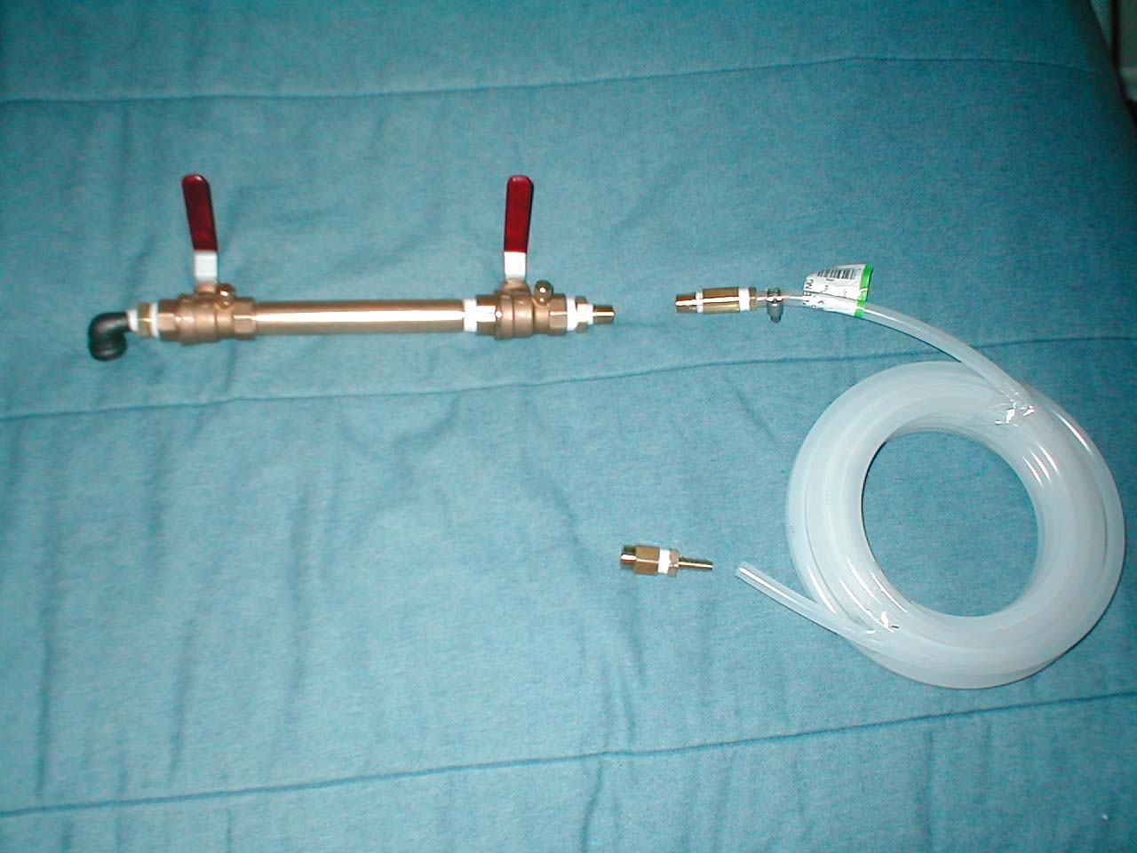

Can someone look over my propane meter to make sure its good
Mihlrad
Posts: 467
Joined: Tue May 23, 2006 6:45 pm
I just assembled my first propane meter, it is missing a couple parts are the moment until i get to a plumbing supply store, home depo doesnt carry tap and die or regulators, the order of parts for the meter is
1. propane torch head not yet cut or threaded
2. 1/8 " to 1/4" female female bushing
3. 1/4 " male to 1/4" barb
4. Polyethylene tubing 3/8 outside diameter 1/4 inside. i think the box said it was rated at 200 someodd psi i hope it wasnt in the wrong box. But its pretty thick so i imagine its right.
5. 1/4" male to 1/4" barb
6. 1/4" to 1/4 " nipple
7. 1/4" to 1/4" adapter
8. Regulator not yet bought (i really hope it has a 1/4 female thread when i buy it)
9. 1/4" to 1/4" nipple
10. 1/4" to 1/2" bushing
11. 1/2" Ball valve
12. 6" L 1/2" W meter pipe/nipple
13. 1/2" Ball valve
14. 1/4" to 1/2" bushing
15. 1/4" male to 1/4" female 90 degree street elbow
16. 1/4" to 1/4" nipple
Note all fittings are teflon coated, 5 layers and tight as hell. (probably need a vise to get them apart without ripping my palms off)
I just want to make sure everything is safely put together and is correct before i start rigging it to a gun.
Thanks.

Nice, Polyethylene should be rated to about 300psi so your fine... Looks great...
Good thing you didn't get Vinyl tubing, that's only rated to about 55psi
You probably could have made it for cheaper, but it's a pain in the ass looking for all the parts, sorry if my directions to make it were shitty from ealier :D...

Mihlrad wrote: 8. Regulator not yet bought (i really hope it has a 1/4 female thread when i buy it)
Yes, regulators have 1/4" femele thread. :wink:

Well not ALL regulators have 1/4" ports, but most do. The only reason I say anything is that I would hate for you to buy one only to find out it's a 3/8" or something.

On the 90* that goes in to your chamber is that a femal elbow? If it is you need a male one. Nice work

it has a 1/4 inch to 1/4 inch nipple that goes into the female end, its a male one end female other end, with the nipple its male on both ends.

Ahhh that hose is not pressure rated. it is for low pressure only. check the lable. get some air compressor hose. it is $10 for a 50 foot roll of the orange stuff. the hose you have will burst

... you sure? the box for it said like 255 psi...its pretty strong stuff too... its hard as hell to push over a barb... i mean it seems as strong as macroline.
