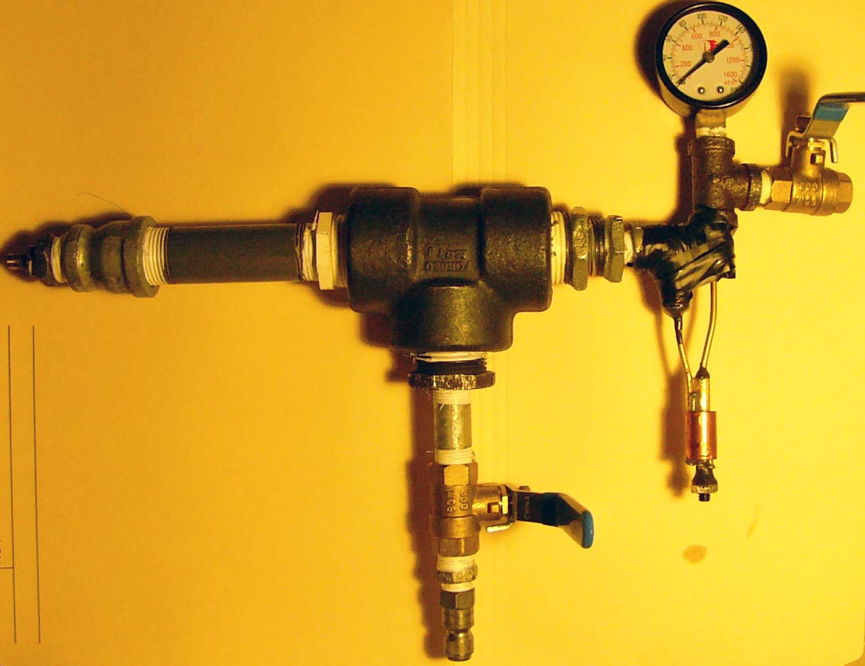

Delayed due to work and epoxy failing when I was trying to thread stuff together. I reinforced it this time by putting a piece of copper pipe around it and epoxying in place.
Results were mixed. At first nothing happened, it just stayed open. Then I realized I had forgotten to lube the piston before epoxying it closed. Doh! Note to self, make v.2 serviceable.
Managed to get it moving by putting oil in by the spring and the low pressure side. Then switching the schrader filler to the low pressure side and running air backwards I was able to cycle it till it was moving freely.
Filling through the low pressure side with no spring, it would pop closed at 30 psi when pressurized quickly and somewhere between 50-60 psi when pressurized slowly.
Which means that the spring won't have enough strength to return the piston. I could use a stronger spring and run a higher pressure but that would require redesigning the hybrid to handle the higher mix
The good news is that it doesn't leak at all, the o-rings are sealing perfectly!
When I switched the inlet back to the high pressure side I couldn't get it to work because my bike pump is leaking like crazy, and the greater volume didn't allow the pressure to get high enough. I'll update when I have a new pressure source.
Anyway, here's a picture of the test rig. It's a frankenstein of a previous fueling setup not completely disassembled. And the electrical tape is structural
