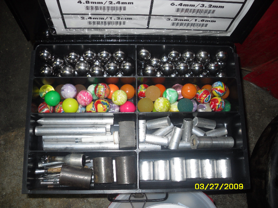

my organizer of .50" and .40" ammo...
my organizer of 1" ammo...

And nice organizers...hopefully we'll get to see some damage with those ball bearings. :wink:

Great creation you got there...but the ammo boxes are what makes this post really cool :o
