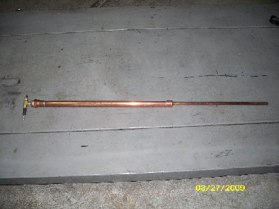

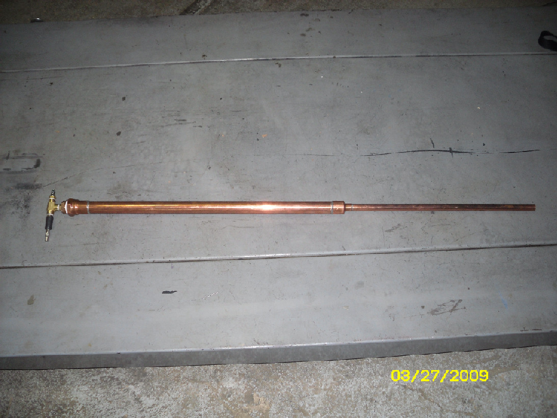

I mentioned it in another thread, but I'll give more details here...
It's a working gun but not a completed project, yet...
It's a 40.5"x .5" barrel, 23"x1" chambered coax, I have fired it at up to 180psi and was wondering what you guys think max safe o.p. would be( I do value your opinions)....
The piston is a 1"x13/16"x1.25" rubber stopper, large end towards barrel, button head 5mm bolt going thru the center with nylock nut on the pilot side(the bolt and nut are just to expand it slightly for a snug fit), and a coil spring to keep it seated when not pressurized(credit to jsr), the pilot valve is a scrader with a modified cap and a pushbutton for firing...
It will fire with less than 5 psi ...
This gun will be inserted into a walking cane blank, and I'll be makeing a handle for it that will allow hidden access for filling and firing...
I'll post pic's og the working gun later today, and hopefully this weekend will get the cane part pinished...
Pics Now...My First Copper...Soon to be walking cane gun ...

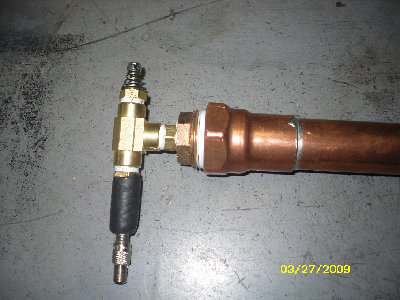

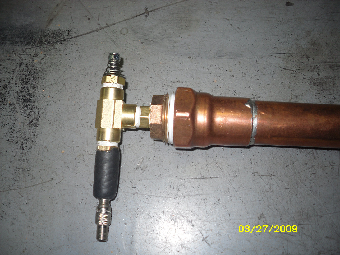

Type L... solder/thread adapter on pilot end, 1" to .5" reducer(solder/solder) on barrel end, brass 1"to.25" bushing for pilot, brass .25" close nipple to .25" tee, fill schrade on one leg, fire schrader on other....Carlman wrote:what type of copper is it made out of...

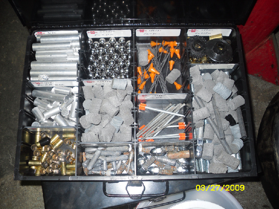

Looks great I can't wait to see it with the wood. How do you plan on concealing the pilot/fill end? Making a handle around it could be tough.

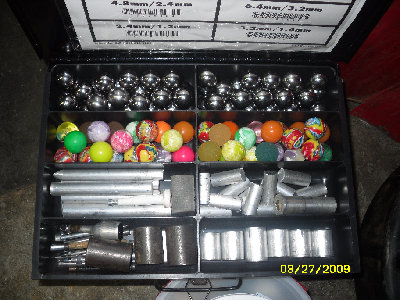

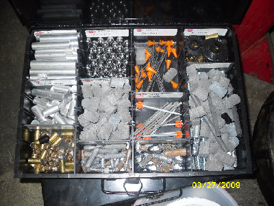

And nice organizers...hopefully we'll get to see some damage with those ball bearings.
REAL Damage will have to wait until I get some hpa, it does great with light projectiles, but the bearings REALLY need 400+psi to do impressive damage...daberno123 wrote:Looks great I can't wait to see it with the wood. How do you plan on concealing the pilot/fill end? Making a handle around it could be tough.
the handle will make JSR proud, it'll be made out of epoxy, with a vented black rubber button cover over the button, and I'm thinking about making the fill side so that I can use 12g co2 with a screwin piercing adapter for full stealth mode... use the little grey sabots in the box in front and behind the bearing(they are really tight), and then, if the occasion arises to ventilate something, screw in the co2 cartridge to fill and push the button to fire... Slick, huh?
12g co2 will fill this chamber ONCE to 643psi or thereabouts... {edited to remove possible connotations} So , one good shot should be all thats needed..
