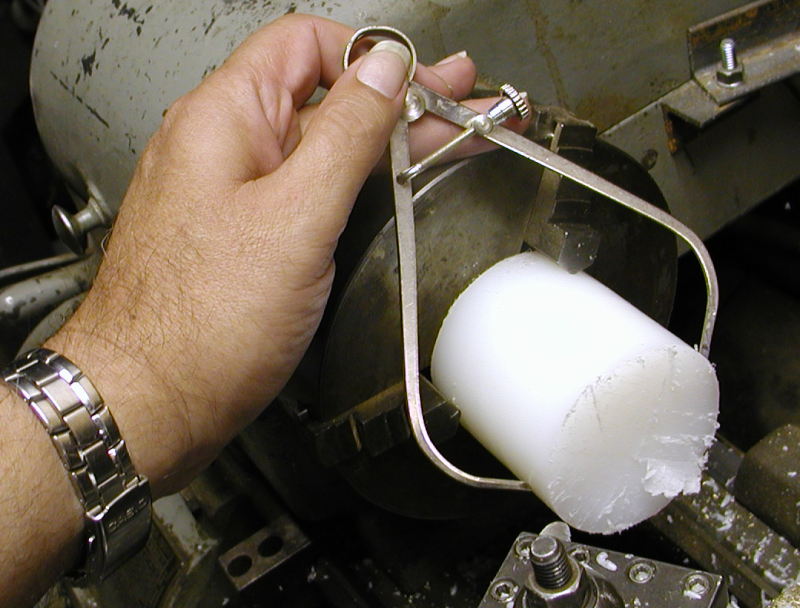

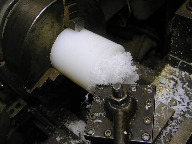

@Jagerbond.. Nice lathe. It is big enough to do engine blocks. My dad's is configured to make production bolts, screws, flanges, etc. It is much smaller. If my memory is correct it has a 8 inch swing, 36 inch bed and just over an inch through the headstock.
Instead of a regular tailstock, it has a 6 position turrent so repetitive operations can be rapidly repeated. I'll post a photo when I'm at home on the other computer. As a thread cutting lathe, it has the compound gearing, six belt selectable speeds (2 on motor and 3 on the jackshaft) and a full gearbox selector for carriage advance speed/threads/inch. Included is a set of gears to switch to metric.
For excentric jobs such as cams, he has the 4 jaw chuck.
I asked him what he paid for it. Man has inflation run up prices. He bought it used in 1961 for $300.
Edit; Added photos of lathe and 4 jaw chuck. This one is either 8 or 10 inch swing (I don't remember) and has a 1 inch through bore.
