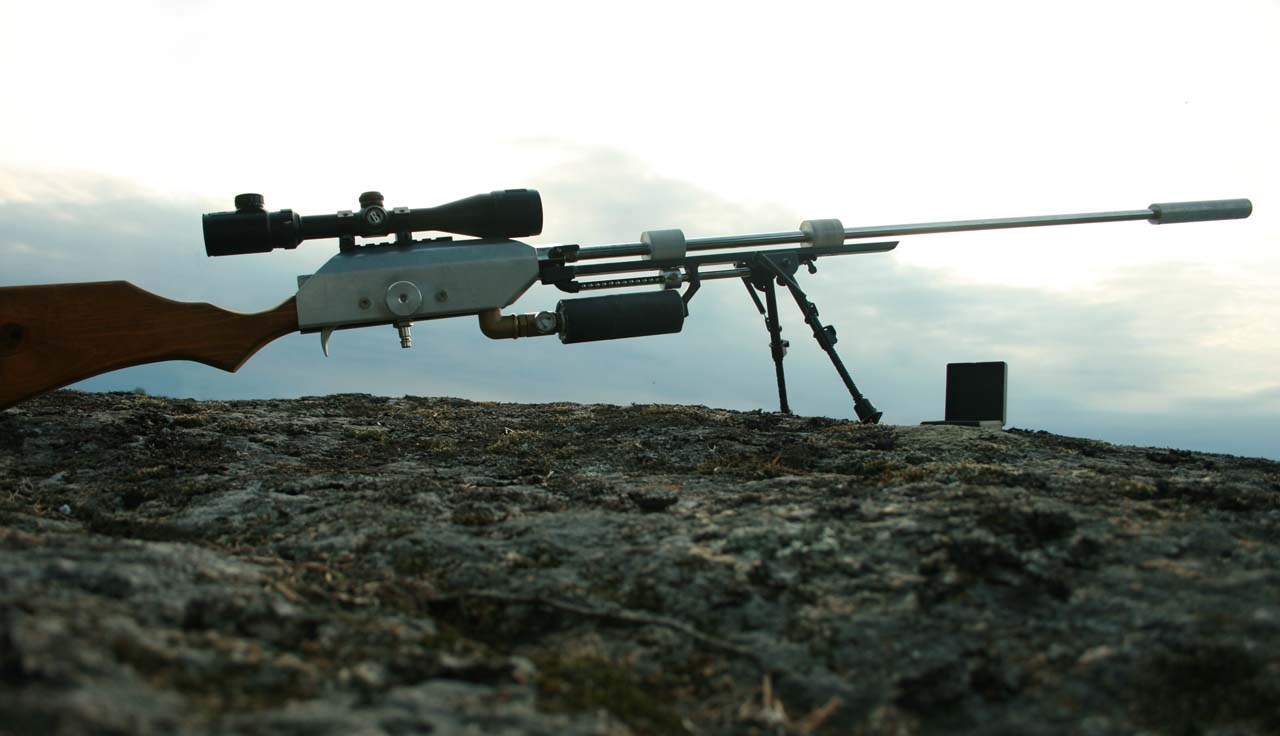

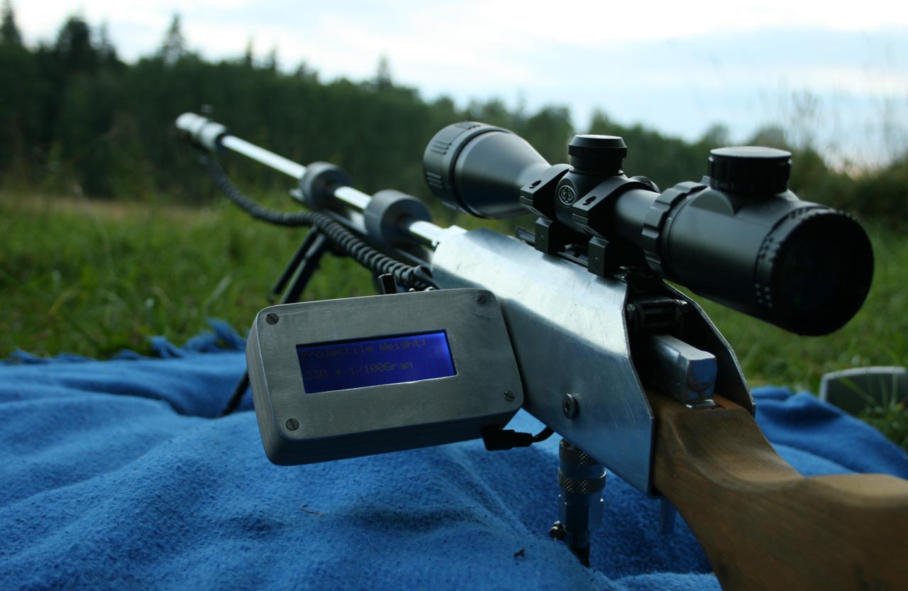

This is The Challenger, my contribution to this contest. Built on a basic QEV concept, with a couple of add-ons. The parts are self-supporting with a steel frame made of square piping in the middle. A wood stock makes it comfortable to shoot with. The bi-pods are fold-able and the pipe can be detached to make it easy to move. It’s fairly lightweight considering the size of the gun. Shooting from standing position is possible even though I prefer to lie down.
The whole assembly, except for the bi-pods and sight, are hand crafted. I’ve used simple tools as hacksaw, knife and power drill, But for the gun support and other complex parts I’ve used heavy machinery such as lathe and mill. I've put very many working hours into this project which I hope you’ll notice and enjoy!

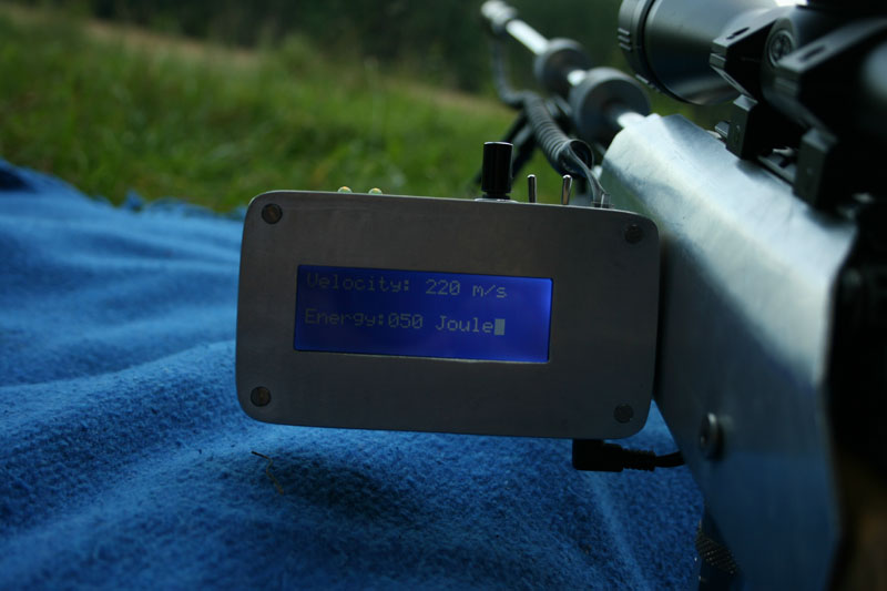

On board Chronograph
The chronograph started as a side project were I first had to learn how to program a microcomputer and having it perform the task of reading sensors and present the info on a display. It ended up being an on board velocity measuring unit. The limitation of the speed measure is not yet known but the microprocessor can measure microseconds (0.000001 seconds) and should do the Ir sensor the weakest link. The Ir sensor itself needs 15microseconds to register a bullet. So with 8mm ammo the highest theoretical speed would be 533m/s (1748 fps).
This is a really handy tool when it comes to developing the gun and to actually see the changes of an improvement is great. The sensor unit mounted on the silencer is in the final prototype stage and will very soon be replaced by a better looking one. I might also add some more functions such as shoot counter, Highest/Averaging-value, presenting fps at the same time.

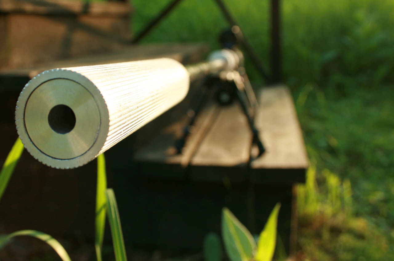

Other than the on-board chronograph and maybe the detent system, I see nothing new on this launcher.

I really like rifle configurations and this is no different. In fact, it is a very beautiful piece. Also considering the builder used no special tools for construction, this is one fine piece of work.

Idea: 15 on board crony works for me.
Use of materials: 5 it's put together well.
Creativeness: 8 the on board crony don't make the entire cannon.

Great idea with the on board chrony, loading system is a nice touch.

The chrony is a great touch but it hardly has anything to do with the performance of the launcher and could've been made as a seperate item.

Cannon itself isn't very inventive, but the idea and implementation of the on-board chrony is excellent.

Again the on-board crony earns it some points

Idea - 10 - Would love to see more electronics rat nesting themselves from concept. Does seem there was more to be had though.

Creativeness - 10 - Like the one off feel to it all. Chrono screen adds a cool element. Only next a range finder/ scope that adjusts for drop in trajectory. Or a circular laser that is fitted around the barrel that would project an approximate area for common bullet spread, also accounting for trajectory and distance. What can I say? Electronics with guns :-)

Pretty good design with the loading system and chrony.

-Idea: 10; The loading system is good, onboard chronograph is nice but in reality most have this has been done.

-Creativeness: 7; the onboard chonograph and other features are excellent.

-Function: 9; could be improved with an onboard HPA system, onboard pump or CO2 tank. But that's a personal preference really. The chronies proximity to the muzzle may give overly generous readings.

-Idea: 5 - Harsh? maybe. Id rather have an external chrono that can be used for multiple guns. Rest is pretty standard.

-Creativeness: 3 - Chrono doesnt get it there itself

Man this one looks very nicely built!!!
And good shooter.
Safety incorporated in design is innovative itself! 8)
