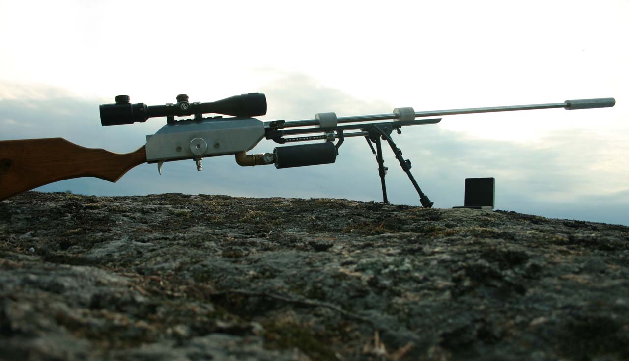

--Details and pictures from cannon builder--

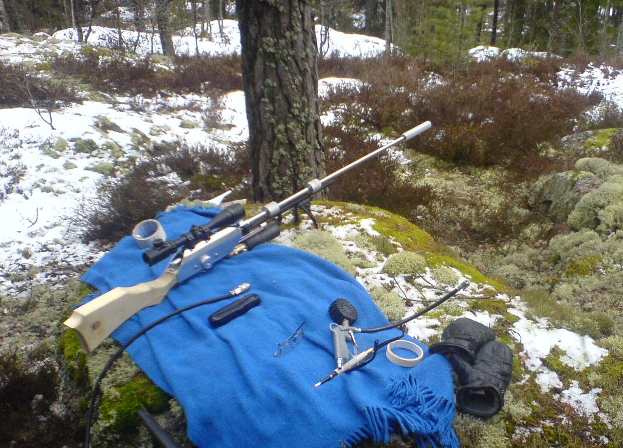

Specs

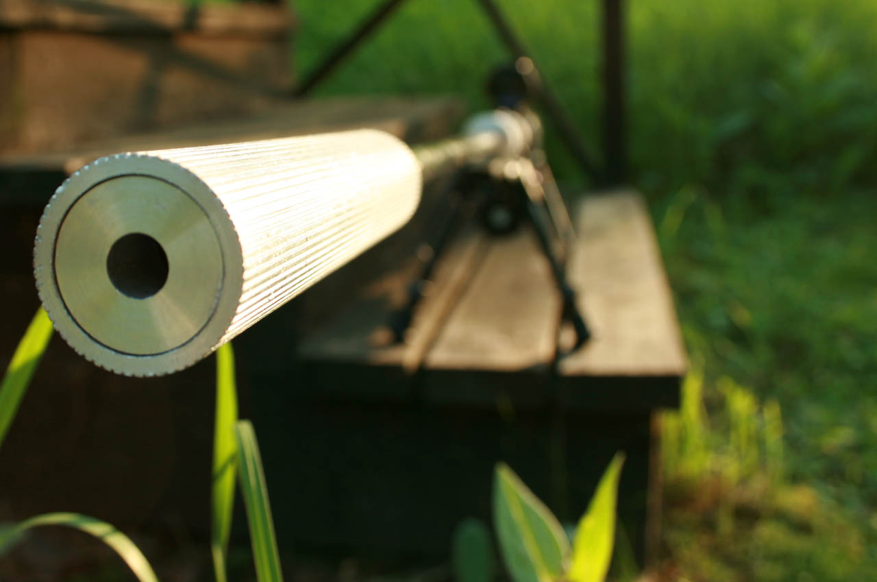

-Barrel length: 1.0m
-Barrel diameter: 8.0mm hydraulic steel pipe
-Ammo: 8mm (7.96mm) steel bearings
-Mag capacity: 13 rounds
-Release valve: QEV
-Pilot valve: ported blow gun
-Fill Valve: ball valve
-Chamber volume: ~0.2liter
-Pressure: 14bar(203psi)
-Pressure source: bike pump

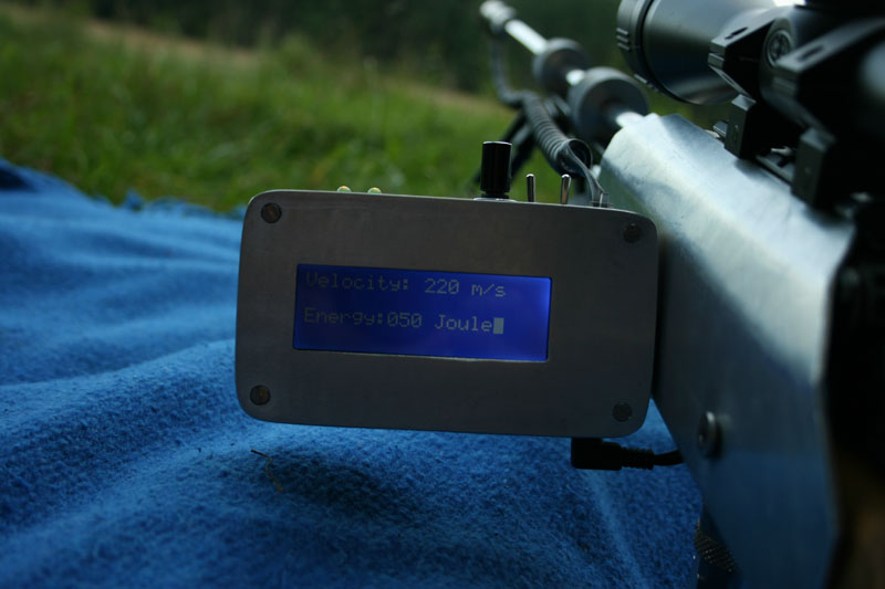

-Velocity: 220m/s = 50 joule of kinetic energy (at 14bar(203psi))
-Optics: Bushnell Trophy 3-9x40 (red/green sight)
-Other: Adjustable Bi-pod

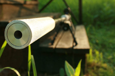

This is The Challenger, my contribution to this contest. Built on a basic QEV concept, with a couple of add-ons. The parts are self-supporting with a steel frame made of square piping in the middle. A wood stock makes it comfortable to shoot with. The bi-pods are fold-able and the pipe can be detached to make it easy to move. It’s fairly lightweight considering the size of the gun. Shooting from standing position is possible even though I prefer to lie down.
The whole assembly, except for the bi-pods and sight, are hand crafted. I’ve used simple tools as hacksaw, knife and power drill, But for the gun support and other complex parts I’ve used heavy machinery such as lathe and mill. I've put very many working hours into this project which I hope you’ll notice and enjoy!

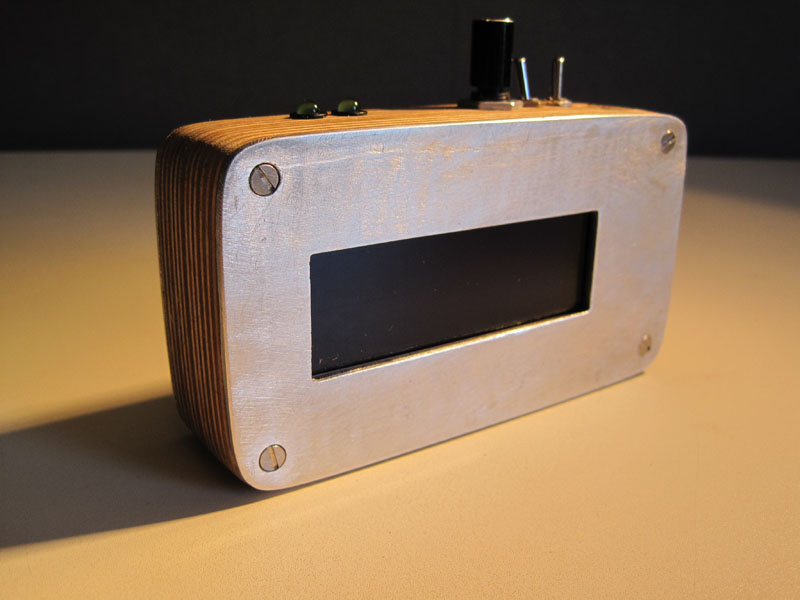

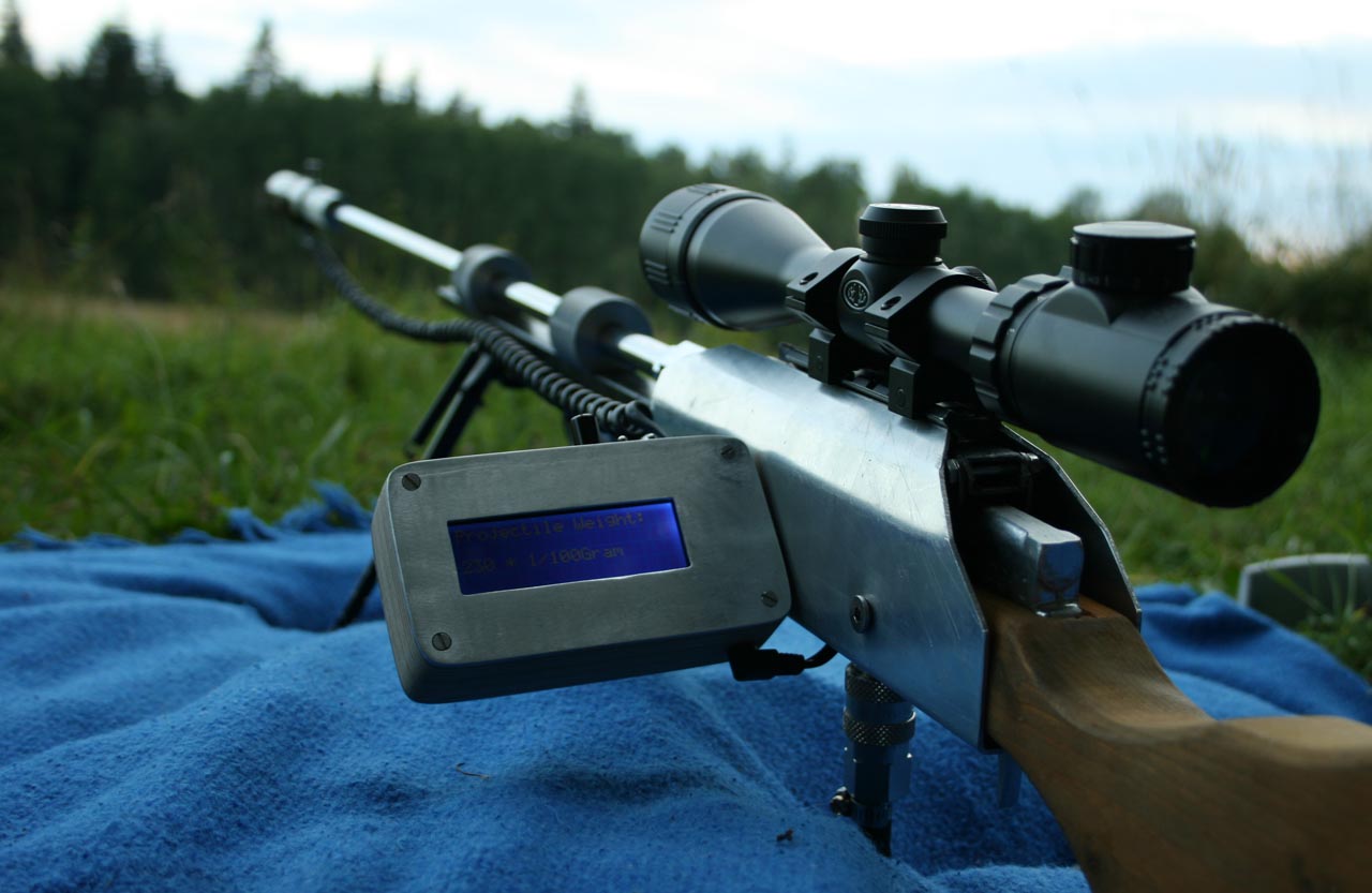

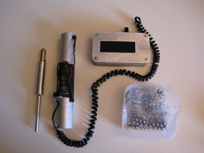

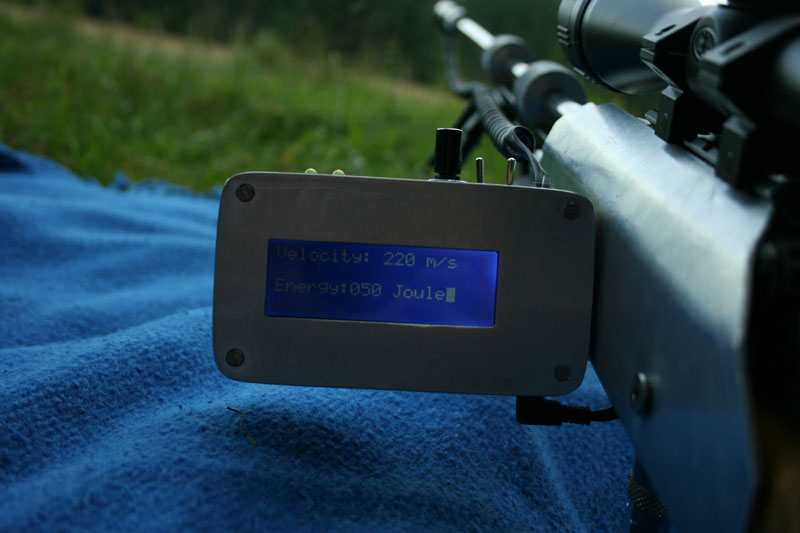

On board Chronograph
The chronograph started as a side project were I first had to learn how to program a microcomputer and having it perform the task of reading sensors and present the info on a display. It ended up being an on board velocity measuring unit. The limitation of the speed measure is not yet known but the microprocessor can measure microseconds (0.000001 seconds) and should do the Ir sensor the weakest link. The Ir sensor itself needs 15microseconds to register a bullet. So with 8mm ammo the highest theoretical speed would be 533m/s (1748 fps).
This is a really handy tool when it comes to developing the gun and to actually see the changes of an improvement is great. The sensor unit mounted on the silencer is in the final prototype stage and will very soon be replaced by a better looking one. I might also add some more functions such as shoot counter, Highest/Averaging-value, presenting fps at the same time.
Loading, safety and bullet holder
The ball valve mounted in front of the QEV is used for three purposes. The first is to load a single bullet at the time from the 13 round magazine. The second is that in closed position, it completely blocks the barrel, to prevent the gun from going of in the wrong time. The third function of the valve is to let pressure build up behind the bullet, before the bullet enters the barrel. This is caused by small tolerances in the custom bullet holder, housed inside the steel ball of the valve. While turning the ball valve from closed to firing position, the bullet is forced into place in the holder. This also makes it possible to aim at any height, without have the bullet dropping out of the barrel.

I really like rifle configurations and this is no different. In fact, it is a very beautiful piece. Also considering the builder used no special tools for construction, this is one fine piece of work.
Function - 10
The launcher appears to function as intended.
